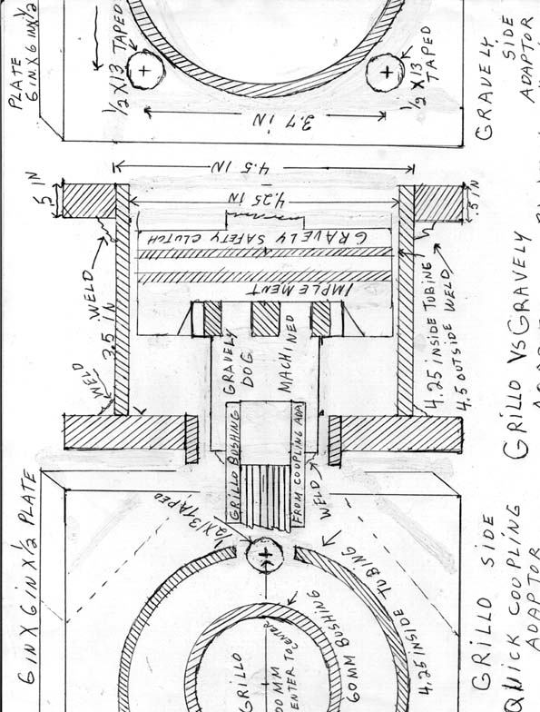

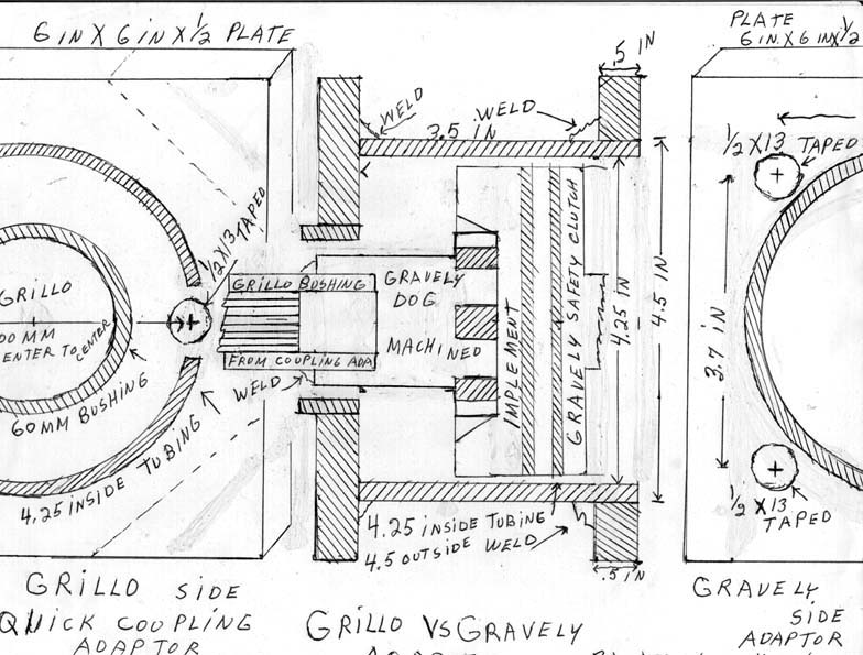

Hi! For help you. I plan use my Gravely implements as 30 in. rotary mower etc on My new Grillo 107D . Front PTO Rotation is the same as Gravely. I want start my adaptor from a GRILLO Quick coupling for good clutch alignement. But I Think my Plan design can help you for make BCS adaptor. I join a Pic. Thank and Good luck! Oldmech

Hi ! Excuse me For the pic. The 12 MM Studs on GRILLO Pto flange are 100 mm Center to center I dont know for BCS. Thanks and Good luck Oldmech.
