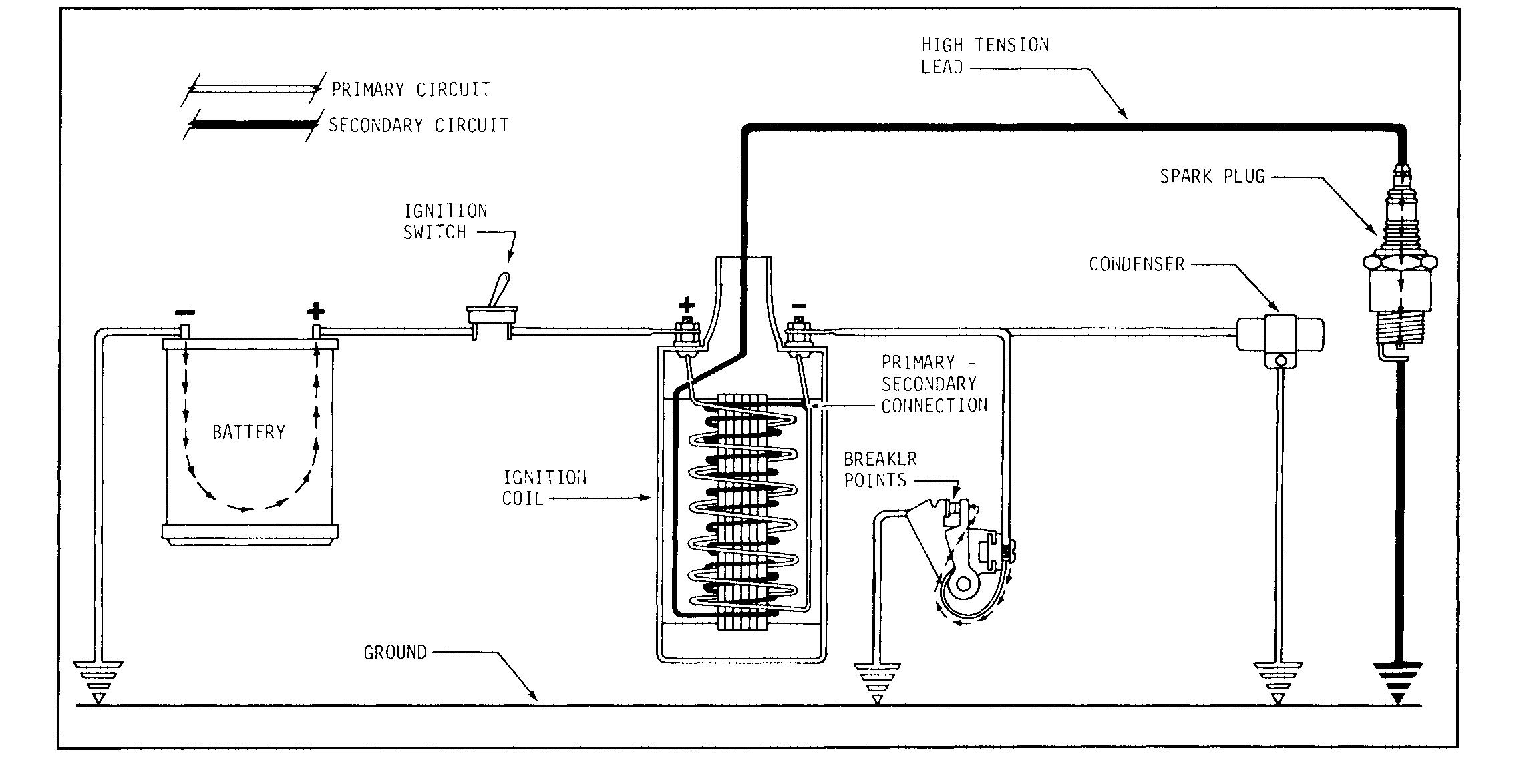

Sorry I wasn't clear. It's the ignition switch that is not OEM. I will check the diode as you suggested. But one more thing I found, is that, with the key in the on position, there is fire to BOTH sides of the ignition coil (+ and-) and no fire from the coil to the spark plug. So, I guess I should start with that. Unless you think there's something else that could cause it. As for the short that was causing my fuse to blow, I discovered that by disconnecting the wire that comes out of the flywheel housing to the coil, it doesn't blow the fuse. But as soon as I touch the coil post with that wire, the fuse blows. Is that the stator wire?
Thanks
/ Gravely 5265 short in ignition..... #9
The wire that coming from the flywheel housing is the stator wire. What has likely happened is the diode buried in the stator wiring has shorted. Adding a diode in series with the stator lead should fix it. If you are unfamiliar with diodes, then taking a pair of 1kv 3 amp diodes and connecting them so that the banded end is connected to +12 volts should fix that without a lot of grief. If you really want to fix it by the book, buy a new stator.
The fact that you are seeing +12 volts on both sides of the coil means that the points are open. If you were to rotate the crankshaft, you would find that at some point the "-" terminal will have 0 volts on it. This is normal.
I've turned the motor over quite a bit, both by starter and by hand and both the + and - posts on the coil stay hot. I will try the diodes and let you know. Once again, I really appreciate your help in trying to get this figured out.
/ Gravely 5265 short in ignition..... #11
Well, if the - side never goes to ground it will never generate spark. It certainly isn't the source of your short.
You can run your tractor without the stator being connected even if the diode was good. It just won't charge the battery.
This may help.
