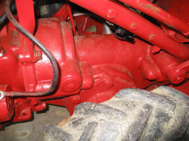

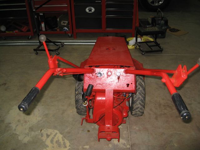

It does not appear I have the SwiftAMatic transmission but I do have a "hole" in the dash for it so I am a little confused and thinking maybe the model number is wrong. It seems that it could be added or maybe the rod is missing? Could it have been an optional item maybe? Here are a few photos - I know nothing about this machine and am trying to find about it every way possible so any info is a BIG help!

The great thing about these machines is most stuff swaps around (my Com12 has a Pro14 H/L planetary in it). 5260 should be a swiftmatic with an 8 hp e start Kohler. A 5220 would be an e start 8 hp Kohler without the swiftmatic, I have never seen a 5220 so I dont know if someone swapped tin or just changed decals on you. I cant tell from the pics but if the ends of the axle housings have 2 holes through them the gear reduction units should bolt up as I can see you have the tapered and keyed axles.
Heres some sales info for the series,
http://gravelymanuals.com/pdf/Conv_5xxx_Broch_0378.pdf
The swiftmatic is the most versatile trans as you can change speeds with no more effort than moving a lever, a non swiftmatic is stronger but to change gearing requires lots of effort. Im not sure if you have an 8 lead diff or a 6 lead (likely a 6) they did put a 4 lead in the old L model to slow things down again Im not sure one would work in yours and they are hard to find. Easiest/cheapest would be to locate a swiftmatic and swap it in, then you would have speeds from 1 mph to 4 mph.
