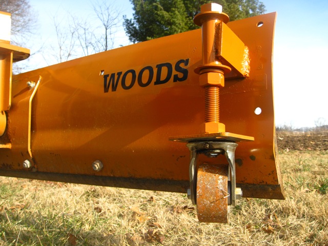

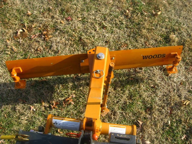

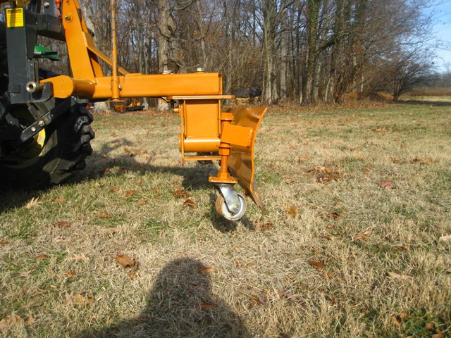

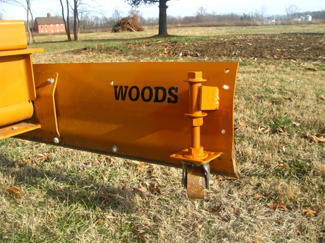

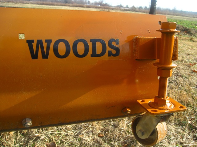

Are we tired of seeing gauge wheel builds yet??? I hope not because here's my version of this TBN classic. :D
Materials:
  • 3" x 5" x 3/8" angle iron
  • 1-1/4" schedule 40 galvanized pipe
  • 1" threaded rod
  • 700 lb steel casters
I welded a 1" nut & washer to the caster mounting flange.
The 1" nut on top is welded directly to the pipe. The 1" nut on bottom is loosened to make adjustments to the height.
With the wheels adjusted all the way down, the blade stays about 1.5" above the surface. This is to keep my gravel in the drive when plowing snow.
With the wheels adjusted all the way up, the blade will take about a 2" bite. Probably more than enough for my needs.
WARNING: For my first attempt, I used 350 lb iron casters with solid rubber treads from Harbor Freight ($6 ea). These didn't last one trip down the drive before the rubber was gone and so were the hub bearings! :eek:
For my second attempt I used a set of 700 lb solid steel castors from TSC ($25 ea). Way more expensive but these have grease zirks for both the wheel hub and caster. After multiple trial runs up and down the drive, they are still holding up well. ;)
I'm happy to report that even with the short distance between blade and wheel, they do just fine for keeping the blade from digging in. My drive is now perfectly graded without a single ripple. :)
Cheers.

Nice work, like the fine adjustment feature.
Thanks.
In the gravel, the ability to make fine adjustments probably won't be noticed much. But I imagine that this could be helpful on a paved surface as it is much more consistent.

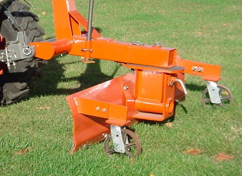

   / Gravel Saver / Guage Wheels - Rear Blade #5

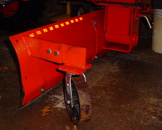

I sure like your adjustment scheme! You can see that I went with the close proximity bracket too but with 8 inch steel wheels. Seems stronger with less flex.
No doubt about it, wheels save the gravel.

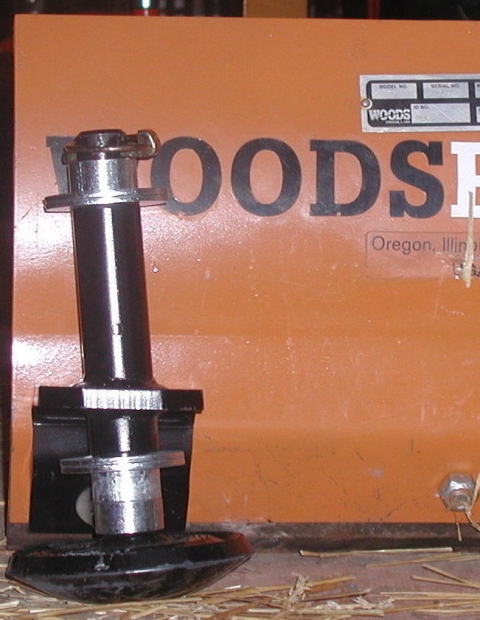

Well, you caught me, bigdad. :D
I actually used this pic that you posted some time ago as inspiration for my build.
A hybrid between yours and the OEM version that Woods sells. (This pic was originally posted by Nik) Thanks Nik.
It sure helps to have pics of how people do things with what they have on hand or what works for their situation.
Although trial and error can be fun sometimes, it tends to burn up a lot of time and money. Two things that are in short supply these days.
Keep those pics coming, no matter how mundane. You never know when you'll inspire someone to build just what they need. :cool:
