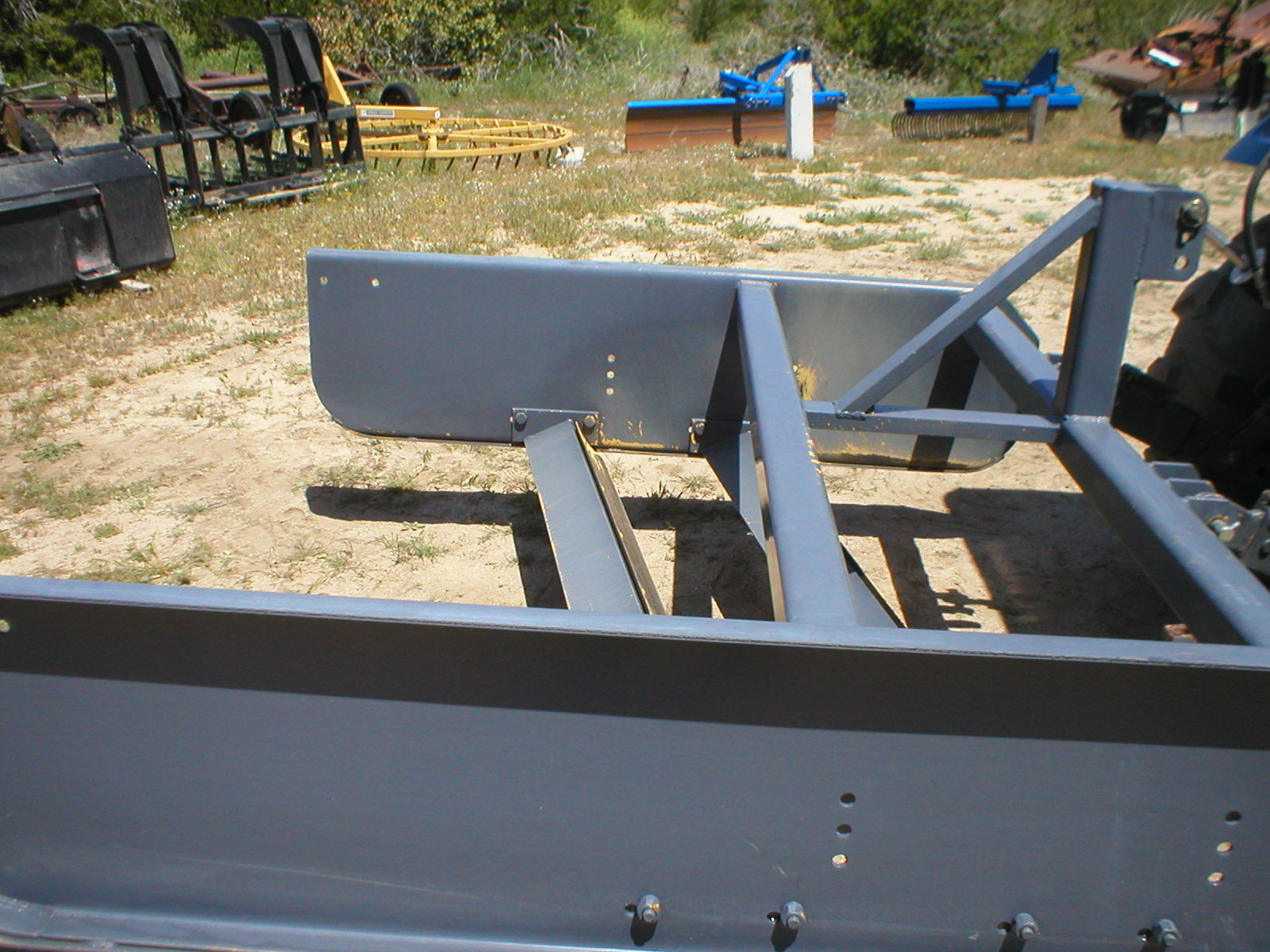

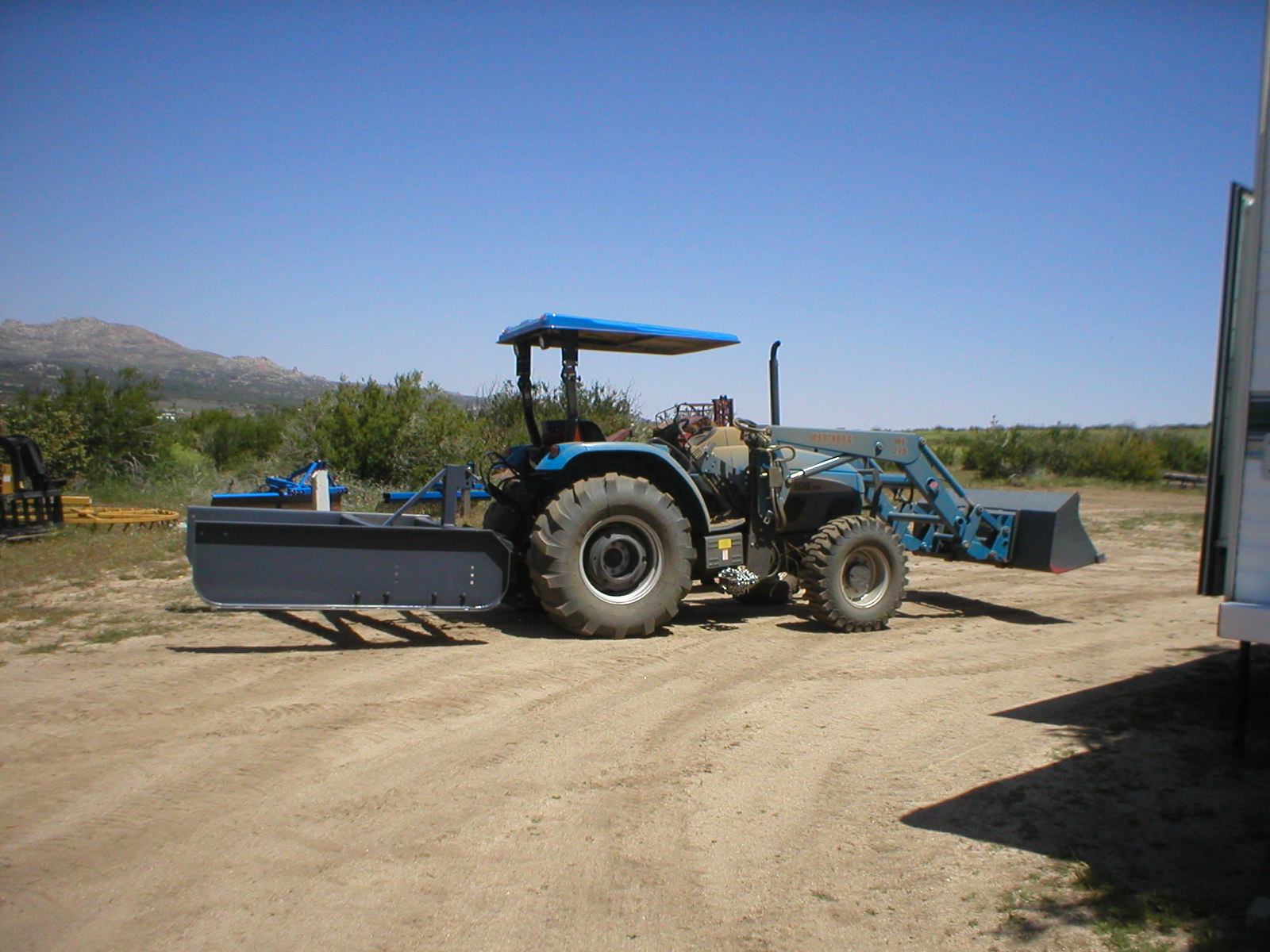

Nothing maintains a gravel road as easy and as well as a land plane grading scraper. Nothing.
Just IMO, the :2cents: that it may be worth. ;)
