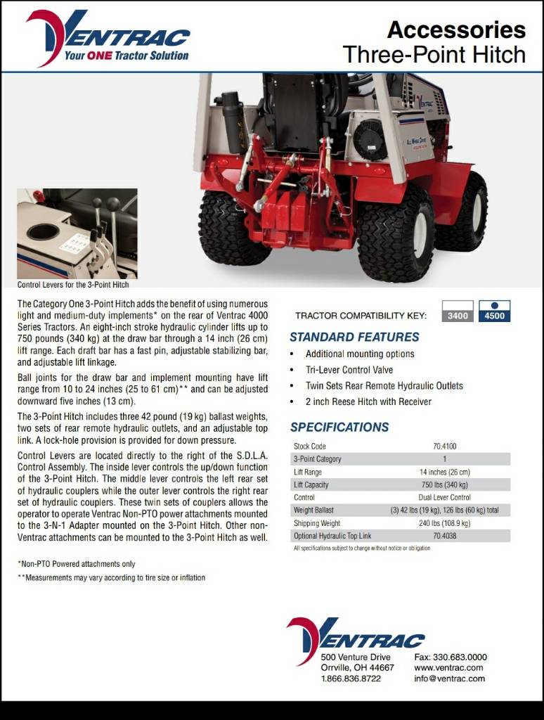

hello fellas, i have a 4500z with 3 point hitch and duel wheels and i would like to get a land leveler--grading scraper or whatever you call it so i can work on my gravel driveway. i was thinking about getting a box blade but i think this other attachment would do better for me. they make 4' and 5' widths do you think my tractor could lift and pull either one of these ? my driveway has one place with a 17 degree slope. thank you.
/ gravel driveway #2
Welcome to TBN and the forum. You are looking at a land plane grading scraper ( LPGS ). I'm sure your tractor would pull either a 4' or 5'. Would it lift either unit - - ???? None of the Ventrac sites list the lift ability of the optional 3-point system. What does your Owners Manual for the 3-point say? If nobody has an answer - call your dealer.

here's the spec sheet... says 750lbs lift capacity Screenshot_20201021-221041_Drive.jpg
