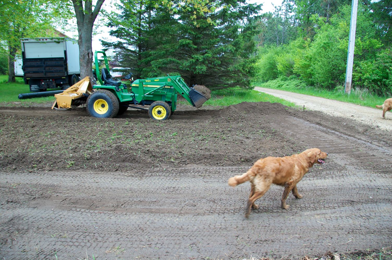

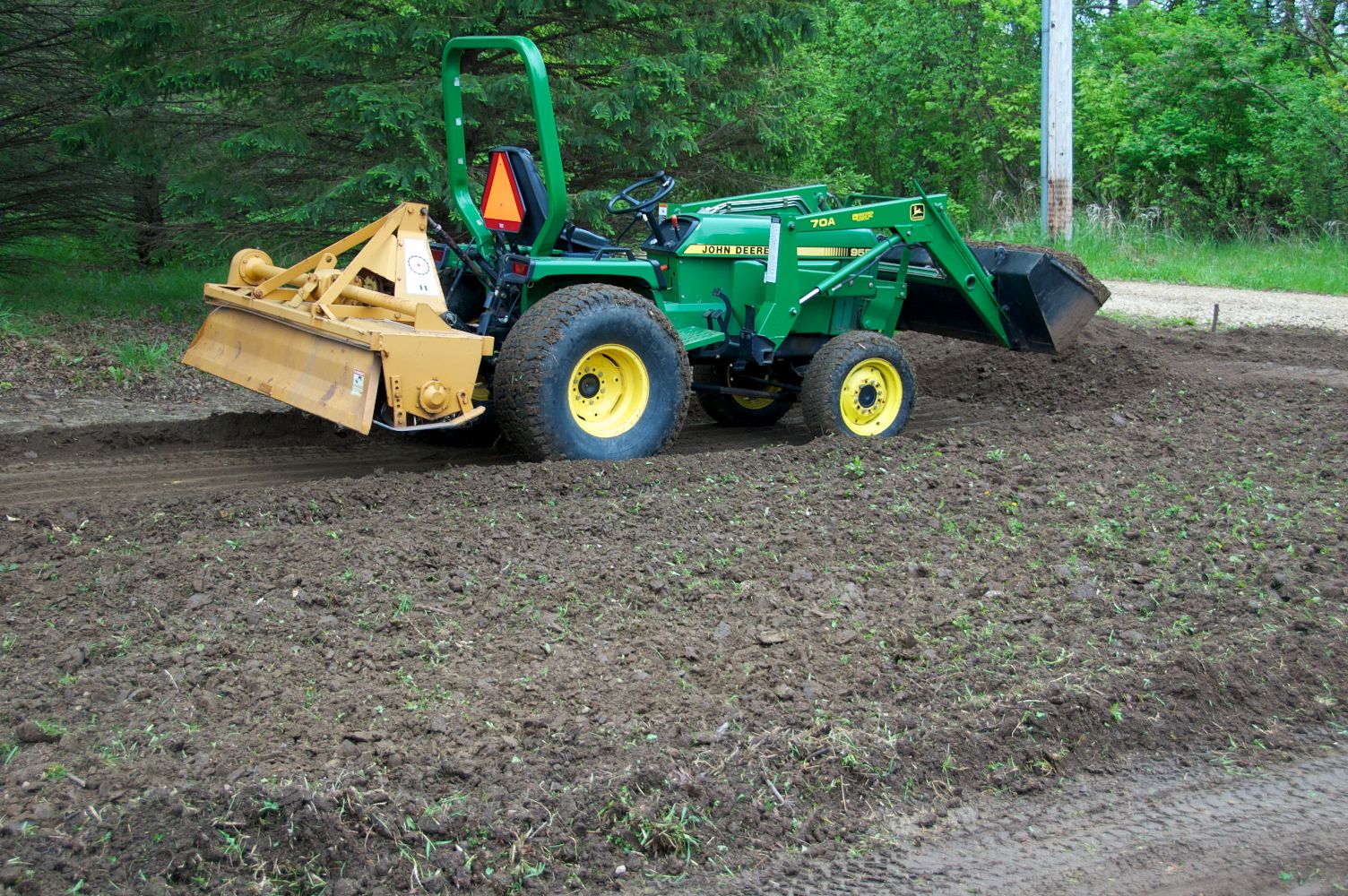

Hi all,
In preparing for a new pole building I've been working on getting some addtional driveway/park space built. I wanted it at the same elevation as my existing pavement and slab. So, I borrowed my neighbors rototiller to loose up the dirt that I want to excavate and have been using it on my JD 955 to haul out the dirt. This has been a lot of fun even though the weather hasn't been particularly cooperative. The space is 25' x 61' and I want to excavate about 10"-12". The local excavation guy says to use a larger rock fill on the bottom and about 6" of gravel on top of that. I have a roll of US 200 geotextile fabric to install under all of that.
These are some before pics

You only have the before pics? We need to see the process and end-results! :)
Sounds like you have the right plan - excavate off the top soil, geo-textile fabric, big rocks, smaller rocks. That's the blue print, near as I can tell, for long-lasting, quality gravel driveways and parking areas. Amazing how many people just toss down more pea stone and get bummed when it turns to muck.
Nice pups!

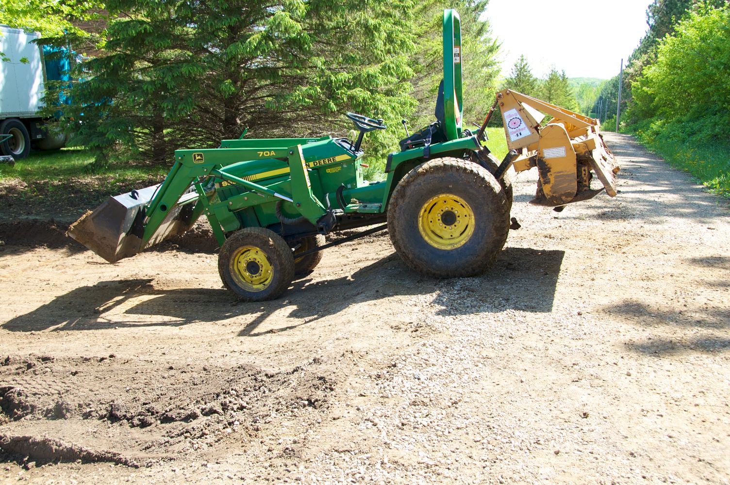

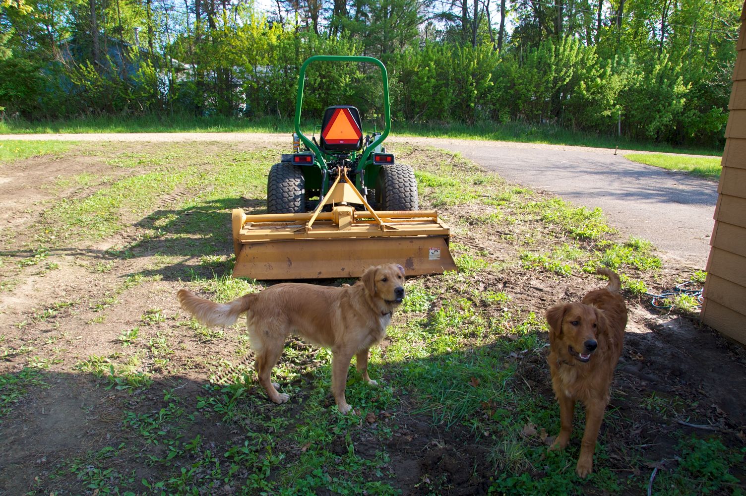

Yes, I have more. I got started posting this morning as I was waiting for the gravel truck to arrive.
These are from the first tilling to take out. It's been wet on and off here so keeping at it has been difficult.
The dogs are very fun. They're about 8 and 9 months old now. They loved playing in the mud. :)

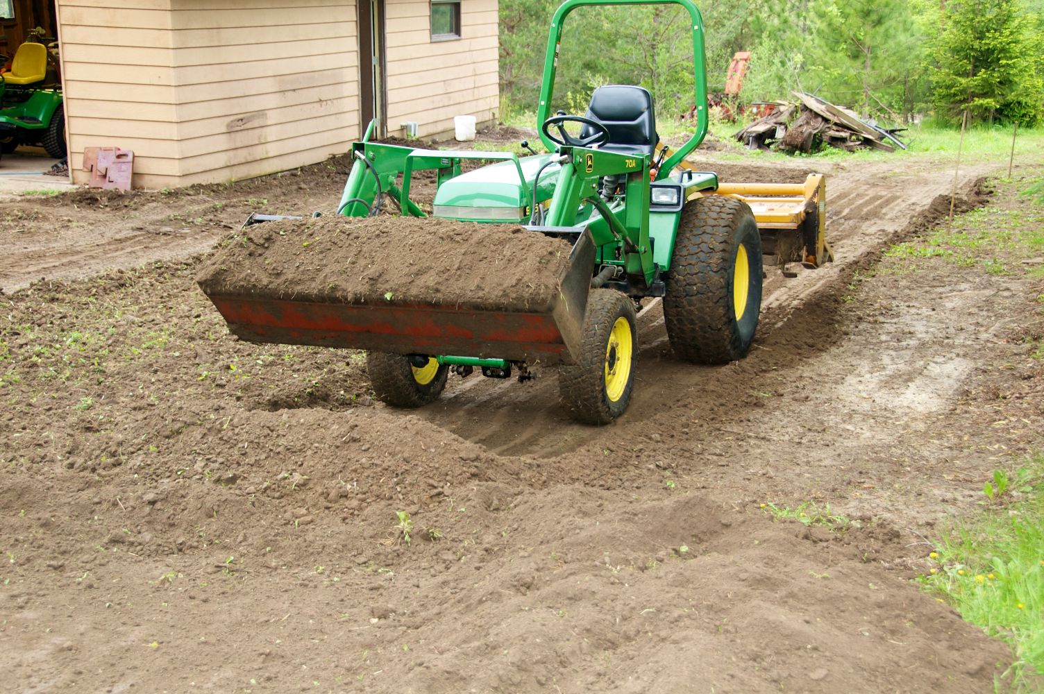

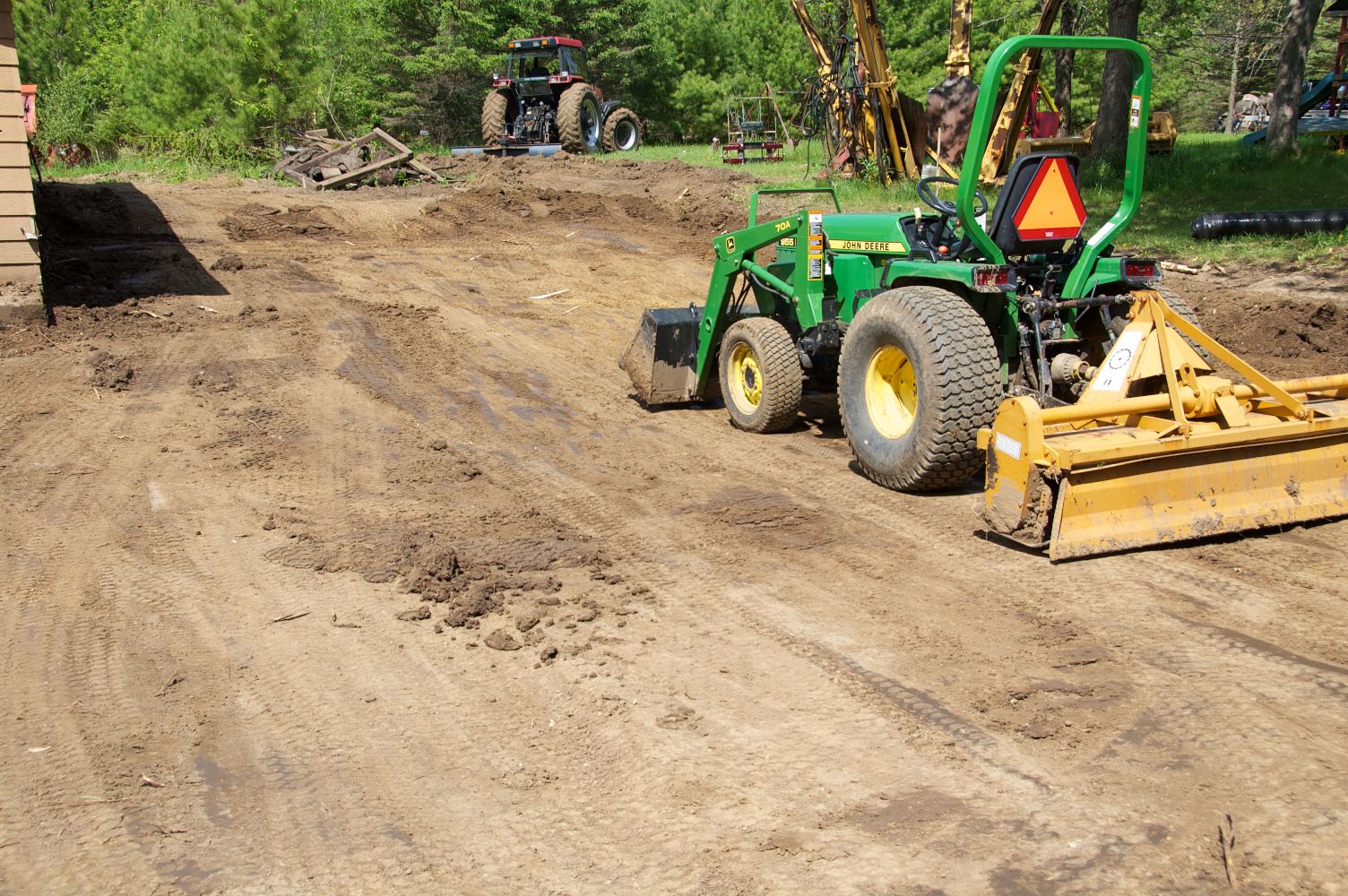

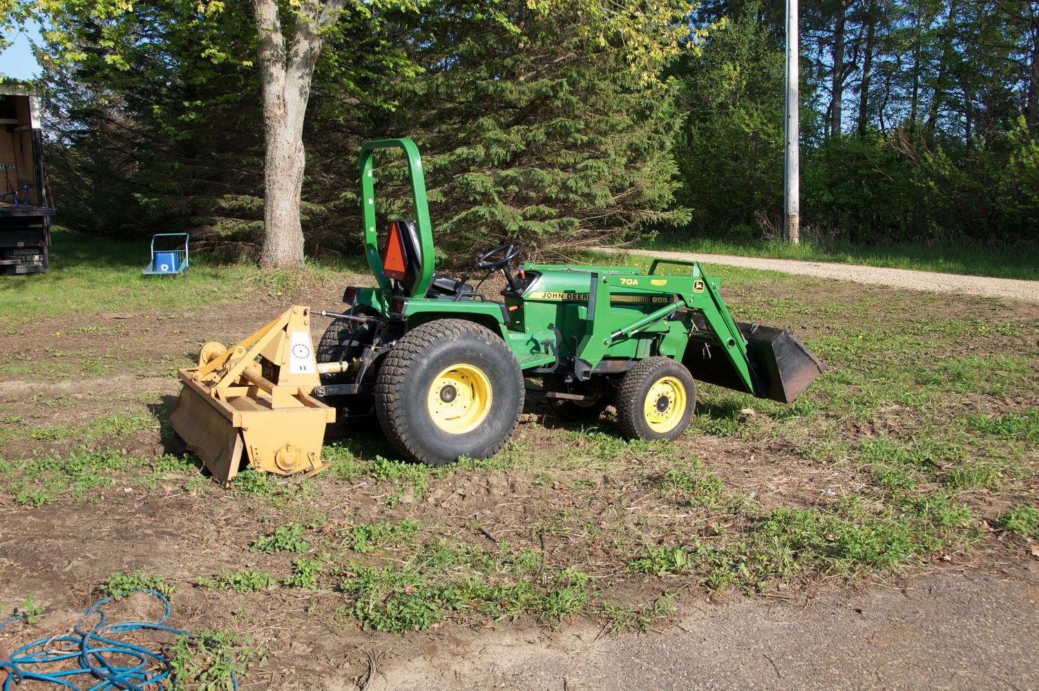

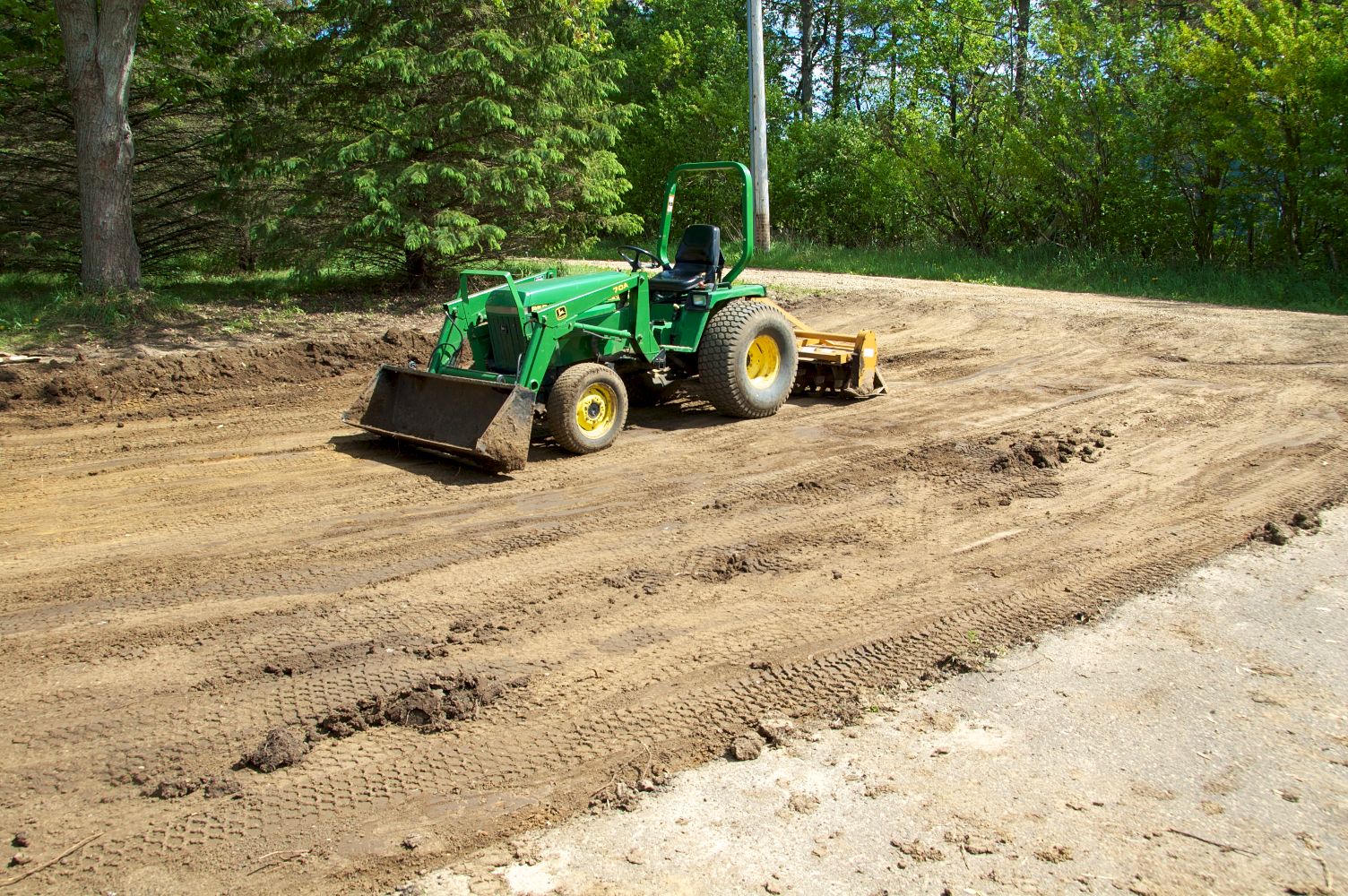

These are of the final excavation before putting down the fabric. The first pic is a great example of how handy 4wd is when using these little CUTs. Backing out of an angle like that with a load of dirt wouldn't have been possible with 2wd. That 955 is an impressive tractor.

Nice. What is that monster machine in the background I spy?

It's a Case IH 5140. It was a bit of an overkill, impulsive purchase. Most I use it for plowing snow. It sure is a nice machine though.
I really like the 955. It's a nimble little chassis and has a good amount of power.
