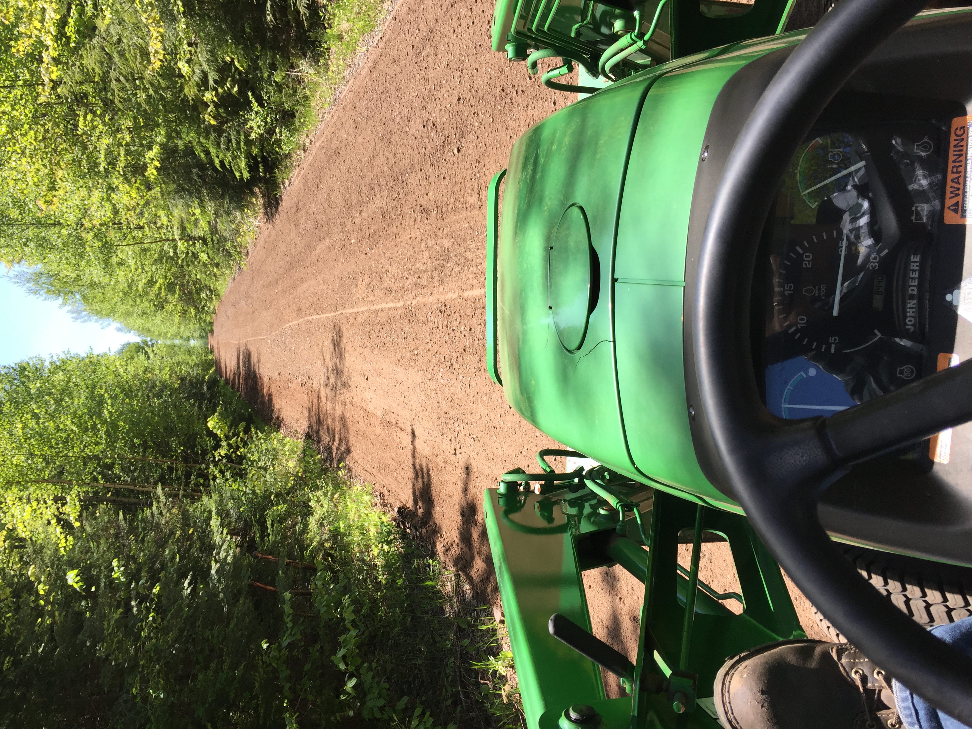

There's no one way, nor best way to maintain your gravel driveway so maybe we can all share our methods here.
I just finished my spring driveway work. Over the years, I've developed a method that works pretty well for me. I have about 750 feet of crushed concrete drive. It's not built perfectly so I get some potholes over the winter. I like to wait for a day where the ground has plenty of moisture still, but not much standing water. I use a landscape rake and set my 3PH for lateral float (where mine normally is set). I angle the rake but make sure it's still level side-to-side (top link). Dragging forward, I start at one edge and pull towards the center. Out on one side and back on the other. I may repeat this a couple of times until I have some material built up in the center.
Once I have a nice windrow of gravel built up, I drag it all the way to one edge. Then I make repeated passes, working the windrow from one edge to the other. Today, I think I pulled it all the way across and back twice. The rake does a nice job of stirring up base material as it moves along so the loose material can incorporate. About 8 passes.
Once I think I have enough material distributed to fill the holes, I make one more pass each way with the rake angled towards the center. This gives me some material for a crown. Then I turn the rake around and pull it "backwards" (tractor moving forward) to smooth things out. A couple of passes angled towards the center then one final pass with the rake straight across and running right down the middle to smooth the crowned material. The rake is forgiving enough, if things aren't quite right, make a couple more passes.
Once the tractor work is done, I drive my truck over it all to pack it down. Today, I had two spots that were still a bit too wet and I suspect they will become holes again as the truck tires tended to push the material to the sides rather than pack it down. A bit more work as things dry out and it should be good.
So, that's my method. What does everyone else do? BTW, I have a rear blade and a box blade but I find the rake the easiest to get a nice surface.
