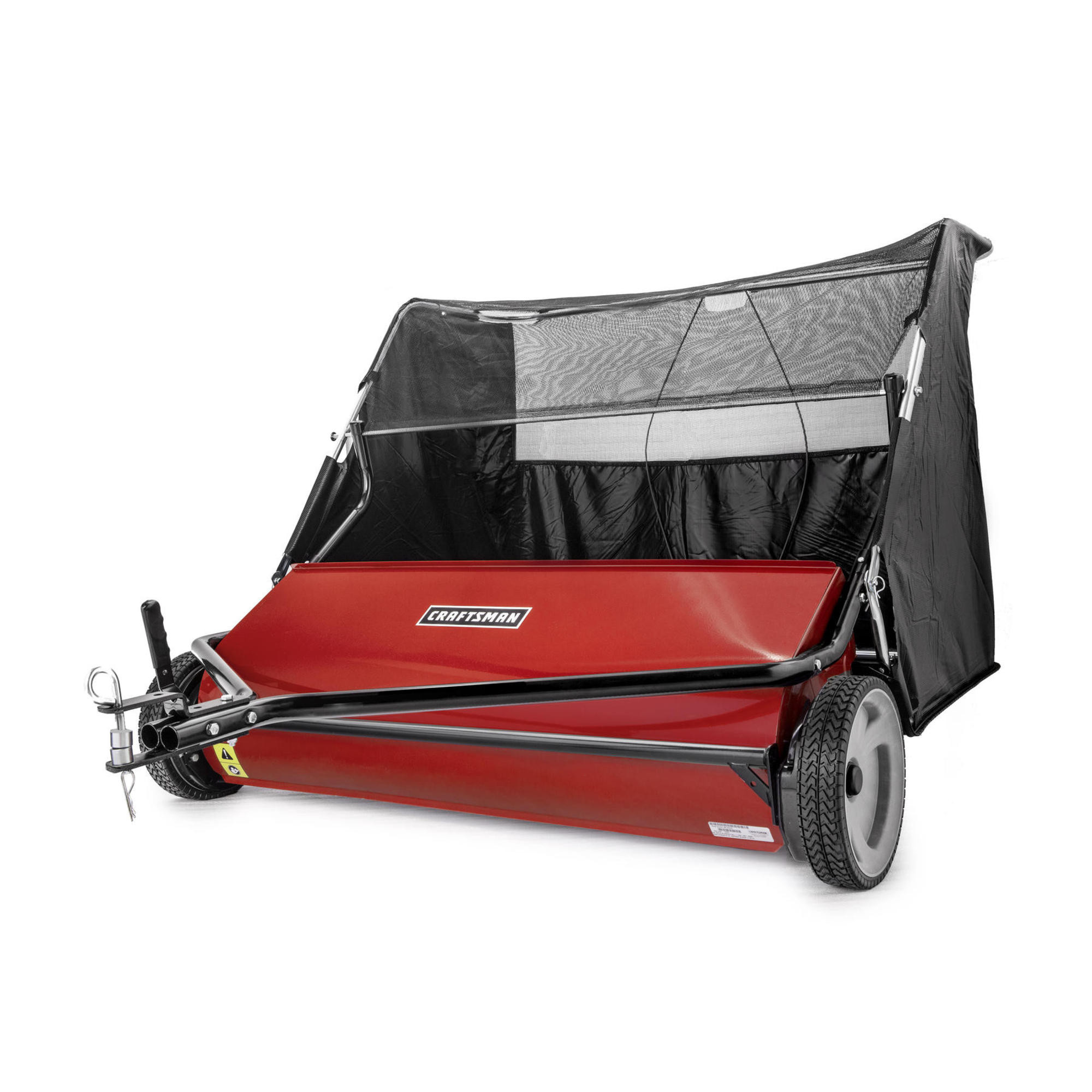

I have a old Grass Sweeper that is made for smaller tractors. The hitch on the B2650 is to high for it can someone point me to a height adjustable hitch? Here is a pic of the sweeper it is a craftsman.
Hitch might have to be length adjustable as well not sure if it will hit the tires.

You may be able to get a trailer mover to go low enough. If so then it opens the door to all the 2" receivers. The grass vac hitch should fit over the receiver without a ball installed.

Have you considered a draw bar on the 3 point? should be able to go lower than the hitch as well as move your hitch point back behind the tires. You can usually find them on ebay for around $50.00
