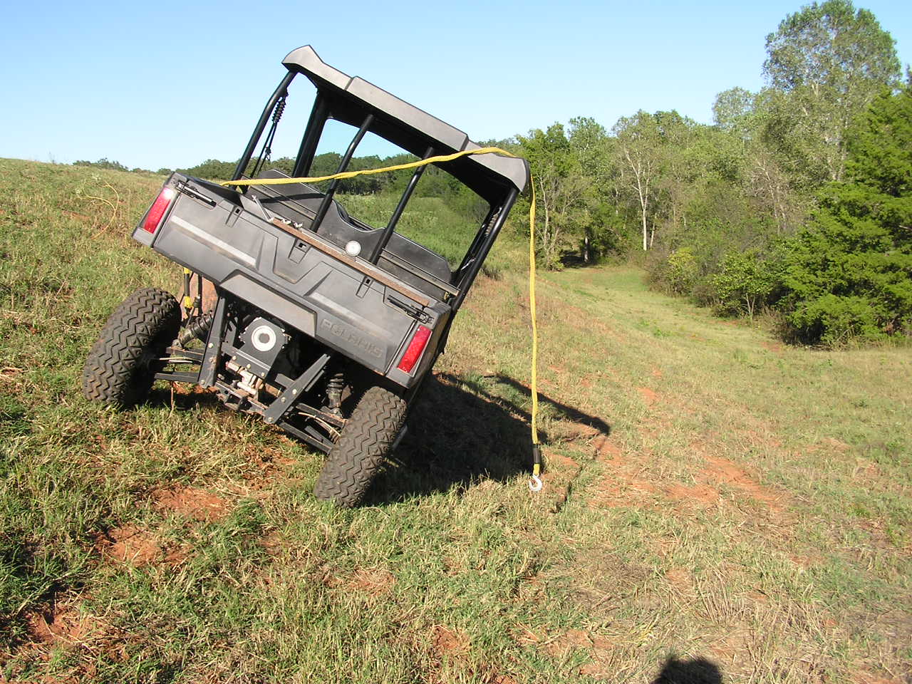

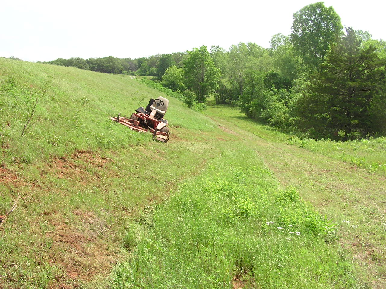

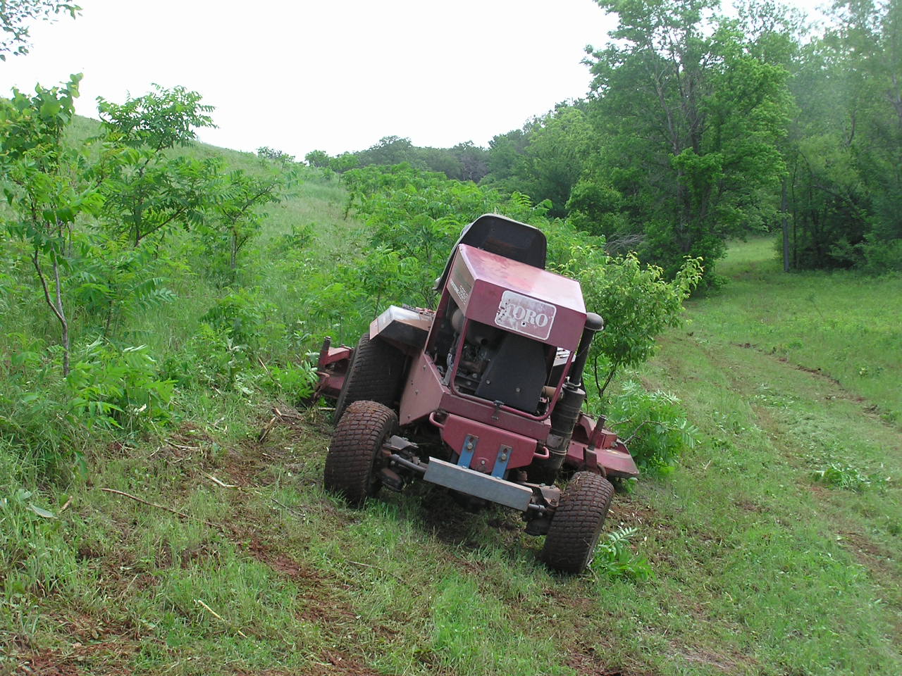

I mow sidehill with a used commercial 4WD TORO Groundsmaster 325D.

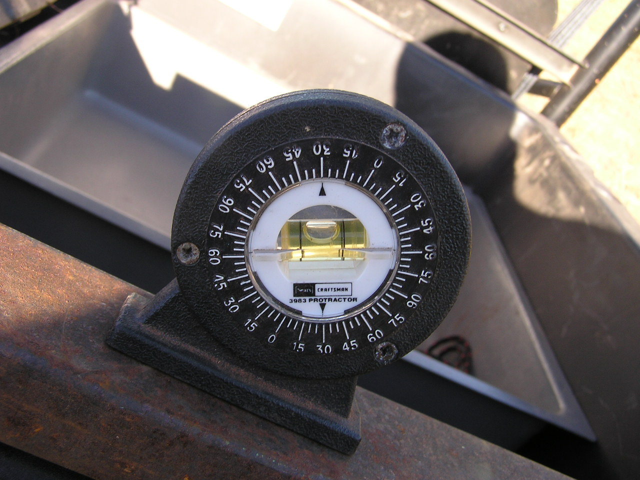

This is what 30 degrees of body lean on a 26.6 deree slope looks like.

How does the 325 do on those slopes? Looks like you are crabbing and tearing things up a bit.
It does better than I expected. It slides sideways a little and the ground was too wet that day.
With the 6' deck, I don't worry about a rollover. :thumbsup:
