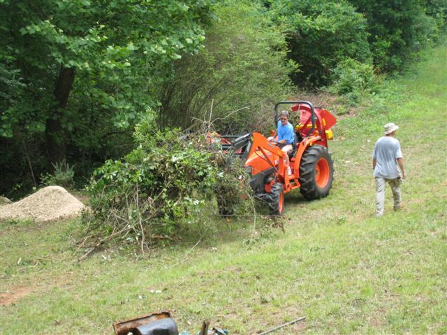

Understand what you are faced with. I'm up the road an hour from you (Forest City) doing much the same. Although I have not used a bucket add-on grapple, I can say I absolutely love my WR Long root rake grapple. I knew when I was shoping for the tractor I would be moving mountains of brush, ivy, black berry, stumps... so I went ahead and had the WR Long financed in with the tractor, loader, cutter, and box blade. While it does take time to change from bucket to grapple, especially since I do not have Quick Attach, I never cease to be amazed at how much junk I can pick up by coming down on a pile of brush and crunching it down a couple of times. Having the right tool for the job is a pleasure.
If I weren't currently in Iraq, I'd invite you up to play in some brush piles. If you are still in the looking/investigating stage in January, send me a PM and I'd be happy to let you get some first-hand experience.

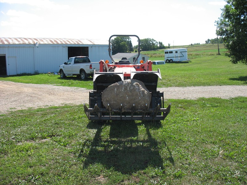

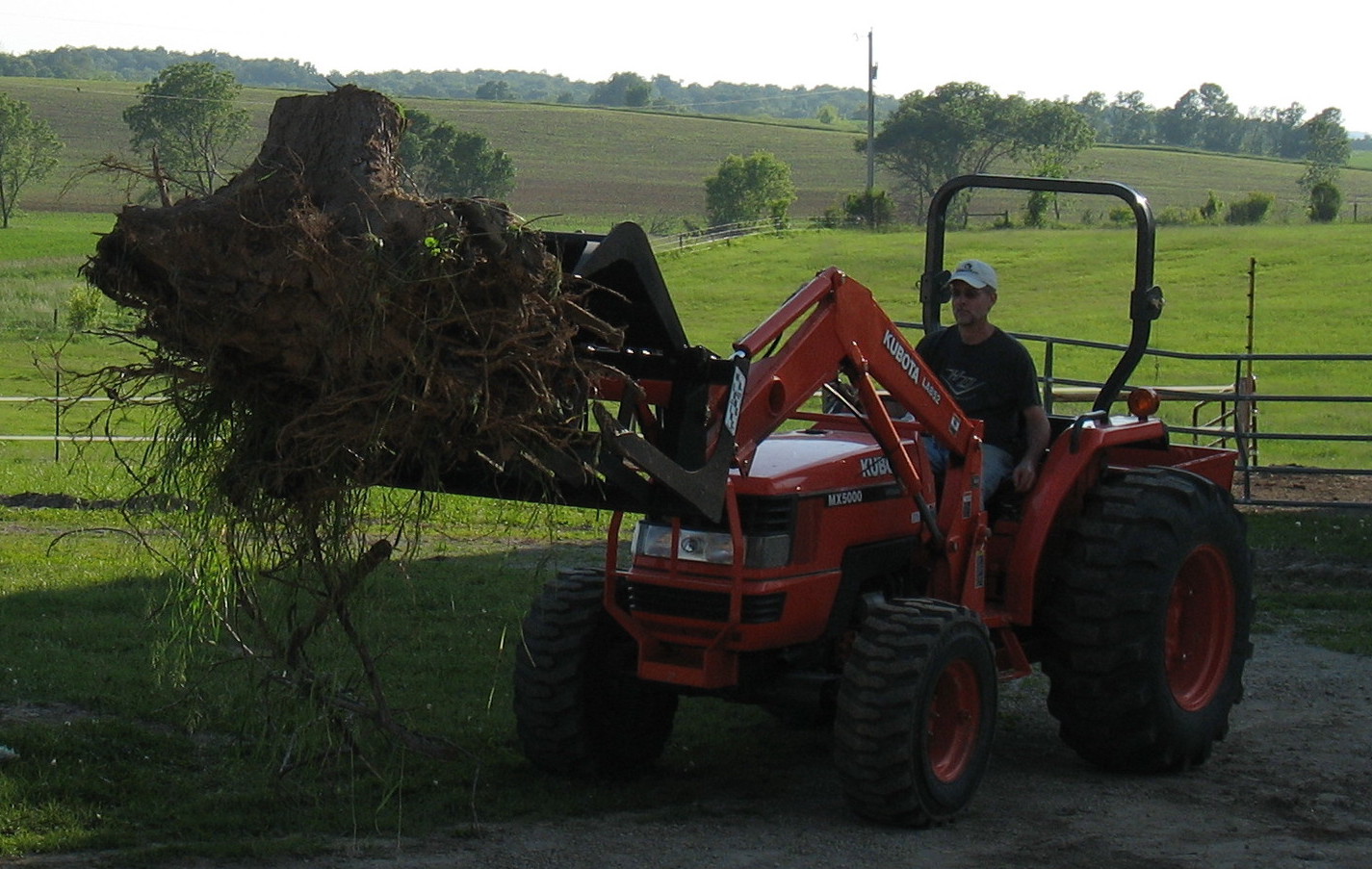

I have the WR Long, OBG2-54" grapple for my MX5000. This is a nice sized unit and I do not believe that my tractor/FEL could ever inflict and damage to it. Markham was not making their new version of grapples at the time I bought mine from WRLong. I have not seen a Markham in person but for the price difference I would recomed a close look...
I see that there are quite a few add-on type of grapples being used by members of this forum. for what I use mine for they would not do the job.
