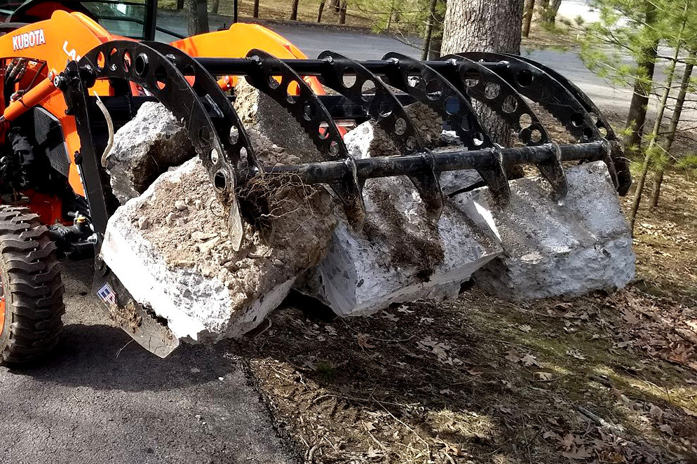

This is my Land Pride SGC 1560 grapple. Its considered a rock & root grapple - 60" wide - 820 pounds. Its controlled by a WR Long third function system - electric over hydraulic. Yes - it IS heavy and thats exactly what I wanted. With my FEL able to lift 4200 pound - out 12" beyond the lift pins - I'm able to take on a load of a bit over 3300 pounds. I've got 1550 pounds of Rim Guard in my rear tires and a 1050 pound Rhino rear blade on the 3-point and still need added ballast if I wanted to go up to the limit. I've lifted a LARGE pine log at 2850# and thats more than sufficient for any of my needs.
I've had and used this grapple for five years now and no log or large rock has even come close to causing damage to the grapple. Its good for back dragging - smoothing and leveling tilled areas.

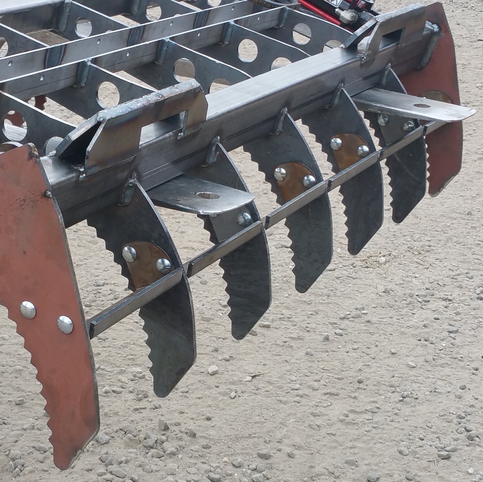

The 55" is 209 pounds with the lower runners bolted in. Remove them and shave around 30 pounds if you want to.
It's all about versatility. The runners serve as depth gauges in hard soil if you want to limit how far down the AR400 serrated tines dig in. If you're in nice soil or using it for an application where depth is preferred, simply take them off and bury the tines 8+ inches.
You'll be amazed with your small tractor's pushing ability because of the dozer like geometry and strong, skinny design of the tines.
