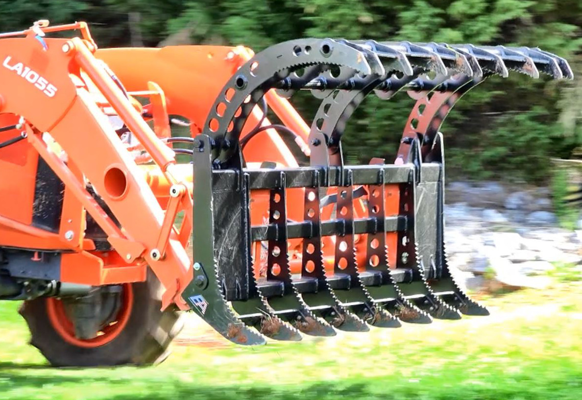

This custom kit by WR Long is the most popular, well received kit on the market and it's used by many Kioti, LS, Mahindra and Kubota dealers.
Check out the price, video with Ted and 180 customer reviews here on our website: Custom True 3rd Function Valve Kit for tractors
Take $50 off if you order with a Wicked Grapple, our lift capacity maximizing, highly functional work of art!!
Travis
Ultra Strong 400 Pound Wicked 60 would be beautiful on the NX Series!
350 pound 54" Single Lid Wicked Grapple also gets it done! Lightweight, yet plenty strong.

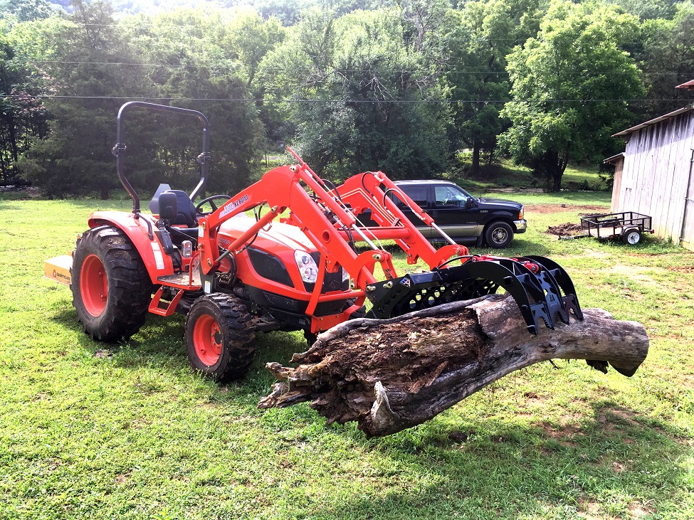

Hey that's my NX5010 in the EA picture above :) Had the dealer install the 3rd function valve and included it in the package with the tractor ~ $1000 or so. Picked up the 54" wicked grapple from EA and the rest is history. It is hands down my most used attachment. A +20" in diameter tree fell on my fence line and yesterday I cut it up in 3 8 to 12 foot segments and hauled it off to my burn pile. It was a heavy rascal but the grapple prevailed. Had the tree cleaned up and 5 strands of barb wire repaired in about 2 1/2 hours time.

I'm running my grapple from rear remotes. I've got a double detent valve (I think that's what it's called) which allows me to just pop the lever to actuate (in the case of my grapple, to open or close); allows me to free up my right hand quicker to adjust the loader angle etc. (don't have to keep my hand on the actuating lever). Downside is that you have to make sure to return the lever into the neutral position: you'll hear the pump dead-head (or note the grapple's cylinder(s) has traveled as far as it can.
My "standard" EA grapple has been able to handle as much as my tractor can handle. I doubt I could do much better than this:
