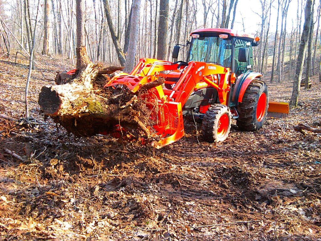

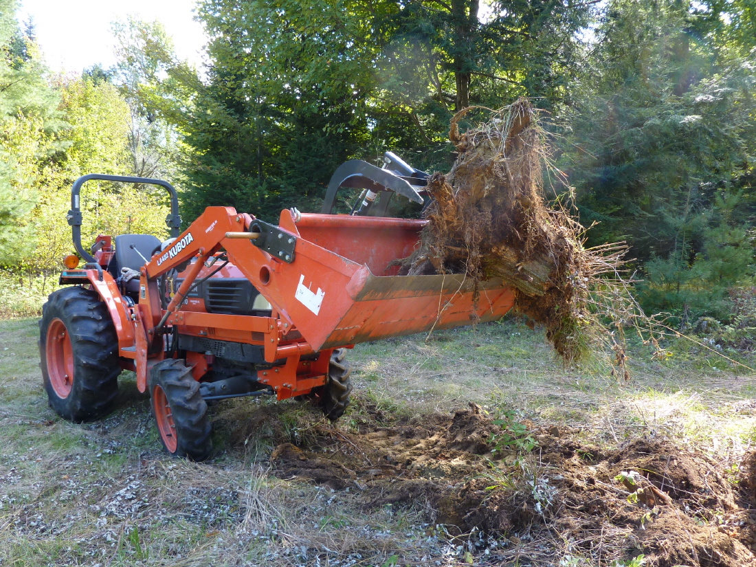

   / Grapple #4

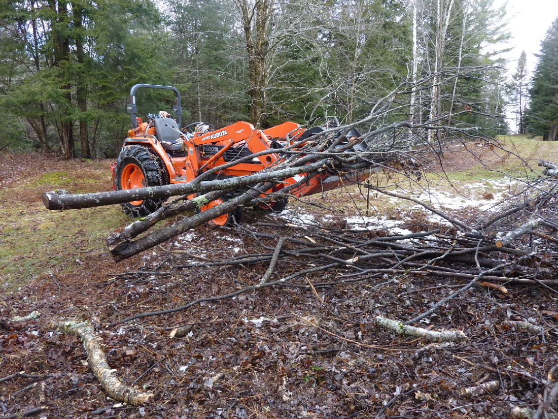

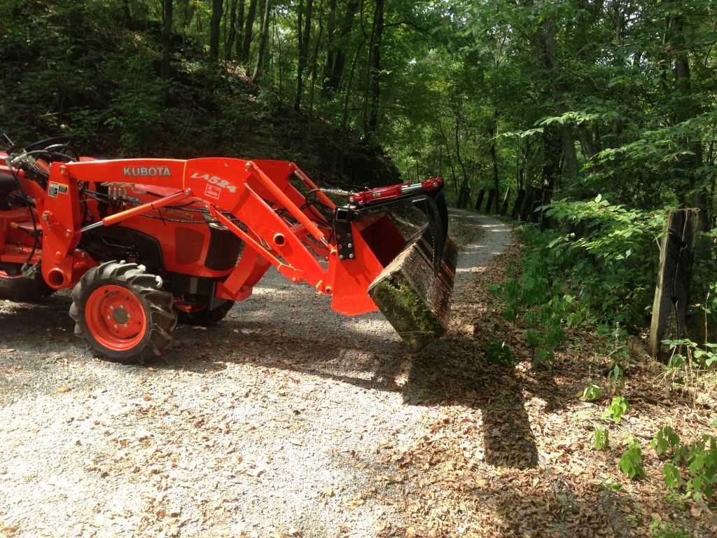

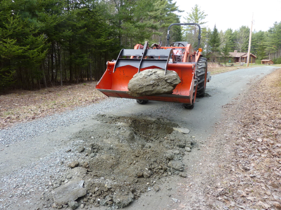

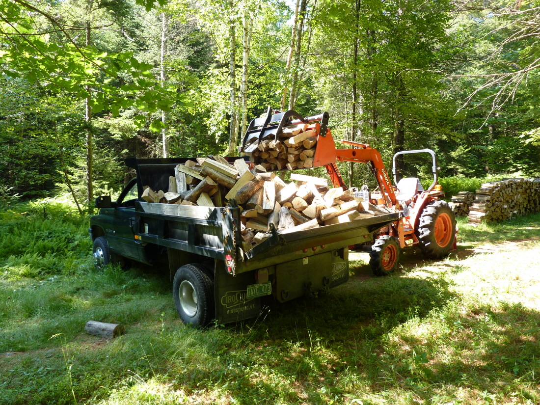

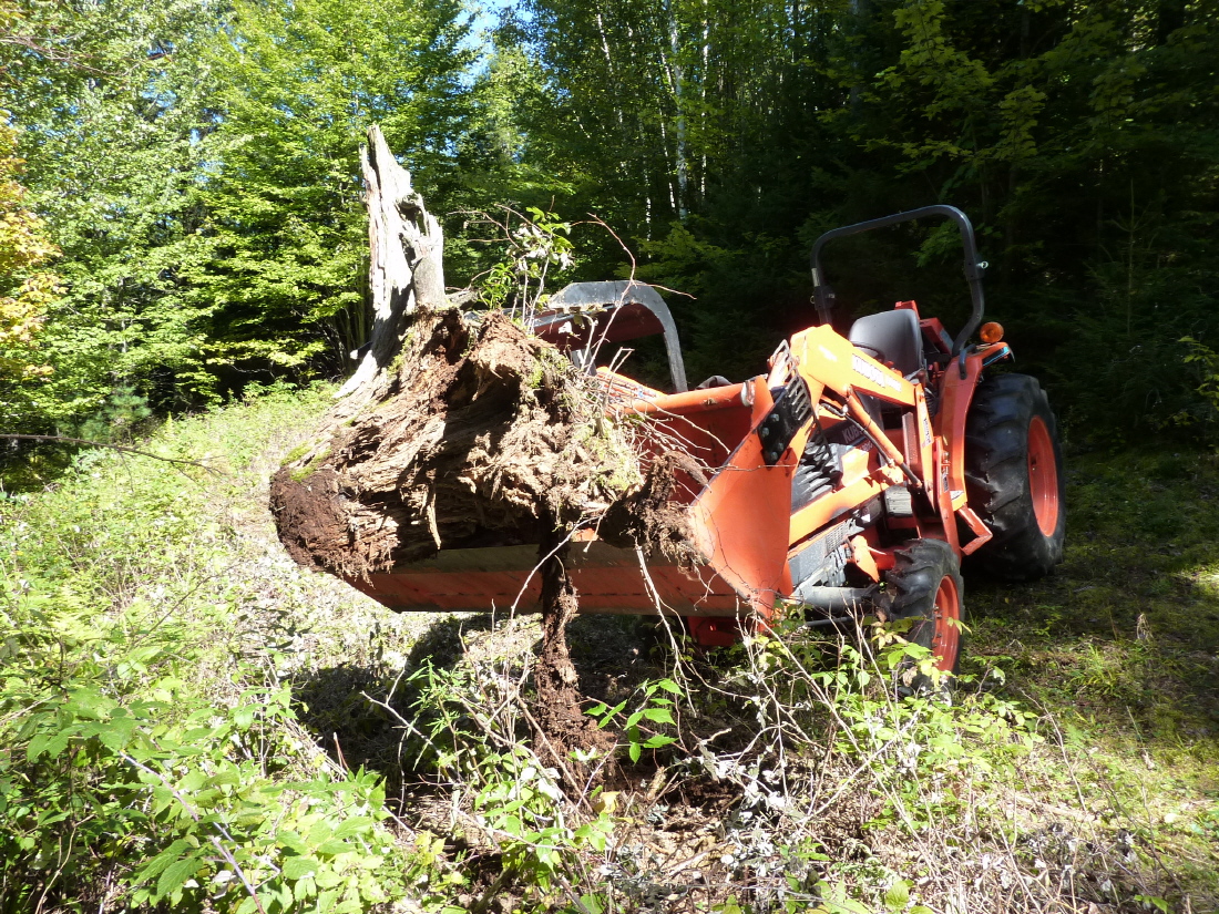

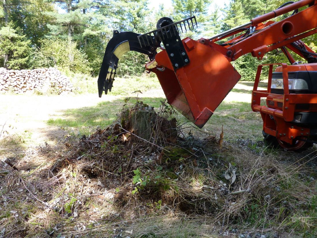

There are so many good ones. I don't have a quick attach bucket so this is what I use on my L3010 which is the same basic size as your L3130. It is a bolt on grapple. It works great for what I do which covers all the things in your list. I like having the bucket and/or grapple available all the time down in the woods. So I don't have to go all the way home to change one out for the other.

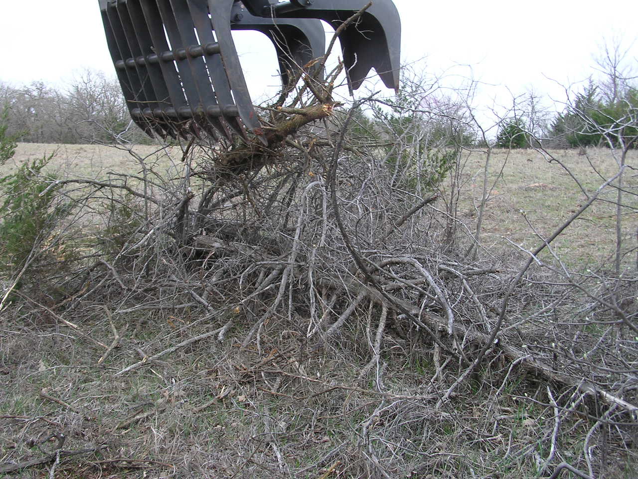

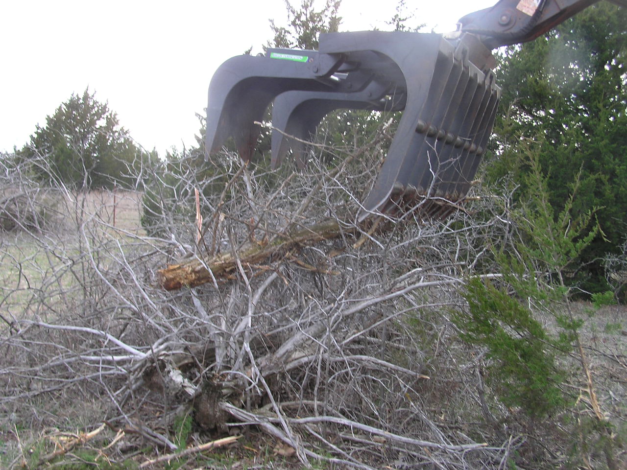

   / Grapple #5

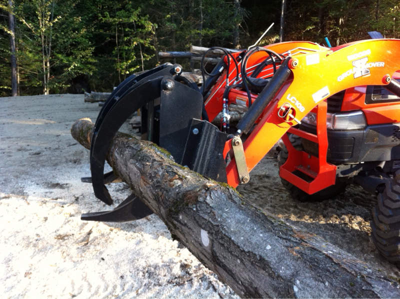

Hello neighbor,

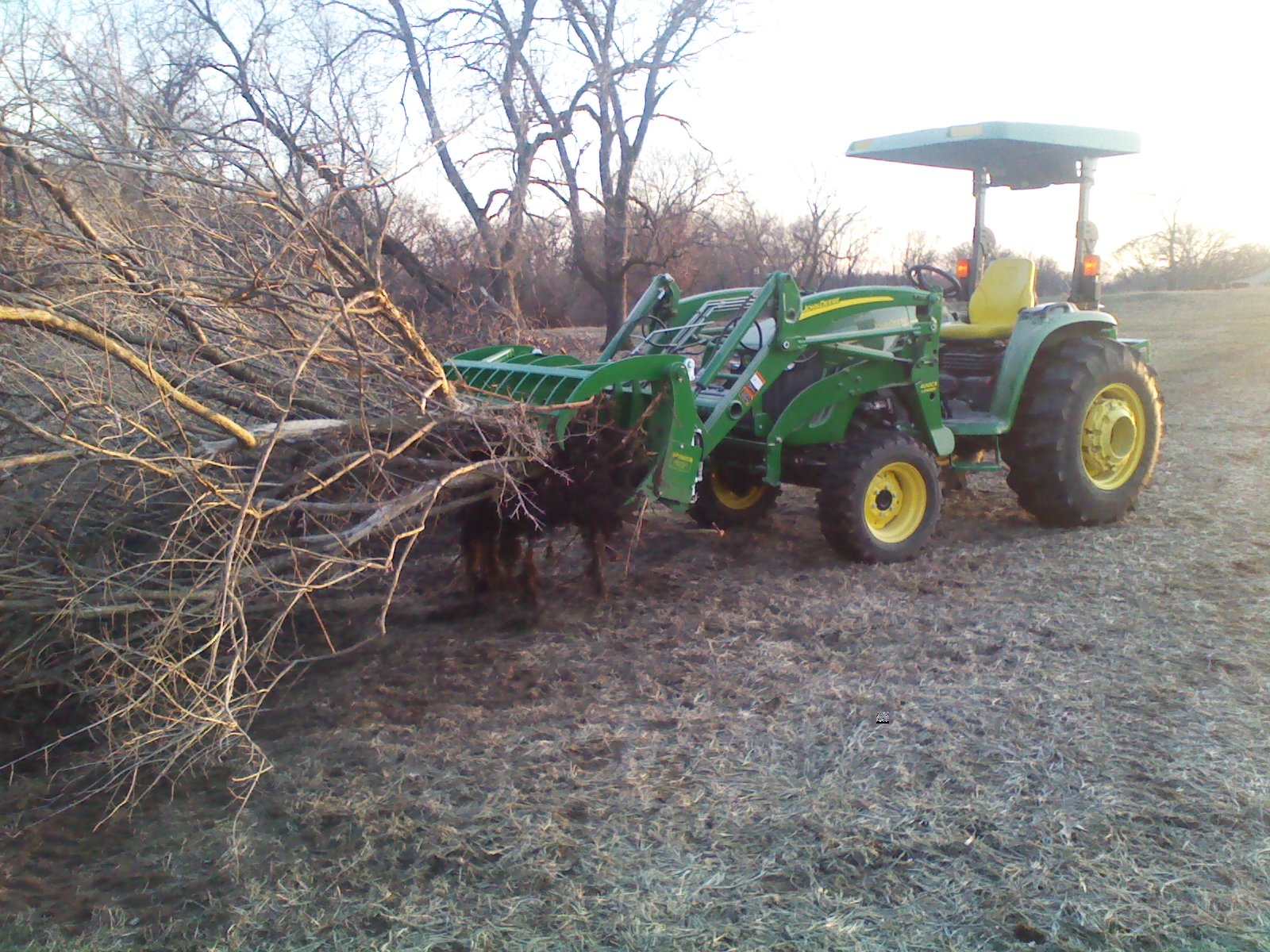

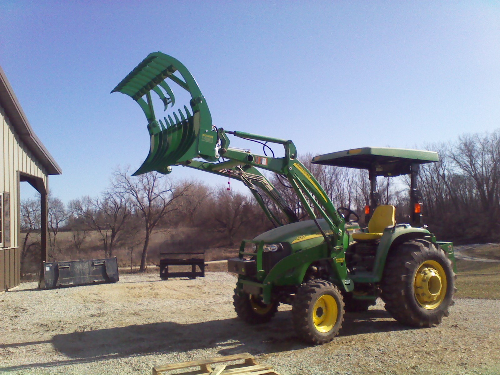

Like Gordon, I went the Add-a-Grapple route. My total cost was about $1400 (self installed). Here is a photo of mine, (moving some hedge logs and a bridge railroad tie)...
It's one of the best investments ever.
You must have that loader on steroids. That big log and rock can't be light. Nice.

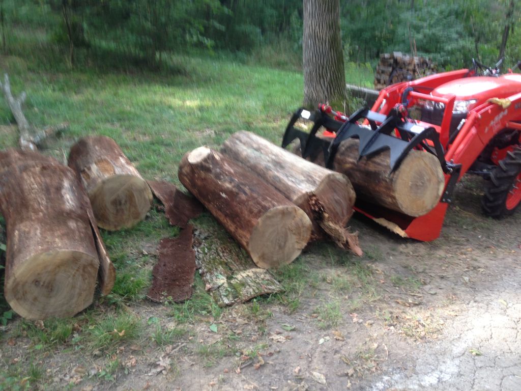

I have to agree. I have a GR-20 Igland grapple also and it excels at handling timber. I use it to block my fire wood. Grab a log, keep it at waist height and block away. Way easier on my back and my chain also! Keeps me from bending over and my chain out of the dirt.
Gordon, (and everyone else), thanks for the advice. I think I might like, too, having the bucket and th grapple available. Hving never used such a piece of equipment, though, I am concerned about the comments that the bucket/grapple combination is a useless one. Have you had any issues in this regard? No more than I use it, I would supect I could give up sheer performance for versatility, but am curious to thought sin this regard.

I guess I don't know how to answer. It is certainly not useless to me. I use it all the time for all kinds of things. I can not image why someone would consider it useless. All I can think is that he was trying to do something it was not ment for or the geometry of his mounting was such that it did not work well.

Having multiple buckets, multiple grapples and multiple tractors I have the flexibility to match what I need at the time. But that does't mean a bucket with a grapple lid would not be worth having. I liken it to a having a tractor with loader and backhoe (TLB). I could have a dedicated articulated loader and I could have a dedicated excavator. Will the backhoe dig like an excavator? No. Will the FEL on the tractor keep up with a dedicated loader? No. Is it handy to have an all in one TLB? YES. Having a bucket on all the time sure would be handy when I have to fix a fence or something. Toss everything in the bucket and go do the work. Try that with a OBG grapple.
