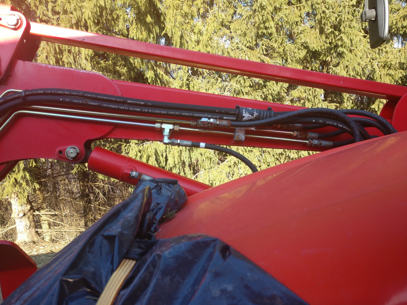

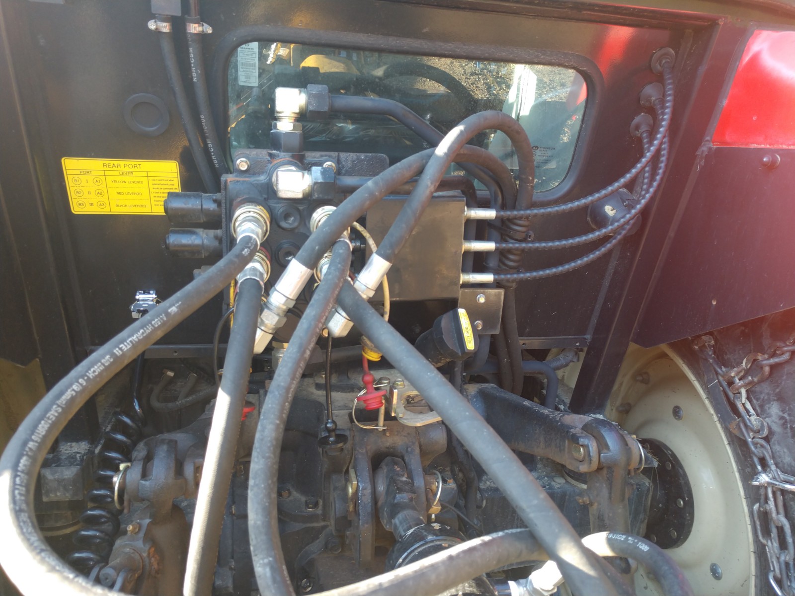

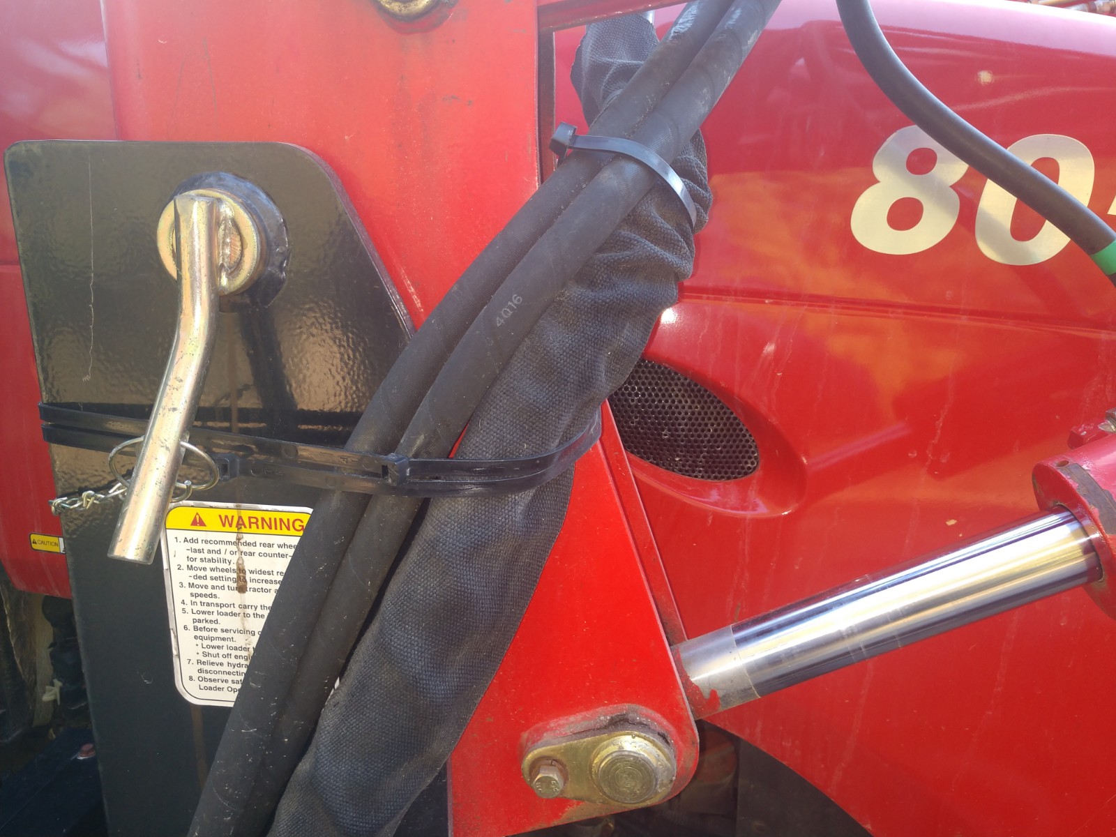

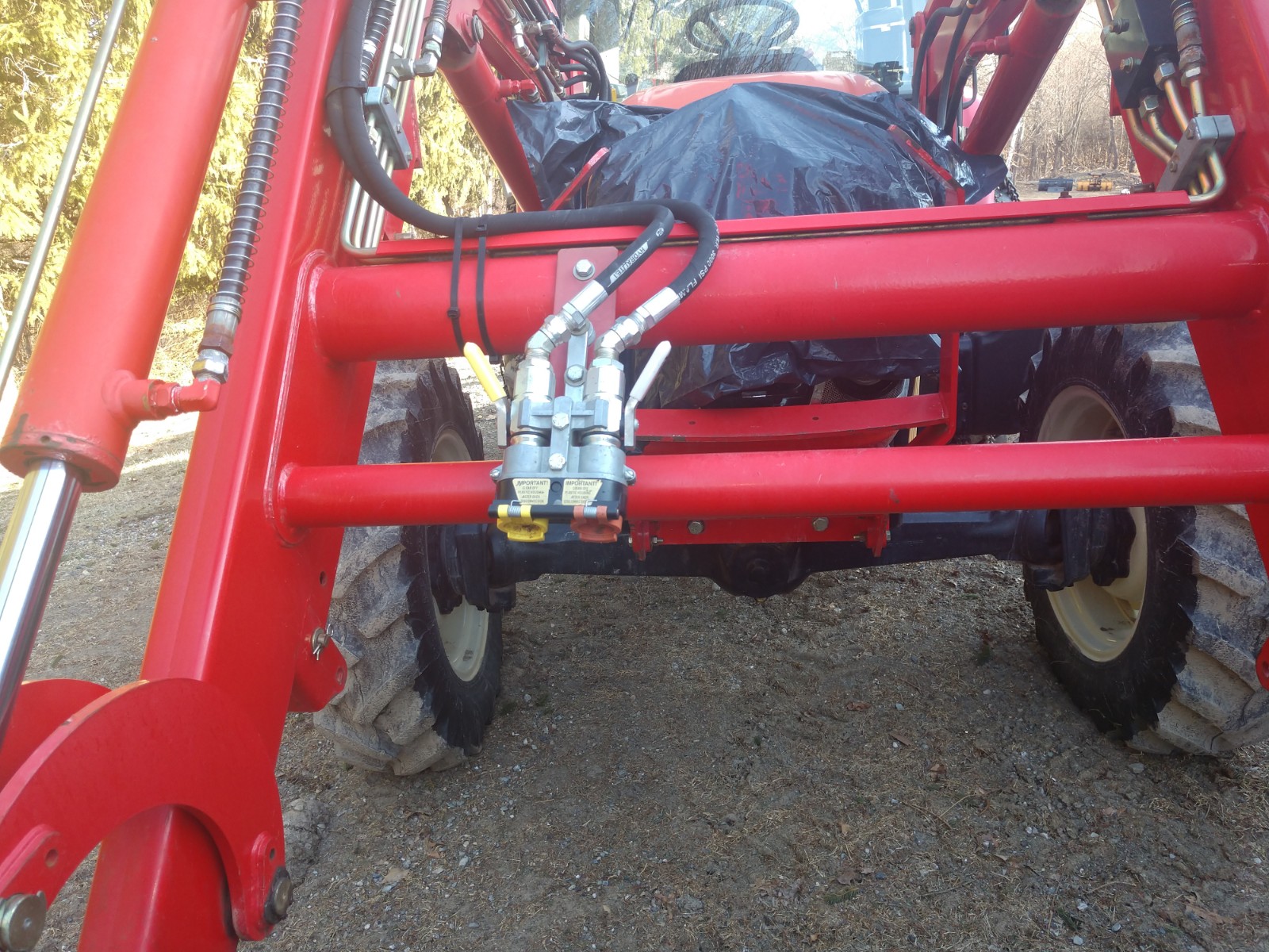

I run mine of the a rear remote for my grapple and front blade.
rear to front remotes3.jpgrear to front remotes2.jpgrear to front remotes1.jpgRear remotes1.jpg
   / Grapple using rear remotes #6
I use all three of my rear remotes on the Kubota almost all the time. I only have two on the Ford and wish it had a third. Good pics Lou.

Nice job Lou. I ran mine off the rear also. I installed a set of quick disconnects just under the loader disconnects. I still need to make a bracket for the front of the loader. Using the rear remote lever for your grapple bucket is no big deal. I like my ergo Kioti knob. I don't like the Kioti 3rd function knob. Not to mention paying $1250.00 for a kit or $1500.00+ installed.
