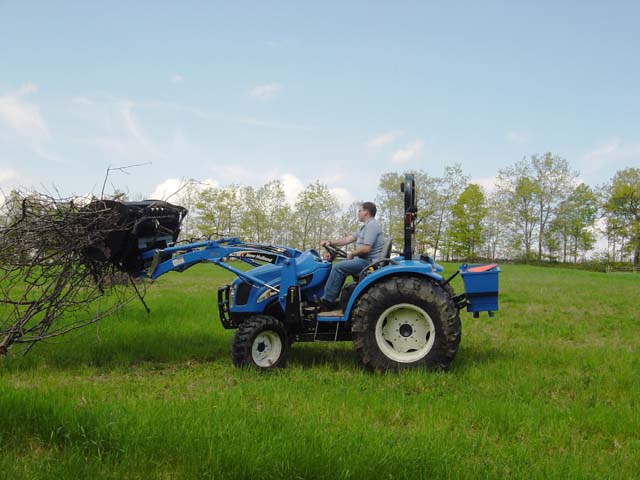

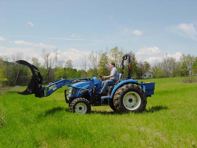

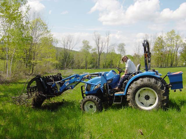

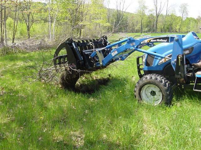

Absolutely get something that is quick attach. Dad has the 66" anbo Lightweight on his TC40DA - on & off in 3 minutes.
Weight is 450# - Cost $2750 last November.
The anbo design is great as it doesn't pick up dirt & has lots of teeth (as far as I know, more than anyone else) that easily grab all the brush. I have a couple pics on my home computer - I'll try to remember to post them tonight.

as promised here are some pics.
   / Grapple suggestions for the TC40 #9
Replace your Divots...
   / Grapple suggestions for the TC40 #10
The guilty driver...
