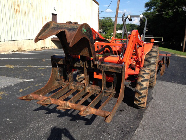

If just picking up piles, the long tines should do fine. But I use mine a tremendous amount for knocking down trees, up rooting them and digging. I think the long tines would not work well for that. The bar that connects my tines across the front is what I push trees with, trees up to 7" or so. I think if I pushed with the long tines, the trunk would wedge between them or bend them. I use the curve of the tines to "roll" out the root balls by curling the cylinder.
As far as the single thumb, it really doesn't hurt your view too much. You really can't see the working edge of the grapple any way, just like you can't see the edge of your bucket when engaging the ground with a standard bucket. You kinda do this by feel. And mine is narrow enough to see around. But it does lessen the weight, lessens the complexity and works just fine. Now if I had a wider one, sure two would be better, but for my narrow grapple, one works just fine. You'll find the clamping function of the thumb is really very minor, as it just secures what you have picked up. It doesn't take much to do that.
I've picked up enough debris, limbs, trees to make a pile a mile high. This design of mine excels at that. Of course, most any grapple would work for that. I think uprooting and digging root balls is what separates the different design styles.

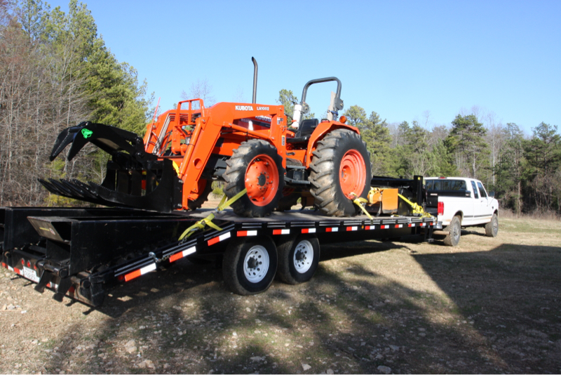

HCJ, the unsupported tines do not bend. I know I have tried. One tine does pick up the tractor. Only occasionally does a tree trunk get stuck in-between the tines and then a simple back drag will clear the tines. I like the long tines because I can dig deeper easier than the kind of grapple with the round cross bar blocking the dig - I have worked with both. I got the light duty 60" (I have a 72" FEL) and I like the size - any larger would not be a benefit if you are removing standing trees. If you are just removing top, already cut brush then a 72" is OK. To the Rakeshop's basic design I moved the tines in by adding an extra in their standard 60" and I also added the slotted backing. Pictures of my grapple have been on several threads here on TBN and I am not associated with them in any way. I am very satisfied with my grapple, it has done exactly what I expected it to do. I also like the fact that they will listen to you and build you a custom grapple.
