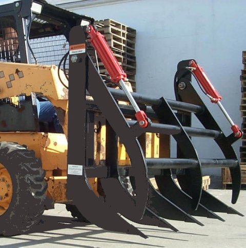

I use a Worksaver skid steer grapple on both my 2120 and TN and it works great for the type of work you describe. Cost was about $2300 Worksaver Grapple

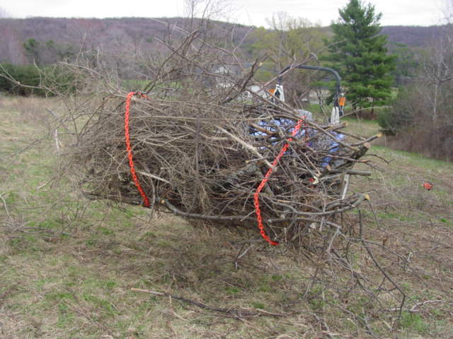

For what it's worth Paul I have a similar situation. After looking at the cost of grapple buckets I decided to go rough on it. I just took this pile of brush and rolled it like a dead mouse, squished it with the loader bottom, rolled it some more then rolled it over two chains I have and tied the whole mess together. Carried it several hundred yards and only lost a little. I'd guess there were four hundred pounds at least since the bucket is filled with some large, wet hardwood about 14" in diameter.
