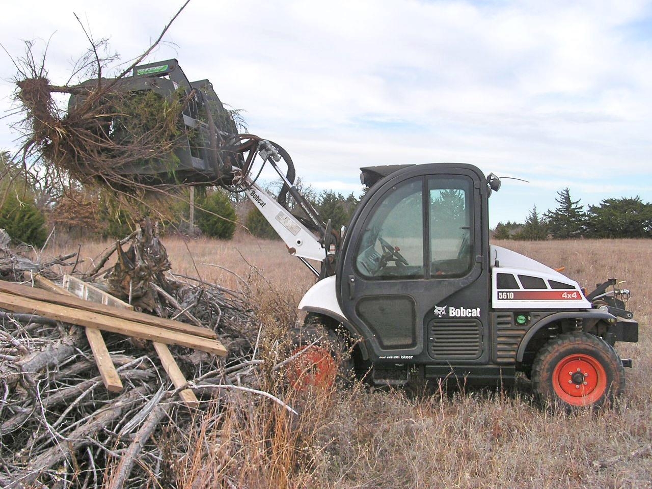

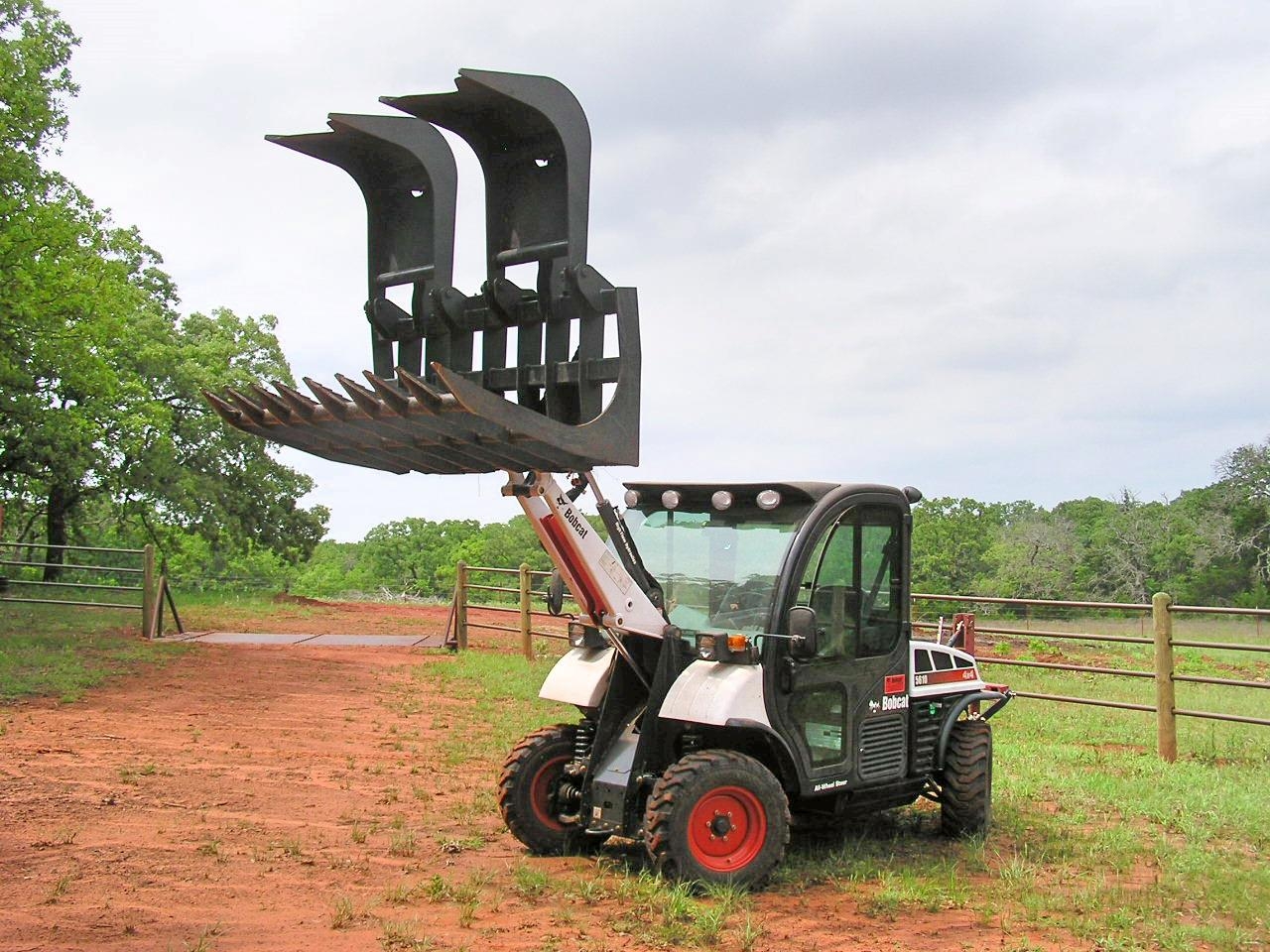

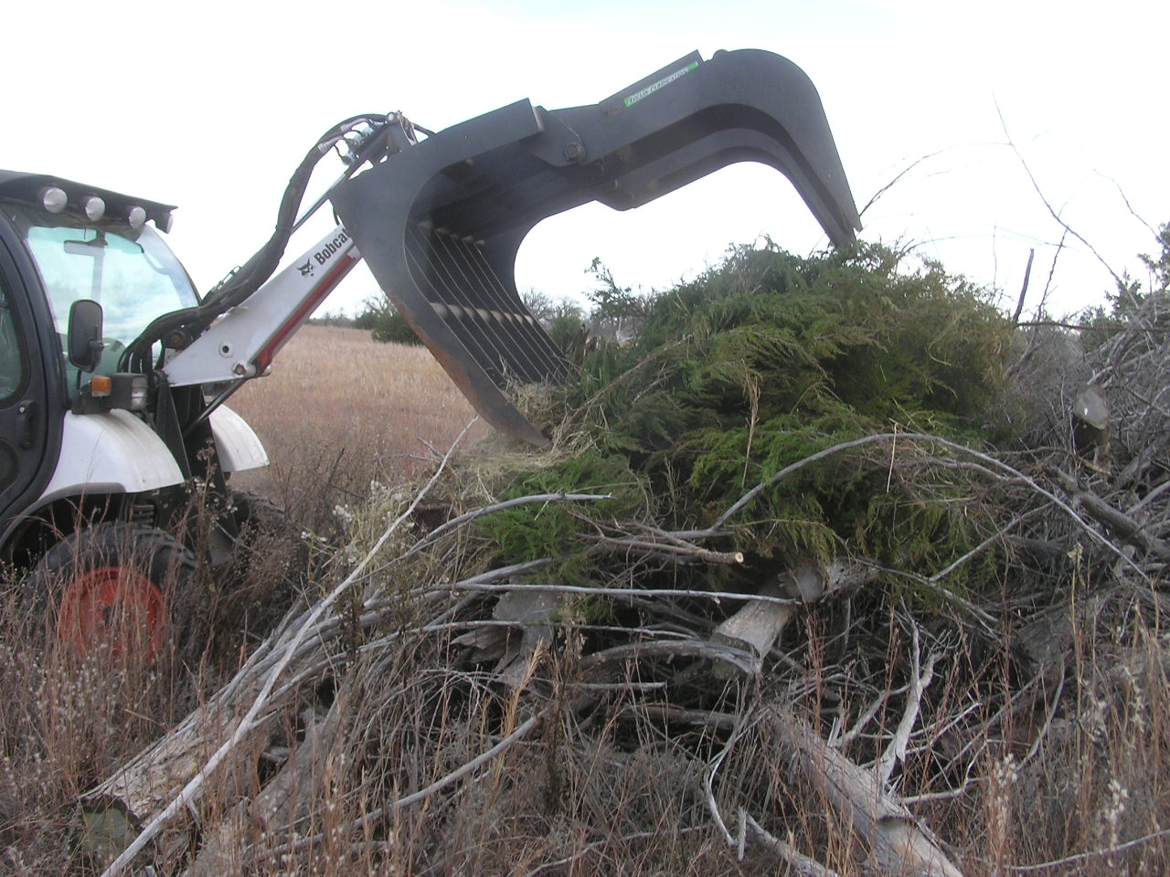

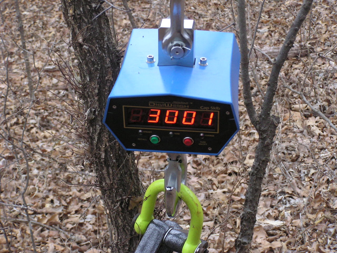

My machine has a ROC of 1500 lbs.
But it will iift and handle twice that. At least ours will.
The crane scale anchored to a big stump and being pulled up by the FEL:

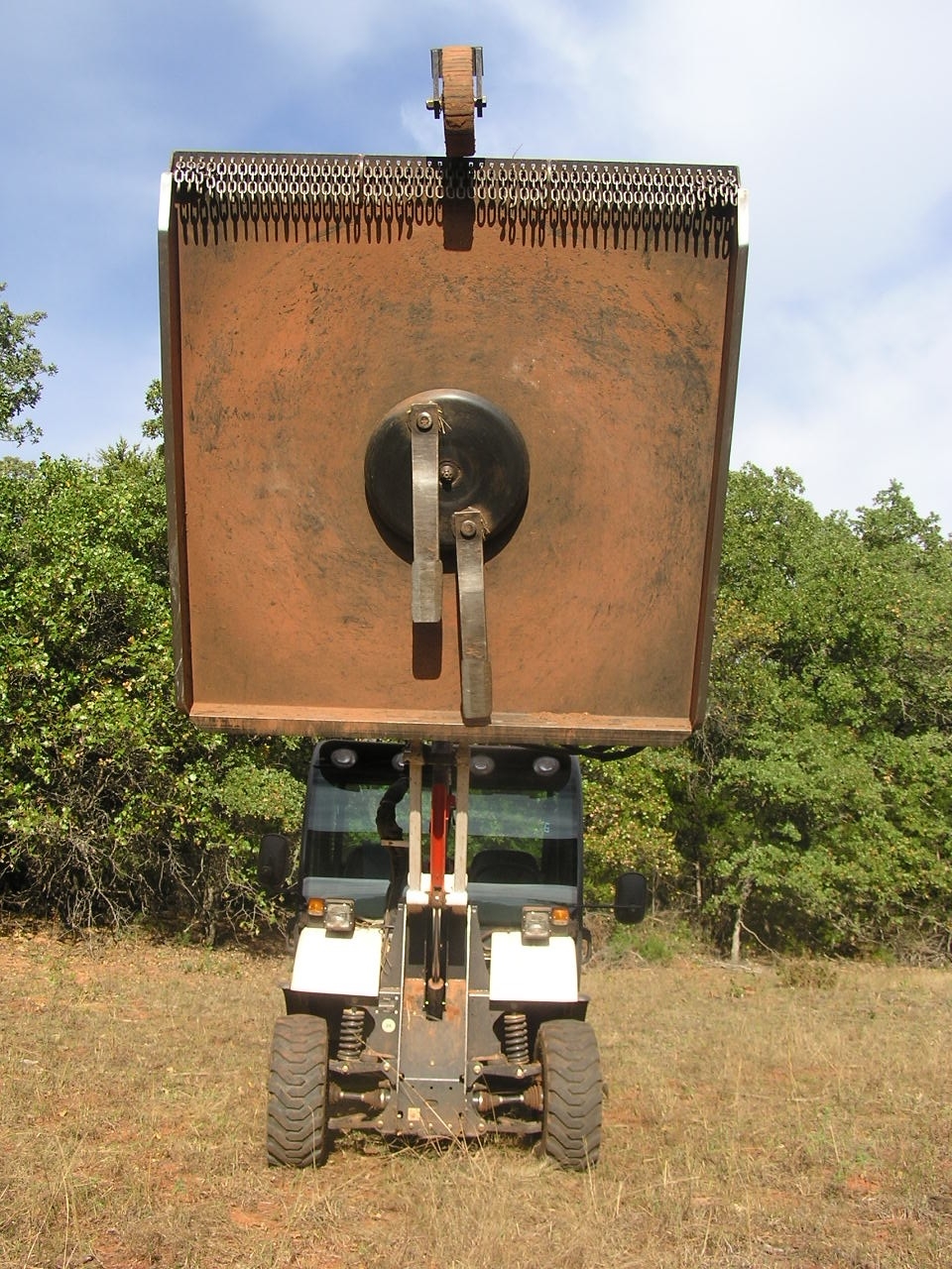

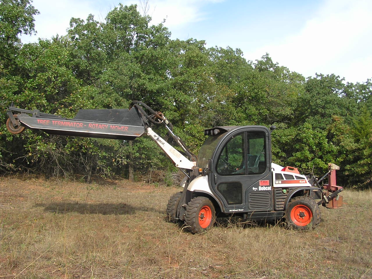

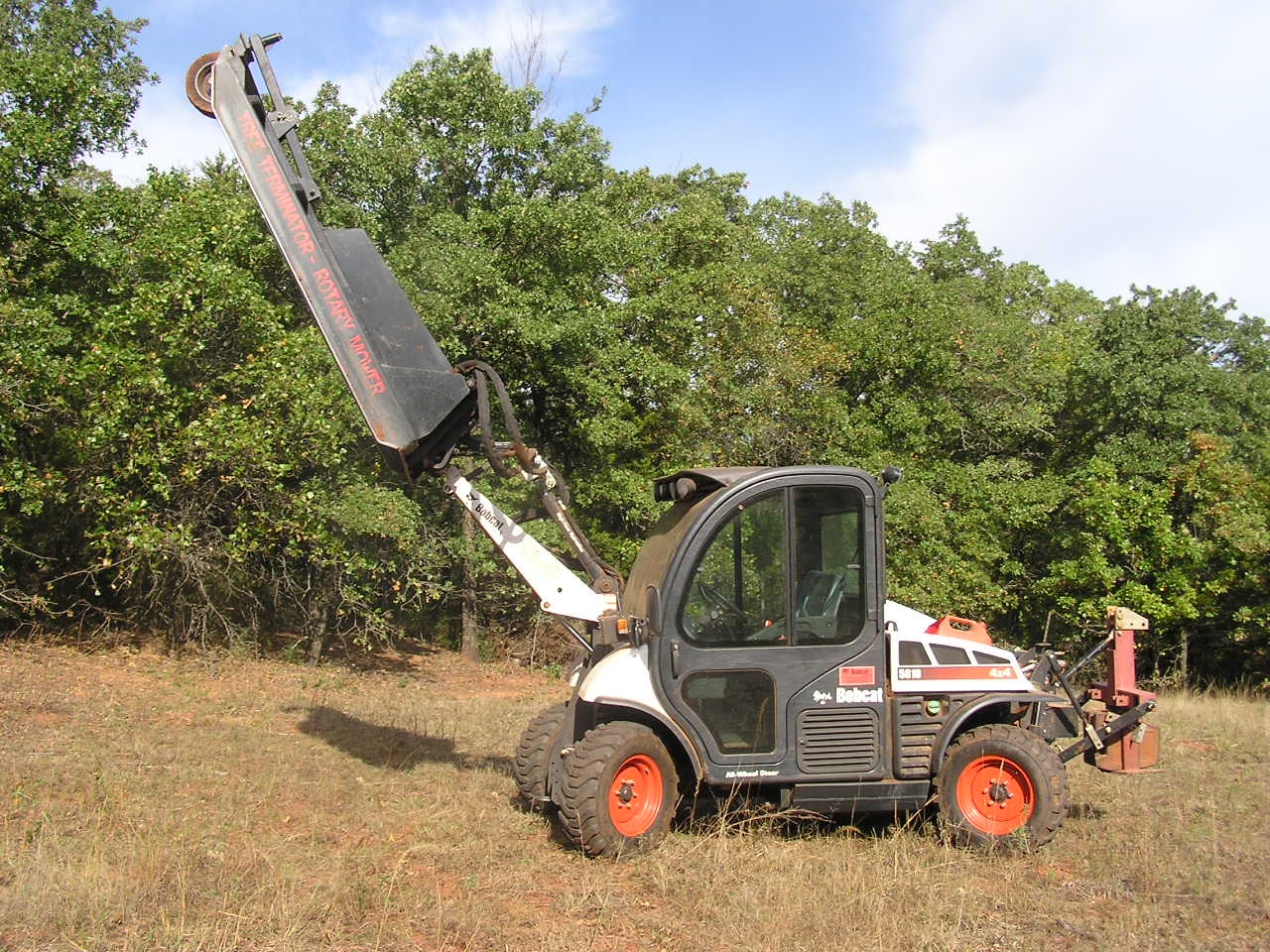

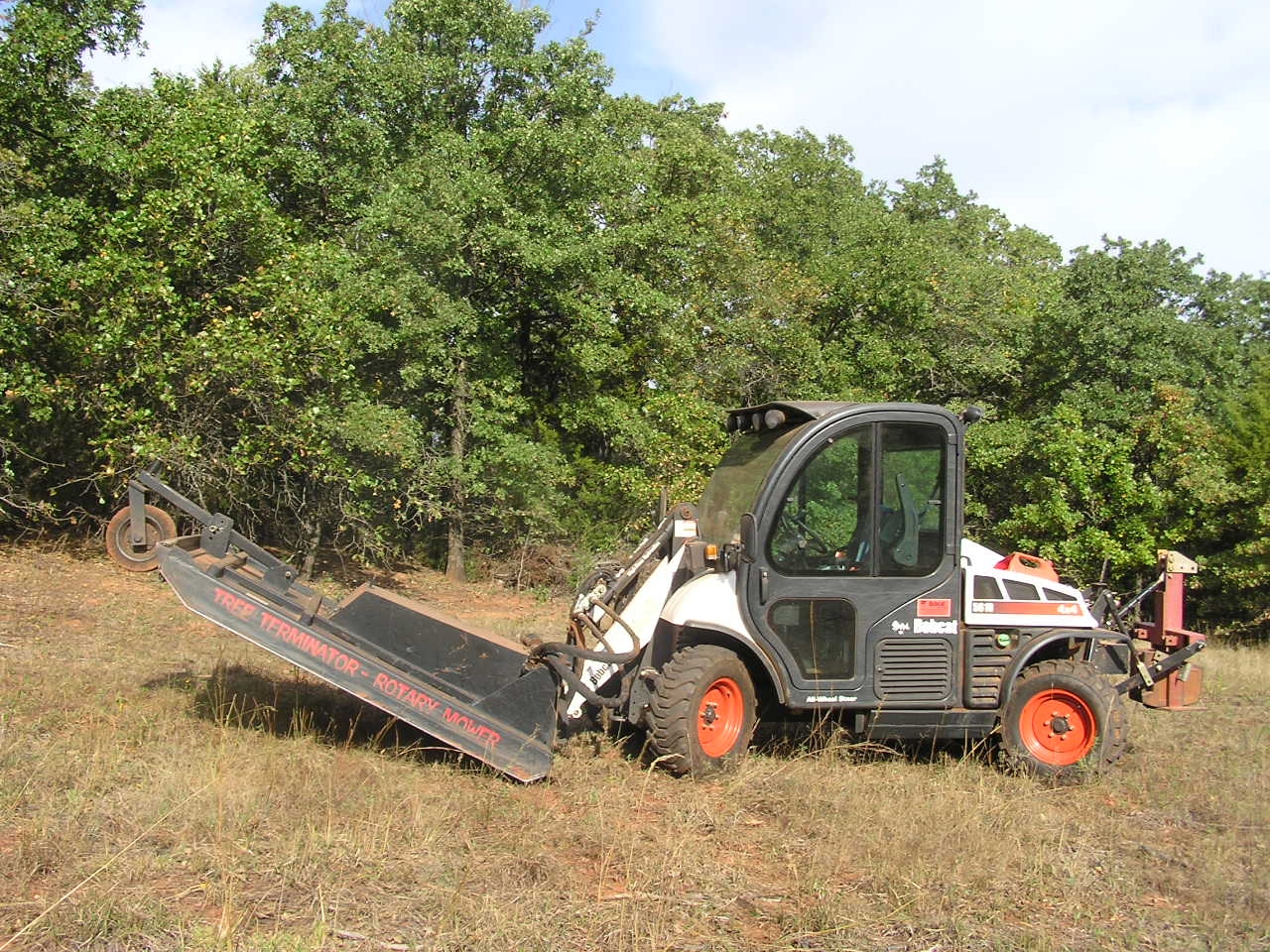

The brush hog weighs 1800 lbs.:
And the 1168 lb. 6 ft. Monster grapple:
