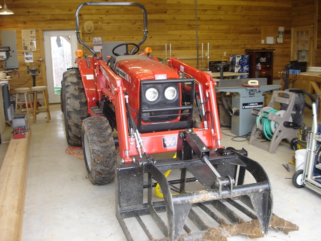

How about a picture of your set up.

The only picture I currently have is the one in my avatar.
Here's a larger one of it...
Thanks!

I can't see the braces for the tines in the front, but if they are there, just push two or three tines under the 2 or 3 in trees and just flip them up and out.

It's a Markham grapple; I paid $1088 including shipping and $100 for extra tines/braces...
