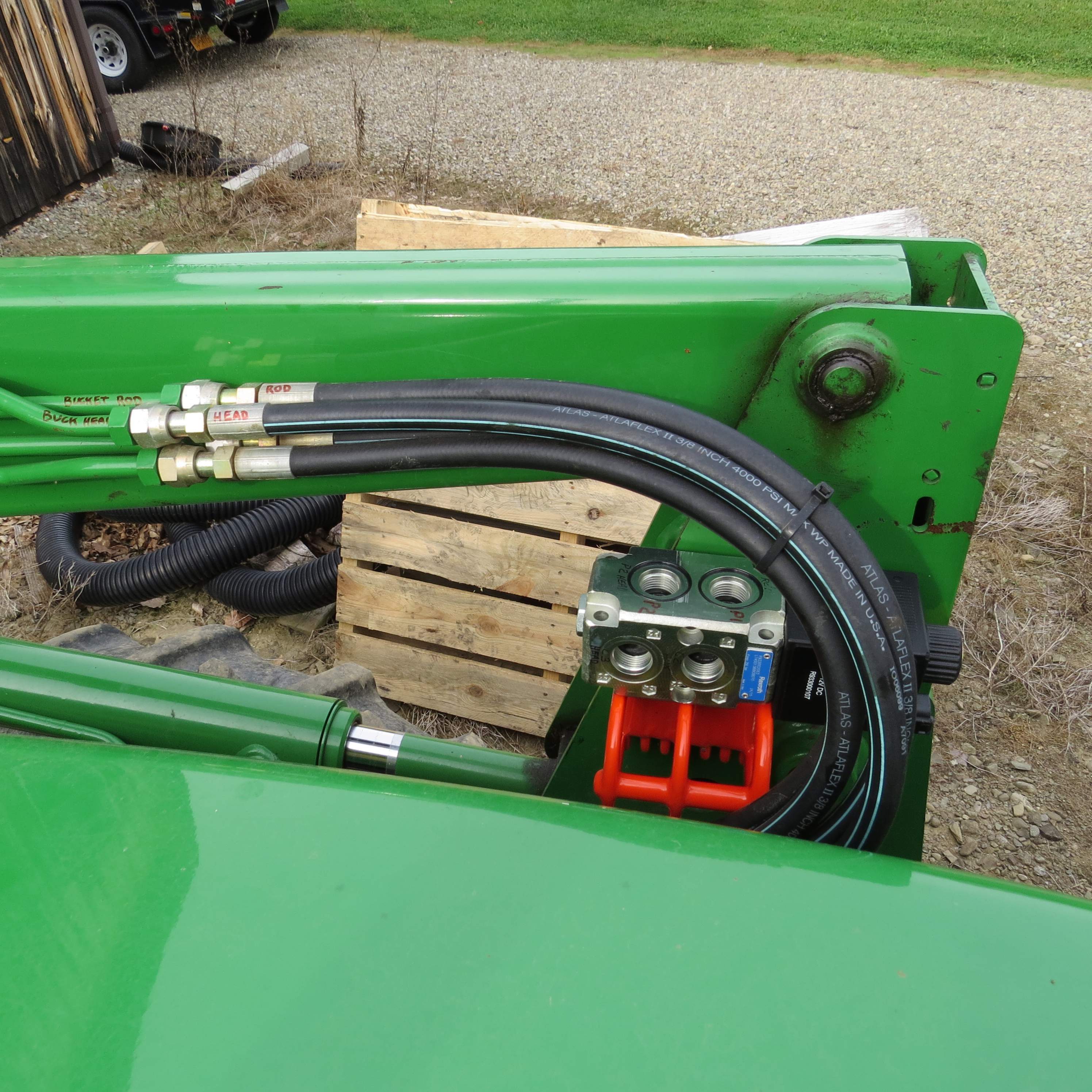

I finally made a decision on which grapple to purchase and it arrived last week. Now comes the task of hooking up the hydraulics. Not as simple as I first thought. There are so many options for fittings that I am really getting confused. Especially when trying to figure out which type is compatible with other types. My valve is a Fasse which is tapped -08 O ring Boss. My loader is a JD 541 and I am tying into the system at the point where my hoses connect to the steel lines. Not sure what the fittings sizes or type are ate this junction. All of my hoses and steel lines are original. Anyone got an idea what JD uses for size and type. The hoses are 3/8". I found a chart that lists all the types of fittings but that is when I got really confused. Never knew that there were that many choices and types.
Is there an easy way to determine what I need. The fittings seem to be quite expensive so I don't really want to purchase more than what I actually need. Also it is a 2 hour ride to get to the job which can be a problem when you don't bring the right tool or fitting. Any help would be greatly appreciated.

I will be breaking the hose to steel line connection of the top two lines. The hose lines will go to the P1 and P2 ports on my Fasse diverter valve. Then two short hoses will go from the diverter valve to the two steel lines and reconnect the primary circuit. Also then two hoses will go from the Fasse valve and connect with the two hoses that came attached to the grapple cylinders.

The diverter is ORB (not flat-faced; flat-faced is usually super high pressure in my experience (over 6ksi)).
The "-" numbers are in 1/16ths. So a -8 is a 1/2" fitting.
What I did was go from -8 ORB to -6 JIC. Then -6 JIC everywhere.
Often the ports on the diverters are too close together to use a 90 degree ORB to JIC, as you can't spin the second one with the first one in place. Going to JIC alleviates that issue, as the 90 degree JIC hose end swivels for tightening.

I think of a diverter as a "Y" valve.
loader curl goes to one leg of the "Y".
Depress the button to activate the valve, and loader curl goes to the other leg of the "Y".
So:
joystick left can either curl the bucket up or open the grapple.
joystick right can either curl the bucket down or close the grapple.
