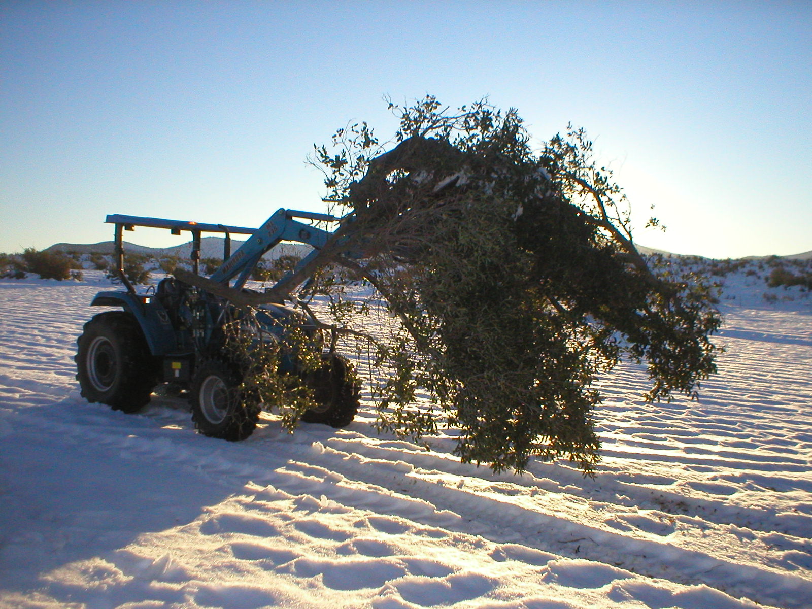

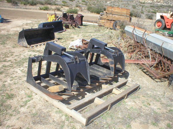

I think that you will find that a grapple will work much better for your brush work. Most people don't think about it, but you can use a root grapple to grade with. Been there, done that.
Good luck with your decision. ;)

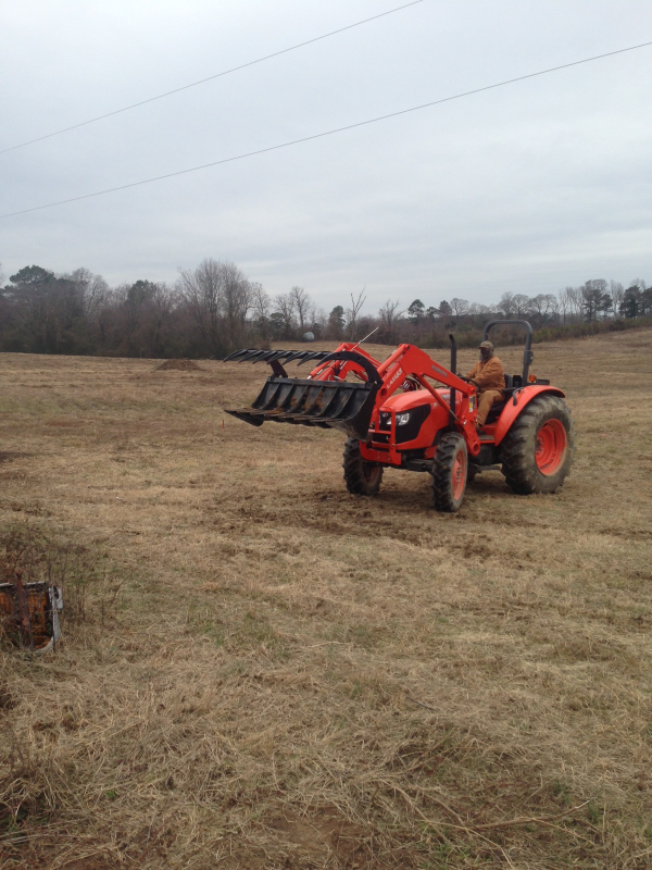

<img src="http://www.tractorbynet.com/forums/attachment.php?attachmentid=366229"/>
Or if ya got the coin get both can never have to may attachments .
Sent from my iPhone 5 using TractorByNet
Or he could get a grapple and a dozer blade since he wants to grade with it, if he wants to get 2 attachments.
Wow, nice load !
Thanks, I think it weighed between 1700-1800lbs. This one was way heavier even though it was rotten about 5' up. I have some more logs/ trees I'll be moving soon. I'll post them somewhere.

Well I pulled the trigger today and bought a new Prowler 78" heavy duty root grapple. I think I got a good deal on it.
   / grapple or 4 in 1 bucket #20
