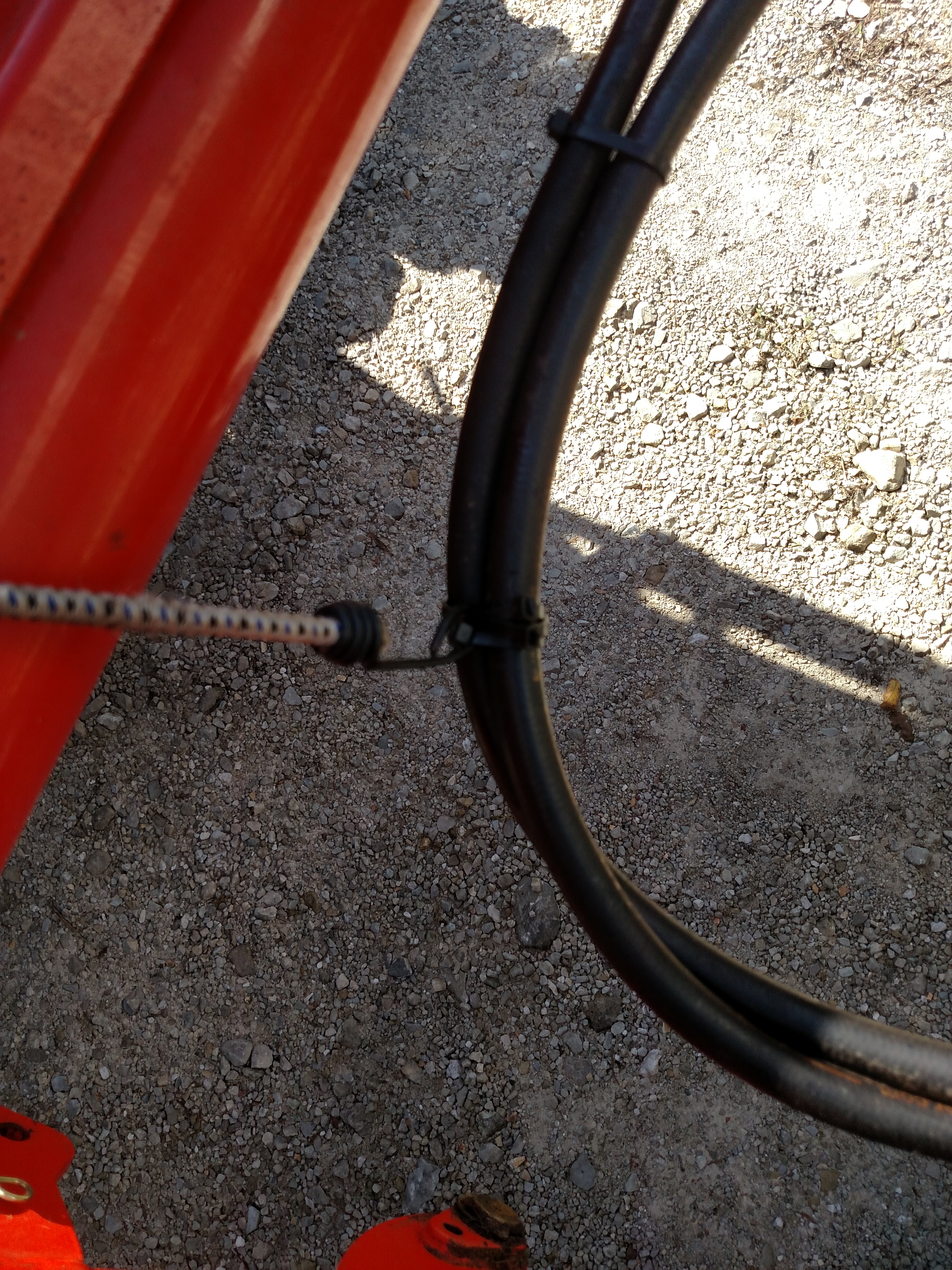

I have used a bungee cord for several years and it works beautifully. I would not do it any other way. It is getting about time to replace the bungee though, it is getting pretty ratty and they don't last forever. But for under a dollar, I am good to go. I closed off the hose end of the bungee, and tie wrapped in on the middle of the hoses Then the hook end goes up to one of the hydraulic fittings on on the loader arm. I have never had it come off, and it it stretches and works great. I would have no use for the expensive springs etc. that people sell.

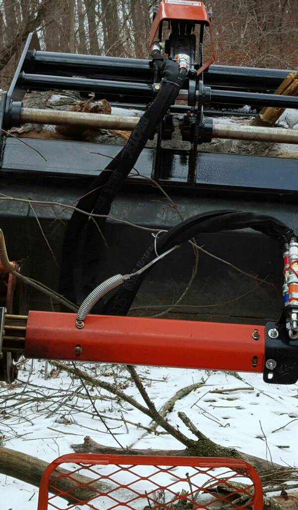

I used a hard hose mount on the cross arm for a while, and bent it almost immediately. Then I tried bungee cords, but wasn't really satisfied with them. Finally I settled on the spring hose mount that Everything Attachments sells, and it has been perfect.

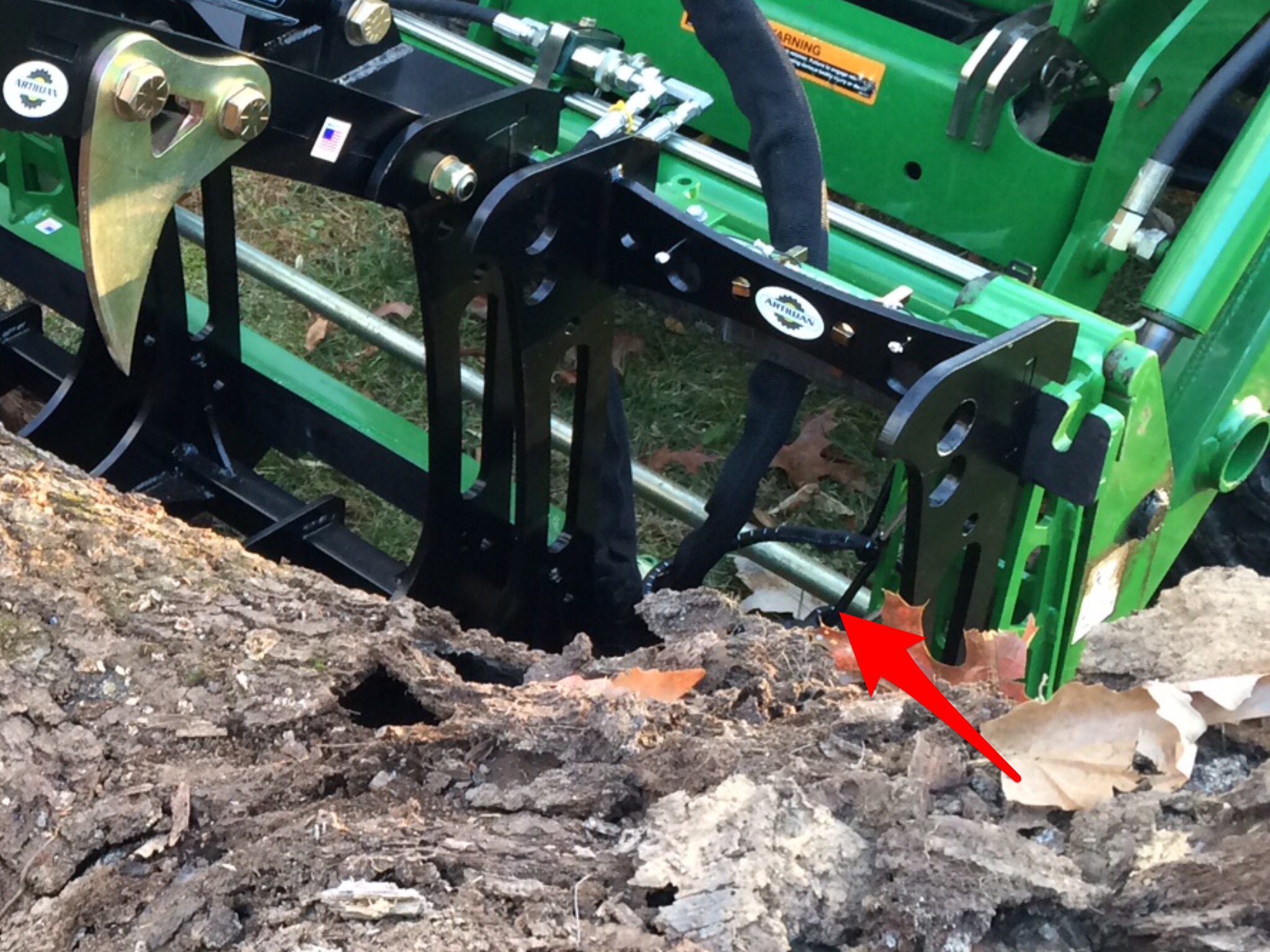

Bungee here as well, it comes set up that way from Artillian.
You can't see it well in these pice, but they are the best I have with me:

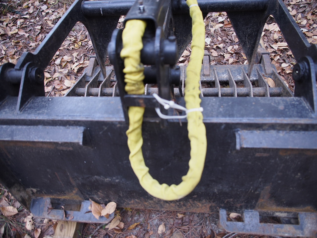

Here is how I have mine.

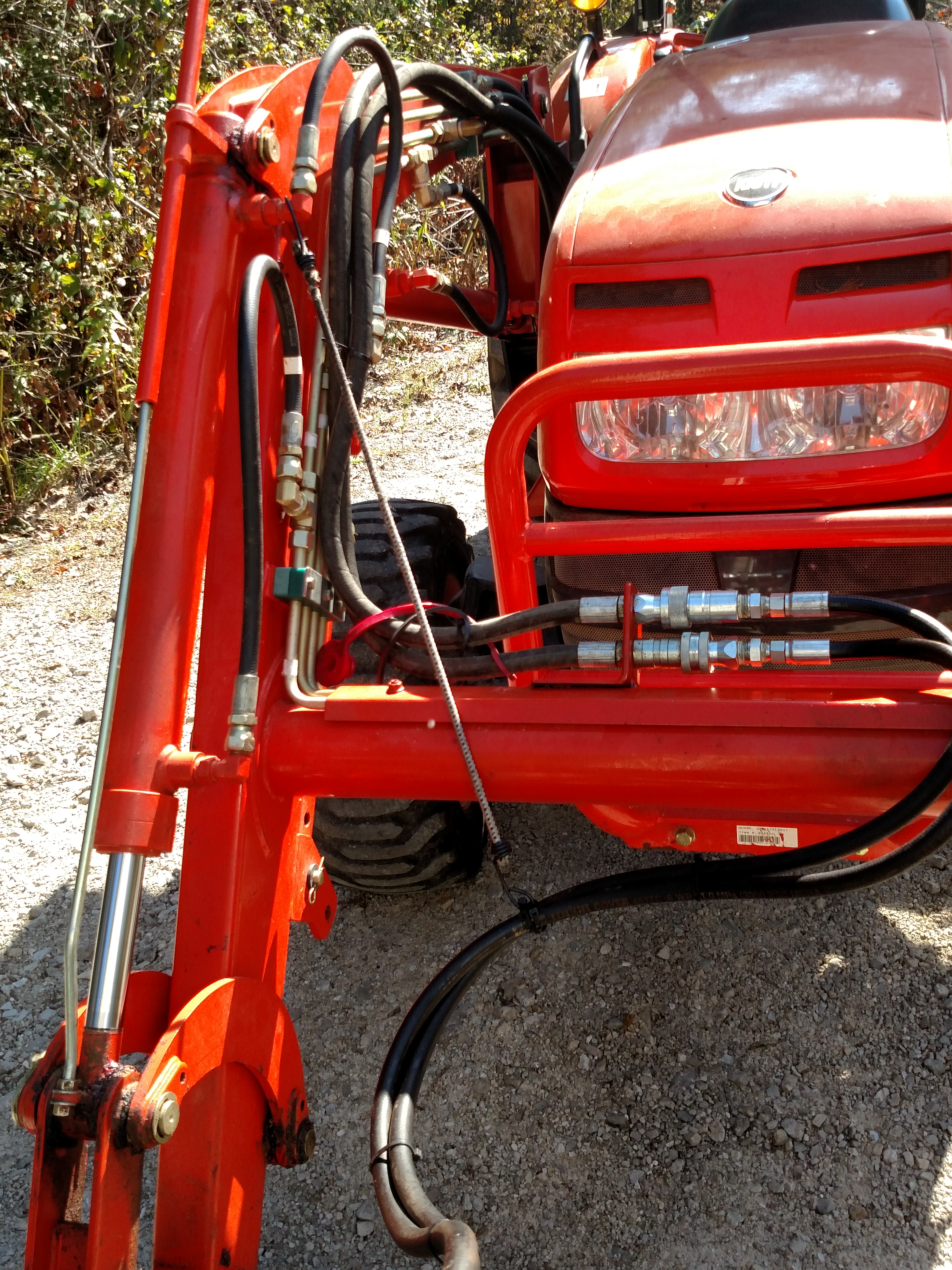

Lets see if this helps. The read arrows denote the ends of the bungee cord. The closed end is in the middle of the hose run and the open hook end is hooked over a FEL fitting. More photos can be seen in my brush grabber attachment thread.

Ta, James! Now I see what you've done.
My FEL 3rd Function jacks end at the R-hand arm as opposed to yours, which end in the middle. My 4in1 has the long hydraulic lines. So far, there's no interference but I'll keep the bungie-cord (also known here as an 'ockie-strap') solution in the back of my noggin for the future.
