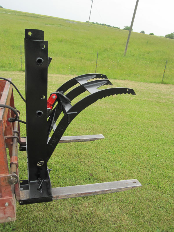

I am thinking of building a grapple on top of my fork frame for moving brush. I can easily add the third function, I have 2 remotes and one isn't being used. I am looking for home built ones if you've done it yourself or ideas/do's/don'ts. Thanks in advance!
   / Grapple for fork frame on tractor loader #2
I bought one of these: t2.jpg

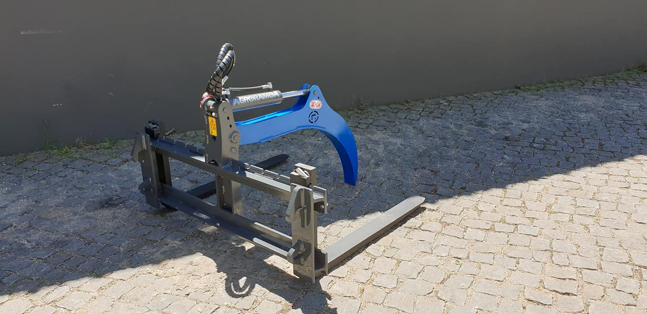

Does it come off other than the pins or is the bracket permanent?
I want mine to be able to come off because I still need to be able to use just the forks and frame.

You pull the pins to remove it but for most fork work, I leave it in the up position and it is mostly out of the way.

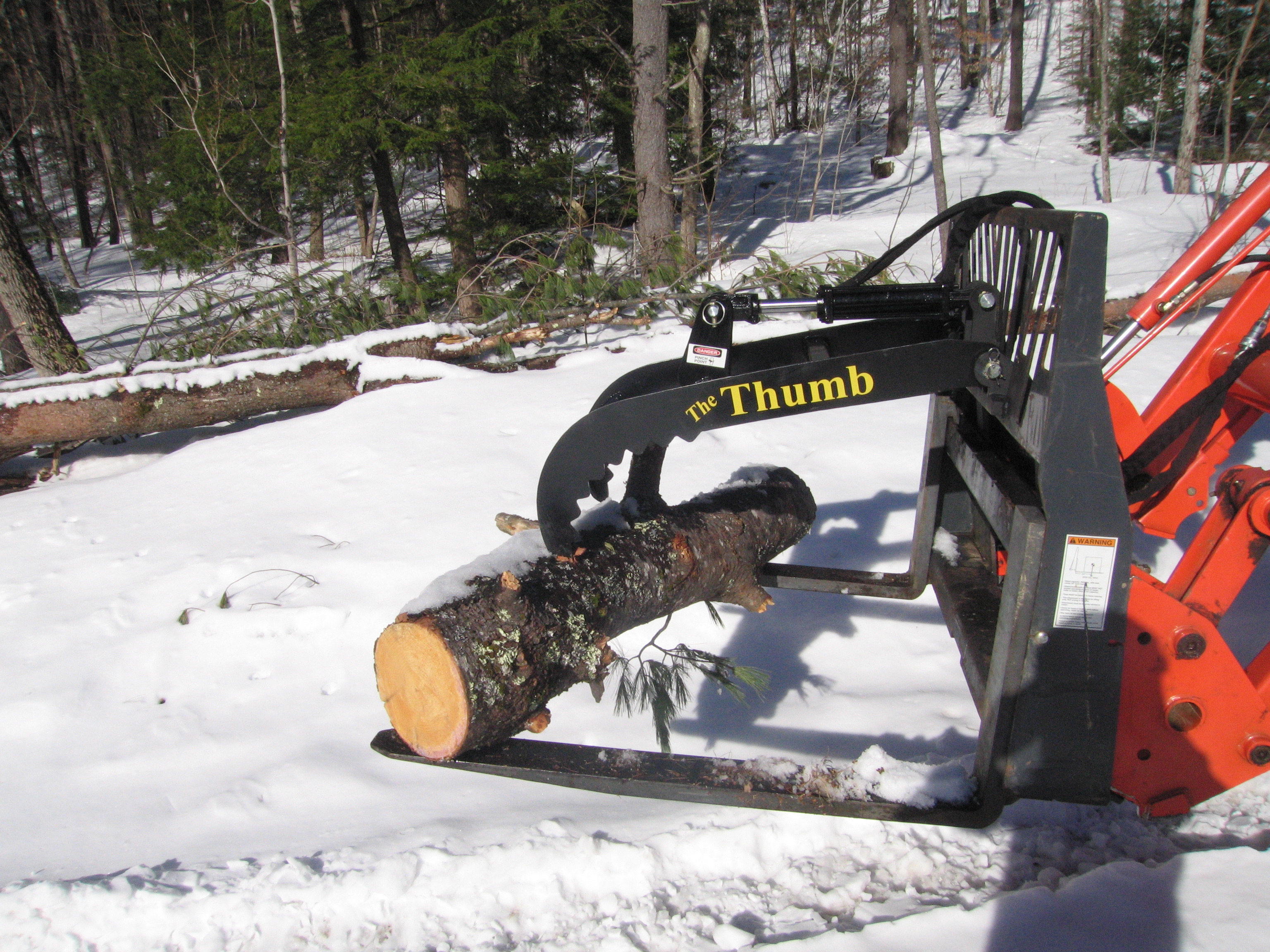

Similar to this?

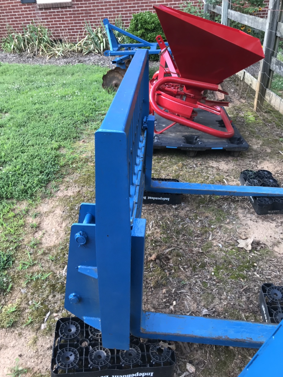

This is what I have to work with.
I want to be able to remove it out of the way when I don’t need it. Shouldn’t be to hard to do..........
