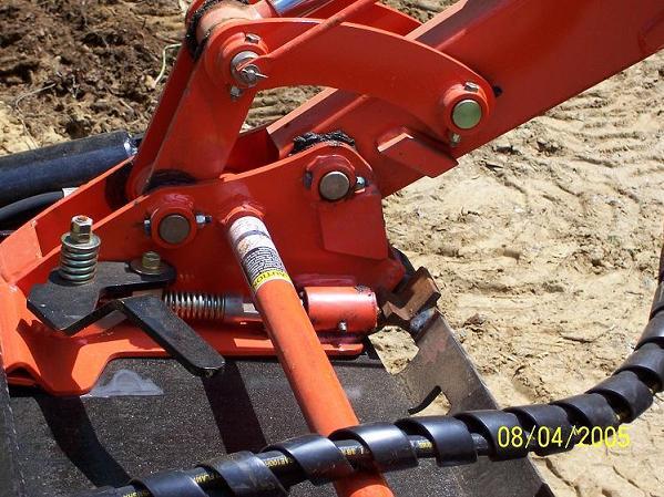

swiftboot:
Do a search for my post " ANBO Grapple on L-39".
I posted a similar issue. The solution was to weld on some 3/8" angle to the bottom where the loader pins attach.
As you have discovered, there is slop in the universal skid steer attachment plate.

Thanks for the response. The slop on mine is 9/16" when the grapple weight is on the lip part. I am going to try 1/2 " plate and see if that will stop the 'breakaway'. Also should stop the clatter and banging when running along without a load. Thanks again, chuck
