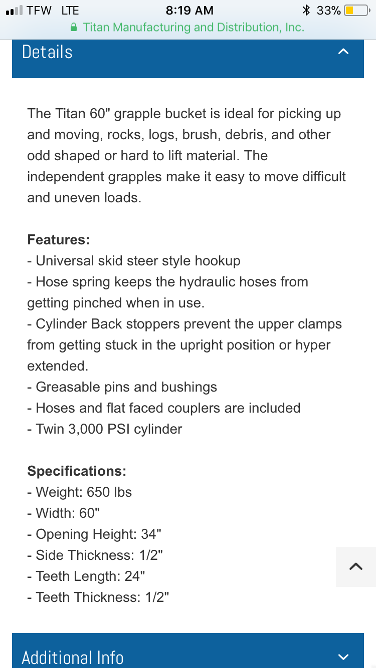

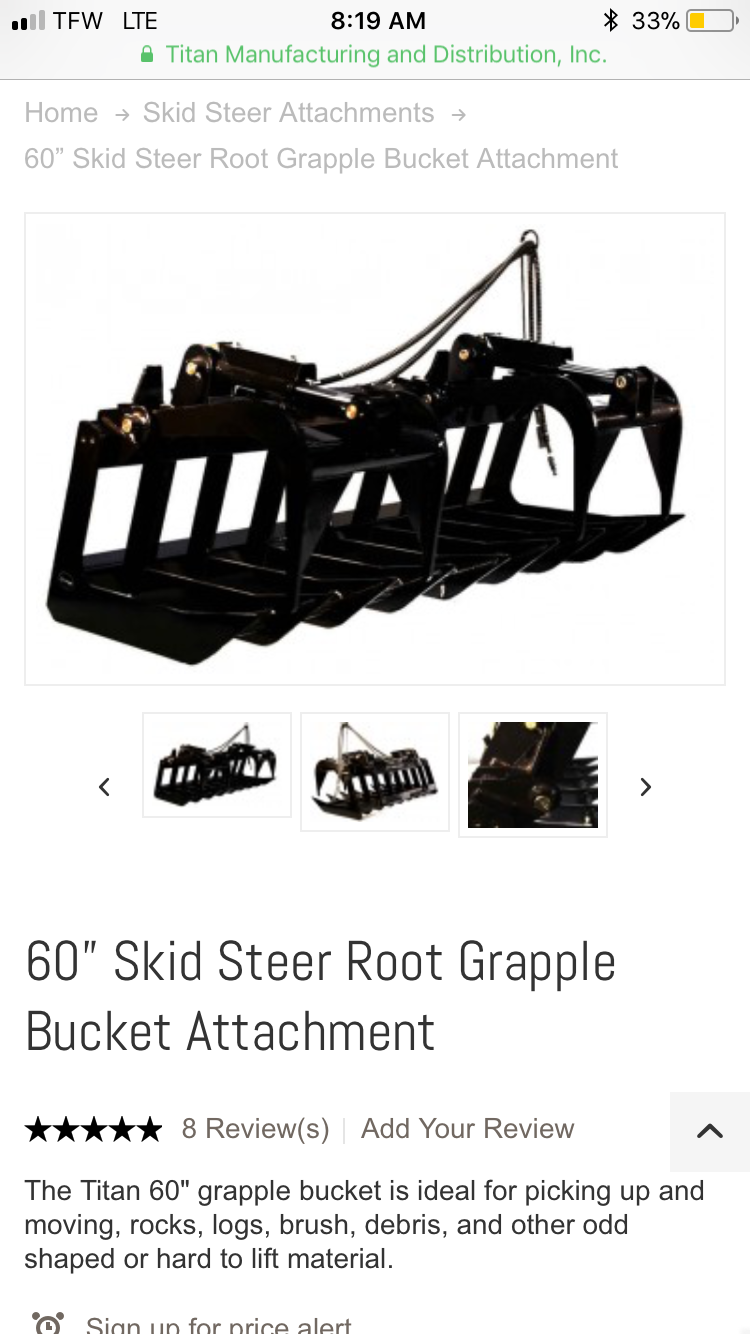

About to order a grapple bucket for my Case 1840 for moving brush and downed trees. Wanted to build one but I知 short on time and deep in projects. Was looking at the Titan 60? Looked pretty well build with 1/2 steel. Saw some bad reviews online but wasn稚 sure if that was from abuse and they didn稚 look the same as the one I知 looking at. What痴 your opinions? I壇 like to not spend more than $1500 if possible. B7CBD5CF-79DC-4E1D-8B90-2C8BBF7DA55A.png42563FD6-5FE1-4E75-82B7-59415BC54E5A.png

Case 1840 is a 50hp skid steer with about 1300 ROC, right? So, one thing to consider is weight. I didn't see it on the specs you posted, but on the titan attachments site, it listed it as being close to 650#. Also, opening is only 34 inches. Other than those concerns, it looks like a good strong grapple.

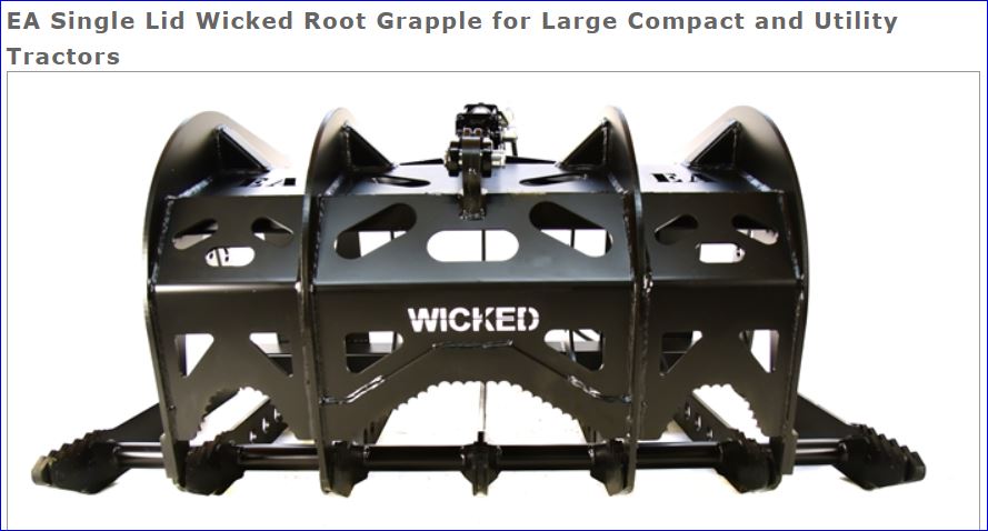

For complarisson, the EA wicked grapple uses 3/8th instead of 1/2 inch, so it is only ~350# and opens to 37 inches. (It is~$200 over your $1500 budget though - was just posting for reference).
I don't own either one... I'm shopping myself. Most frustrating thing for me is that the web sites don't list prices, so you have to contact them.
