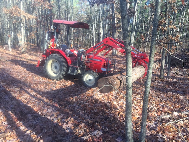

I have a set of the brush crushers and they do a good job handling logs as well as brush. Mine are mounted on a c-50 loader on a 2004 century 2535. You do not need a third function valve to operate them. The down side is that you do have to remove pins and manually install on each separate loader arm. I have found them to be a good cost effective alternative to a grapple. But there are jobs where a full third function grapple will be better. Here is a picture of my tractor handling a log in the woods. They are great for clearing brush. They do an amazing job of compressing the brush. IMG_0906.JPG. W Jones
