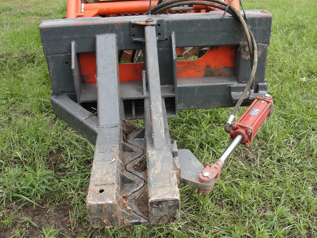

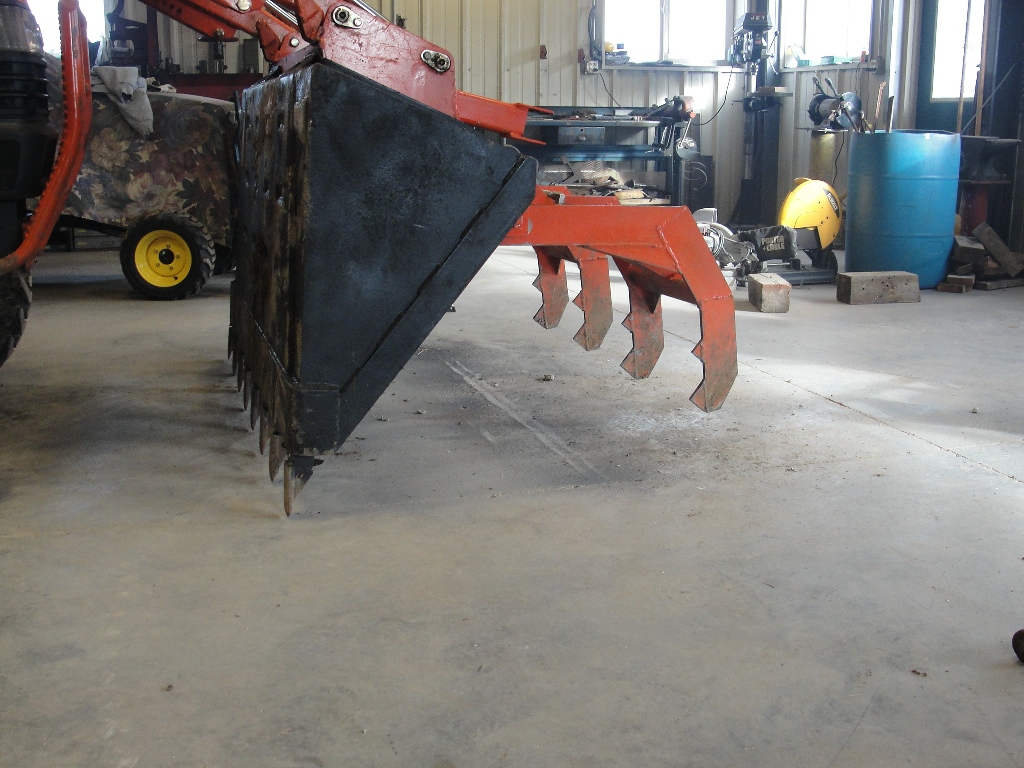

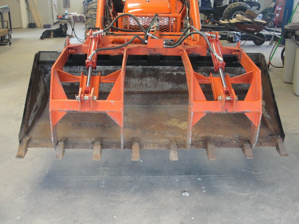

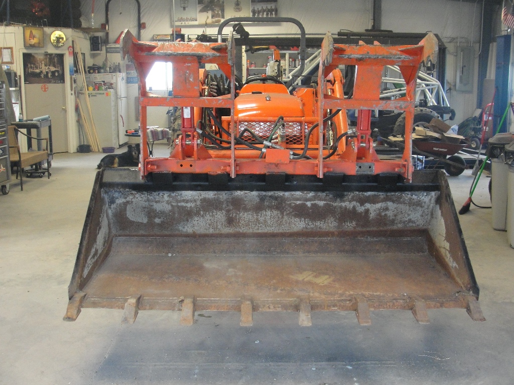

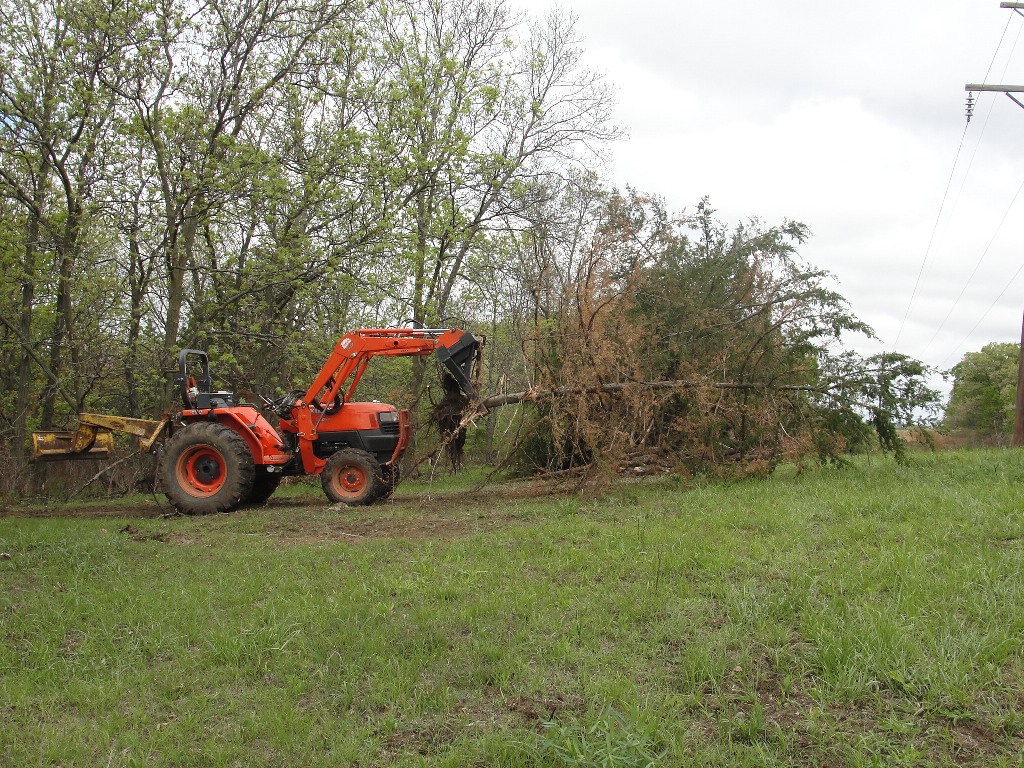

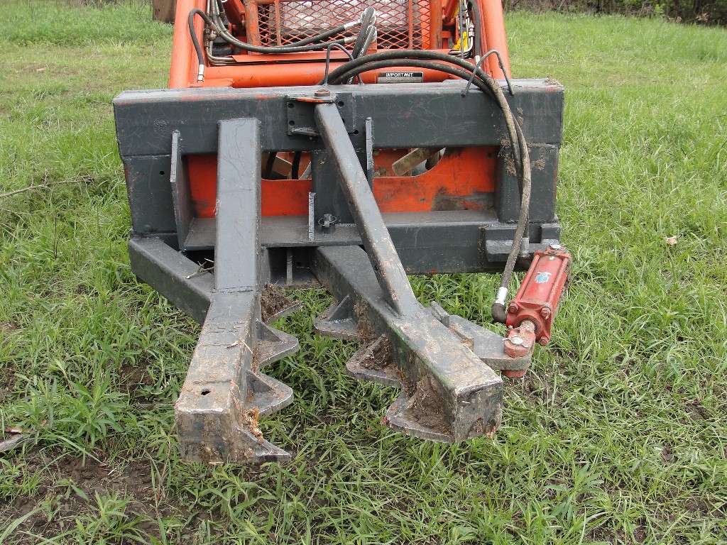

I built and added a Grapple to a Bobcat LowPro 60" bucket. I like it as mentioned above because I can carry small debris. I've moved a LOT of dirt with it as well. The bucket is "toothed" so I can use it to scrape up brush and debris into a pile, then pick it up with the Grapple. A Grapple will make a lazy man out of ya. I highly recommend it.
I built a tree spade. I rarely use it. Built it out of a 30" long piece of 24" 1/2" walled pipe. Cut the pipe square off on one end. Cut at a 45 degree angle on the other end to create a spade shape. I thought it would be handy for removing small shrubs/stumps. And it was handy until I built a tree/post puller. Now anything that's too big for me to pull with the puller is usually too big also to be dug out with the tree spade.
So, guess what I'm saying is, definitely get a Grapple of some sort. Then second attachment should be a tree/post puller. Then you'll totally become lazy. But you'll get a lot of work done!!! :)
   / Grapple and stump bucket recommendations for a Ford 4600 W/ 735 loader #7
<img src="http://www.tractorbynet.com/forums/attachment.php?attachmentid=418053"/><img src="http://www.tractorbynet.com/forums/attachment.php?attachmentid=418054"/><img src="http://www.tractorbynet.com/forums/attachment.php?attachmentid=418055"/>
<img src="http://www.tractorbynet.com/forums/attachment.php?attachmentid=418056"/><img src="http://www.tractorbynet.com/forums/attachment.php?attachmentid=418057"/><img src="http://www.tractorbynet.com/forums/attachment.php?attachmentid=418058"/>
Could you tell a little more about your tree puller. Was asking about tree puller on a different thread but saw this one. What type and size of trees is it capable of, thanks

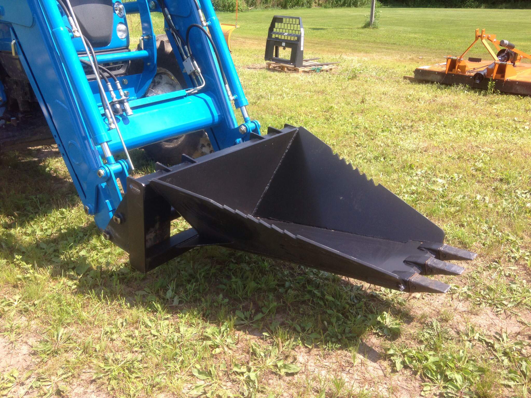

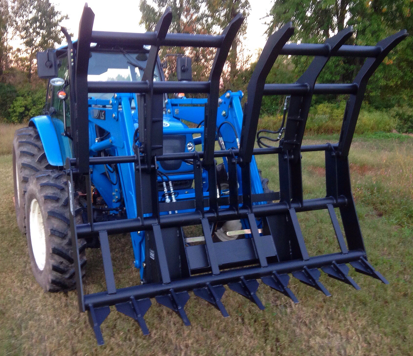

I have that RBG WR Long grapple in the dual lid version and like it a lot. It is a heavy duty grapple so make sure you have enough FEL lift to make it a viable option.
I also have a Titan stump bucket that works pretty well. If you search it you can find a video I did digging out a stump. Works better since I added a front camera and I can see the front of the bucket. It might be perfectly suited for the size trees you are wanting to remove.
Deerherd, I found the video and that was great. What HP is your tractor? It looks about the same size as mine, just a lot newer and a 4x4. Have you had any issues at all with the Titan stump bucket? I read somewhere that the Titan products were made in China with low quality steel. I'm not sure of the truth in that, and thought I'd ask. Most of the stumps I am looking at are in the 10 to 14 inch range, with a few bigger. Mix of hardwood (oak, poplar, hickory) and pine. They have rotted back some, or I wouldn't even consider a FEL to try and get them out.
