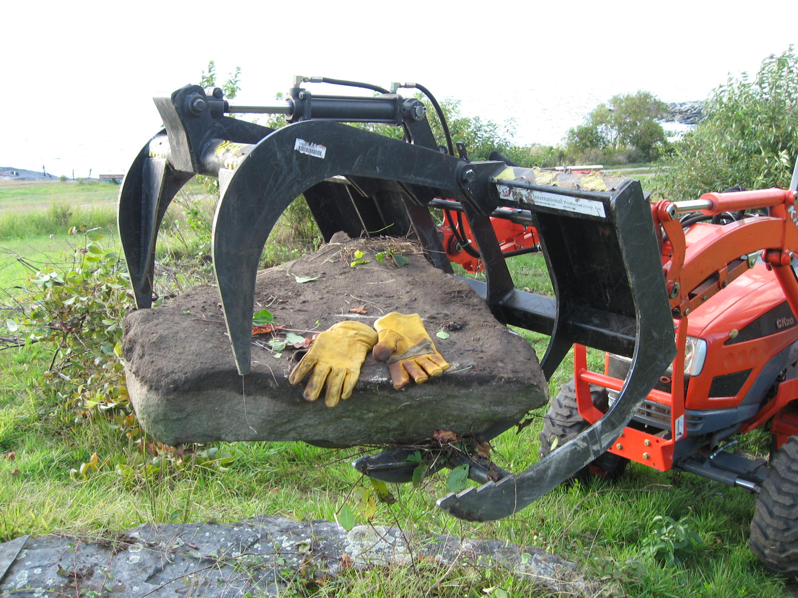

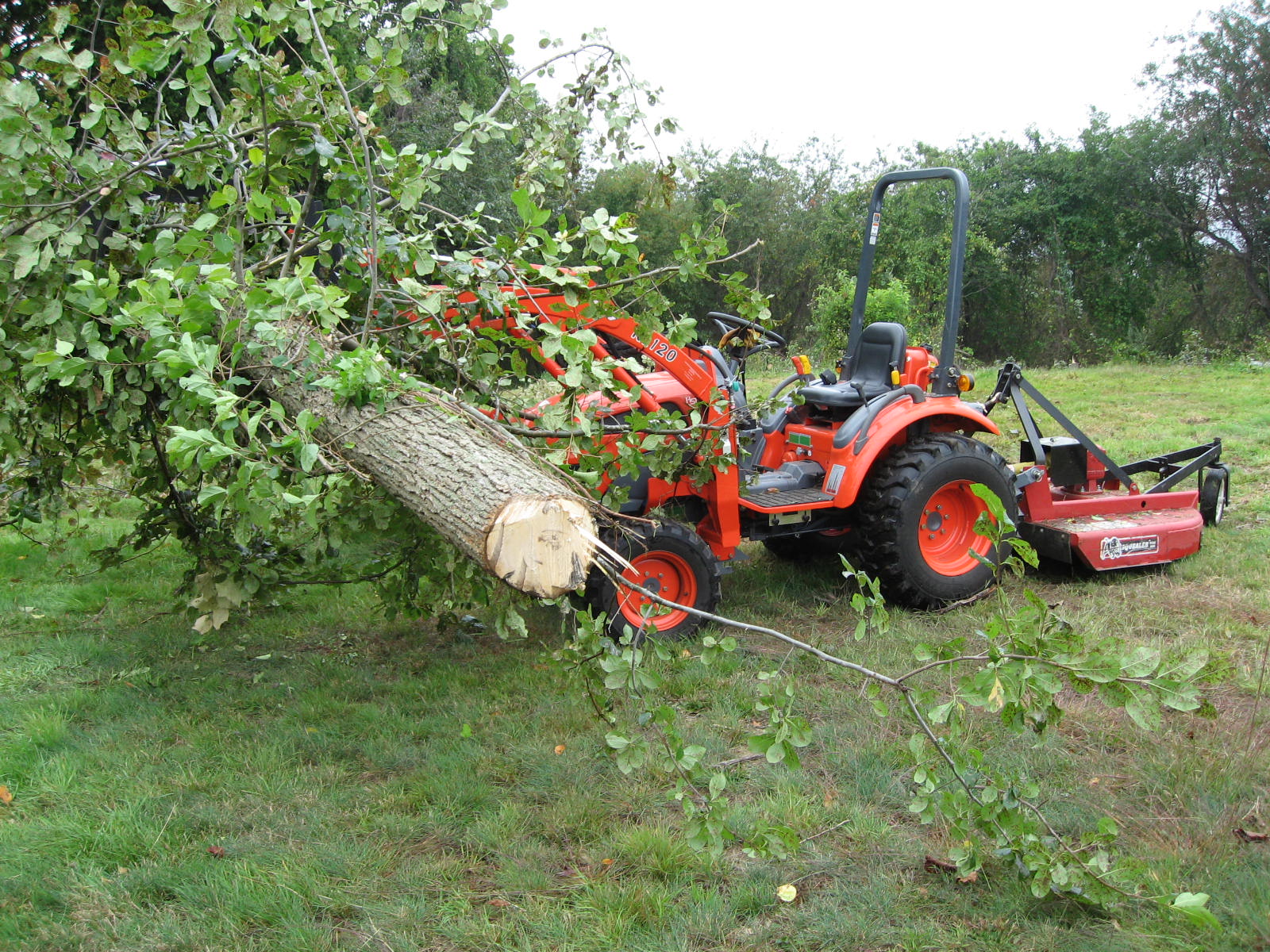

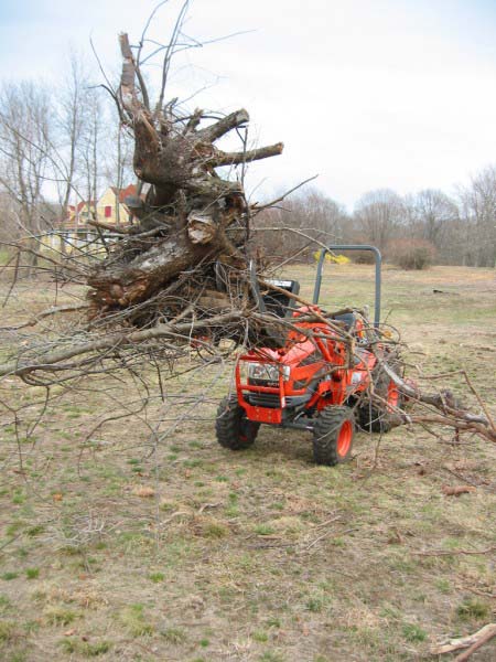

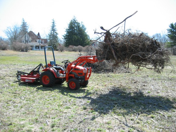

I have a single jaw on a 48" root grapple and am perfectly happy with it. There is nothing I have not been able to pick up and I cannot figure out what shape would require two arms to hold. I'd also say that I can pick up enough "stuff" with the 48" grapple to overload my FEL which can lift 1070lbs at pivot pins to full height. I can pick up enough stuff that there is no way I can see where I am going except by lifting the grapple higher and looking underneath it periodically. I would imagine a 48" grapple is all most CUTs really need. Of course there is brush/tree/stump hanging over the sides sometimes but the point is that material is captured and held securely. My point is that you don't need a grapple width identical to your FEL bucket width and for most uses 48" is all you need. If you can do the job with a grapple that costs about $650, why spend more?

All good thoughts. The only reason I can think to get wider is when I am using it to clear trails. It would be the width of the trail and one pass in most cases would do it rather than backing up and getting the other side. But as far a clean up, good point and why eat up the extra weight in grapple rather than brush.
