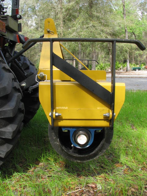

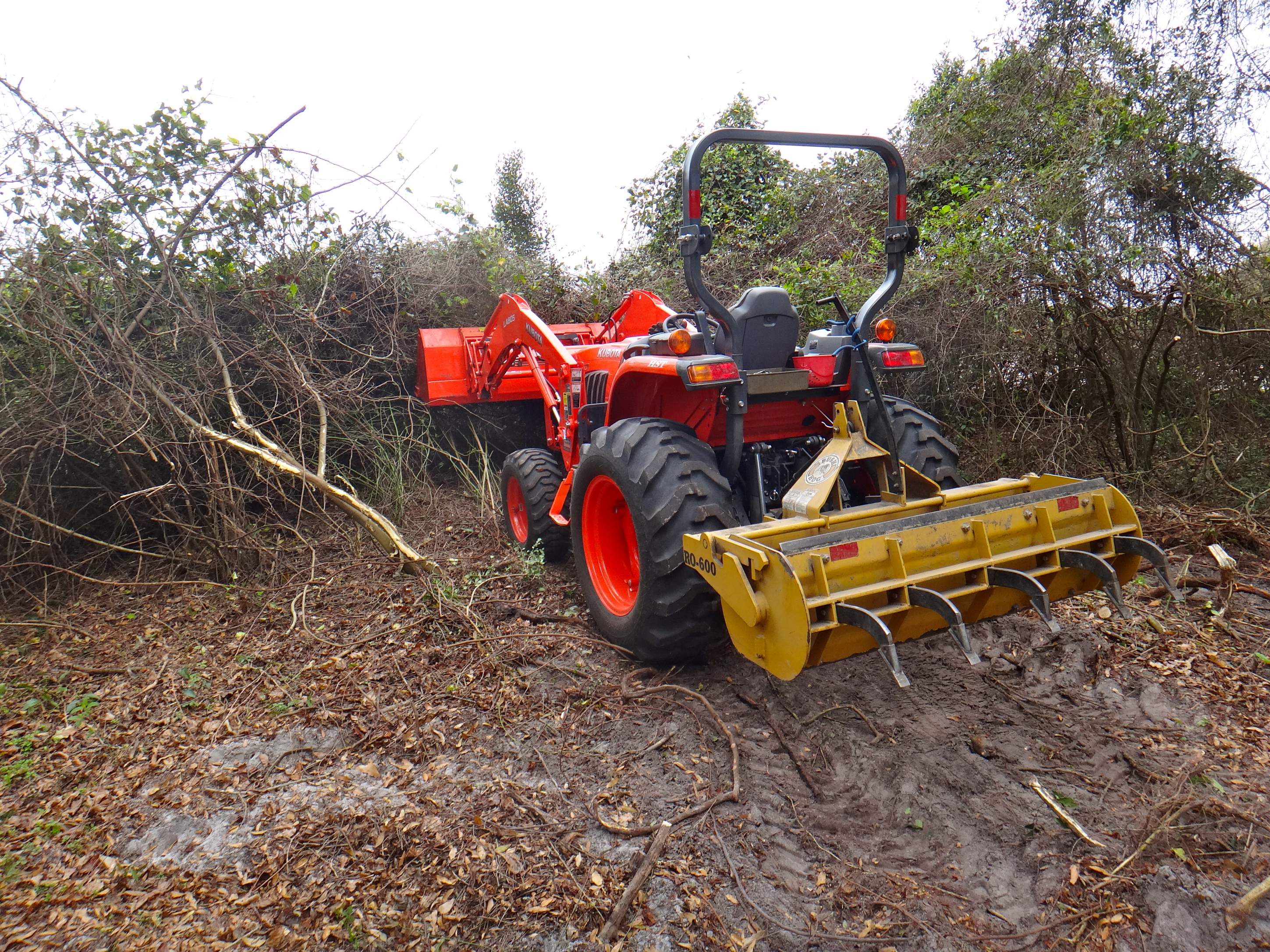

I have had air in the rear Industrial Tires on all three of my tractors as I run over people's lawns regularly. With air in the rear tires, rather than liquid, I need to mount a counter-balancing implement on the Three Point Hitch before I accomplish near-max lifts (Photo #2, #3), otherwise the rear end lifts, instead of the FEL load. With moderate lifts, including a full bucket of Florida sandy-loam, rear ballast is not absolutely necessary but rear ballast takes strain off the front axle and front bearings. Quite often I use an ETA Cultipacker as ballast (Photo #1). It is heavy and compact. Other times I utilize a Bush Hog (brand) Rollover Box Blade (Photos #2,#3,#4).
