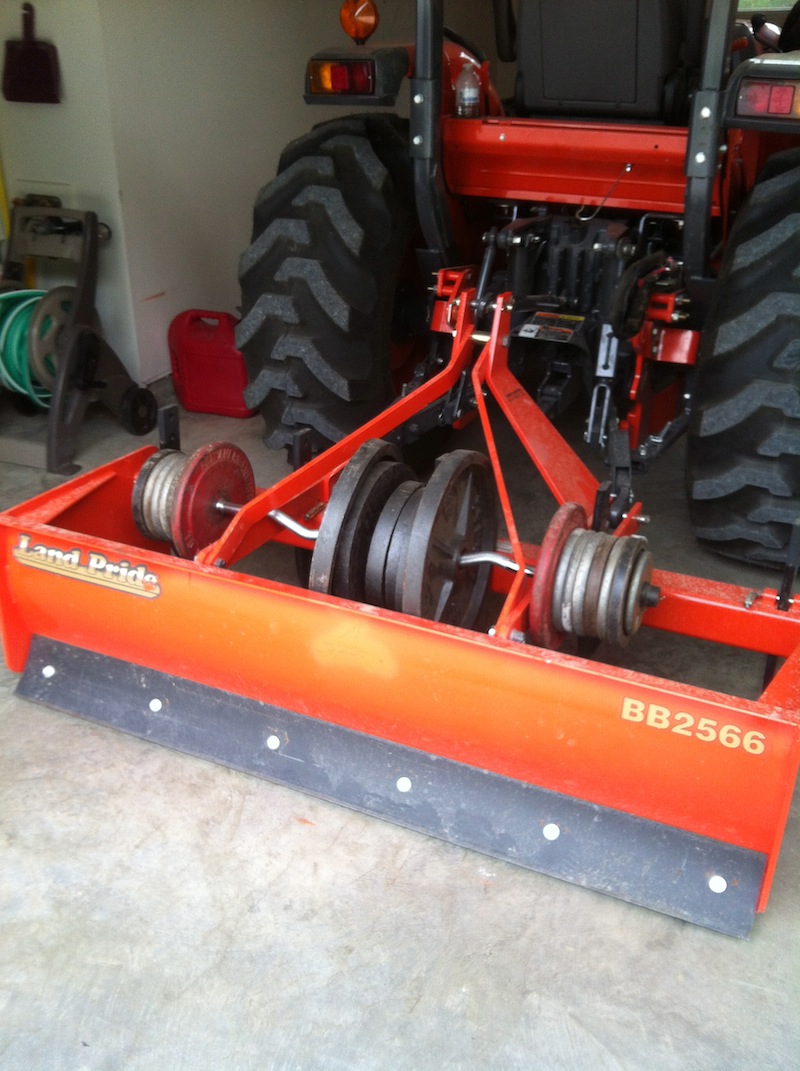

I have a 55 gallon drum full of cement that's on the back of the tractor whenever I don't have an attachment on the rear. If I don't and go down my driveway in 2wd the rear brakes will lock up and skid very easily. I haven't gotten around to loading the rear tires yet.
Loader is a lot of weight on the front of a tractor, even empty. Some folks use 4wd to compensate but that'll wear out the front-end, or break something. You are doin it right.:thumbsup:
