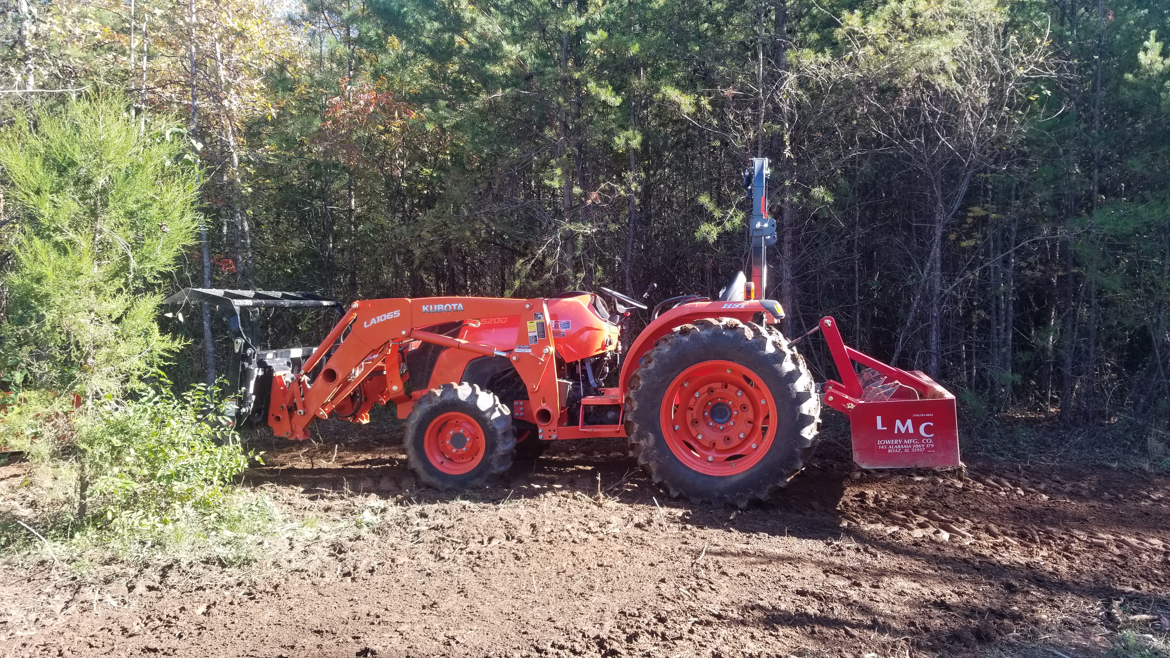

I tried all of the bells and whistles model grand L's and I'm really glad I went with an mx5200. The throttle thing has been a non issue. If I need more throttle, I just push the throttle lever. I'm very happy to have a bare bones macho utility tractor. I do wish the front wheels were even bigger than they are though. That is the one thing that I'd change about it.
As far as price, I just wasn't seeing a reason to get a knock off tractor, (just kidding), the price difference was minimal. 1-2k at most. I'd rather have the better resale than save a little at purchase time.
Another thing, all this talk about ag vs industrial tires might mislead a noob when looking for a tractor. I'm really glad I thought long and hard about tire choice. Ag tires are the only way to go if you'll be using a tractor on dirt in all conditions and hilly terrain.
YMMV

You want a bigger tire than the 12.5? I really like the stance of the MX series. I know LS puts the 12.5 on the majority of their XR series but I have read quite a bit of bad stuff about LS.
   / Grand L 5460 vs MX5400 #10
7.5-15 is what mine has.
Yeah. Every time I have a big load on the bucket and see the tire squeeze down and roll it makes me want bigger fronts. I like the size of the tires and wheels on the 5660su, but that tractor doesn't come with a hst.
They seem small.
