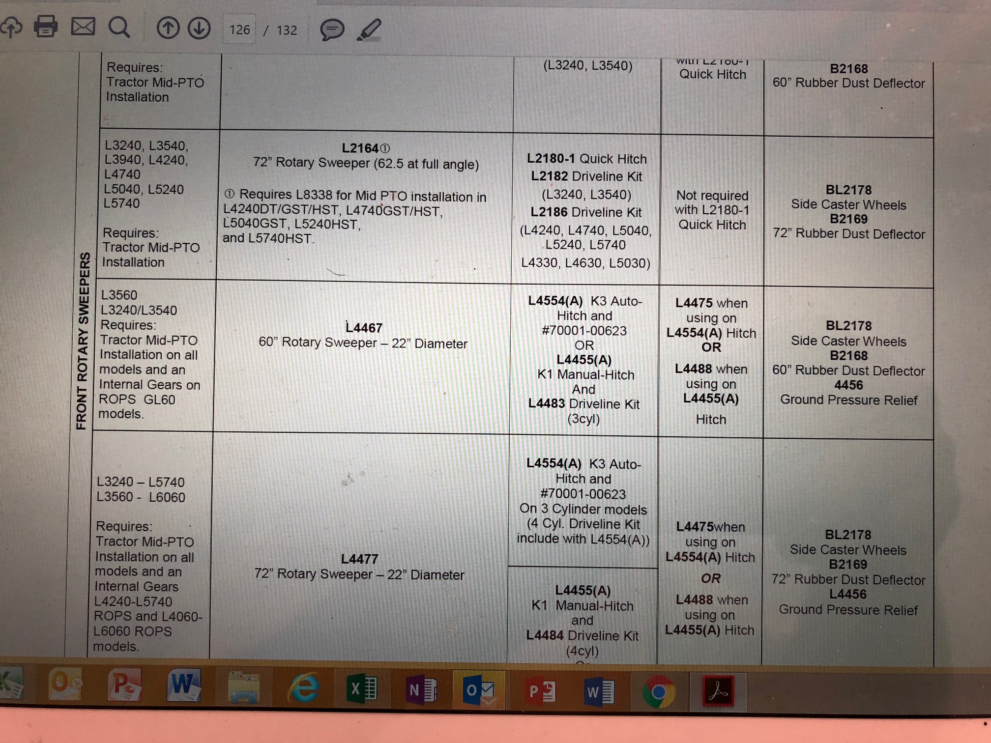

Anyone have any clues on the front rotary broom for the -40 series? And a rough price? I'm not having much luck finding info on it. For giggles, I priced out a broom for a new -60 series and it looked like $7k+ from the "build your own" Kubota website. That's nutz!

There are two options depending on which style quick hitch you want to use on your tractor. The older front quick hitch L2180-1 may not be available from the dealer, but can be found used. This quick hitch is the "duckbill" design.
The newer quick hitch (4-pt?) and sweeper is available from the dealer.
L4477 Sweeper: $4,566
L4554A Quick Hitch Manual: $2,000
L4554A Quick Hitch Auto: $7,995
L4484 Driveline Kit: $747
This info could be superseded by now, so it is only provided as reference.
Maybe this photo will be of value to you.
