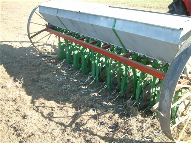

Don't know what your budget is, but if you're looking for a conventional drill, be sure to get one with grass seeder boxes to handle small seeds. Here's my restored Minneapolis Moline P3-6 drill (10-ft wide, 20 drops, single disk openers). I'm pulling it with the 2008 Mahindra 5525 (54 hp engine, 45 hp pto) which is overkill and am planting Kanota oats using the big fertilizer box to feed these large size seeds.

I use drag chains to cover the seed.
