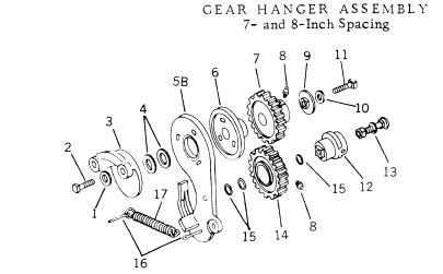

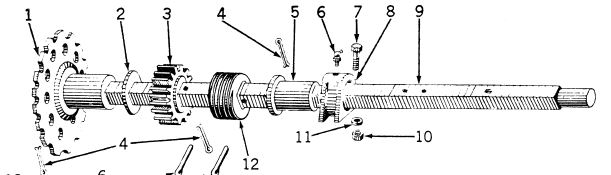

Im not sure if this is the right place but i have a question. I just picked up an old Dohn Deere Model B Grain Drill. 8' 14 X 7. Not sure what 14 X 7 means but it seems to be in good condition but the gear (cog) on the right side that is on the end of a square tube that seems to be the main drive for the other gears. I hope i havent confused anyone. Anyway, it has worn or broken teeth on it and I cant seen to find anywhere to look for this and is there a way to get that off without a complete tear down? Any ideas from the pros?

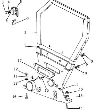

Yes 3vO has it correct 14 seed openings spaced 7" apart. To replace the gear in question(parts key #3 2nd photo) one has to remove the grain box end cap plus the cast iron support in 1st photo. I remember back when I worked fior a JD dealer and had to assemble those model drills. Oh for the "good ole days". The gears in the 3rd photo have a hitory of wearing out with a lot of use also.Parts key #3 H209M 18T GP DRV GEAR ON JACKSHAFT ADD 74.15 USD
