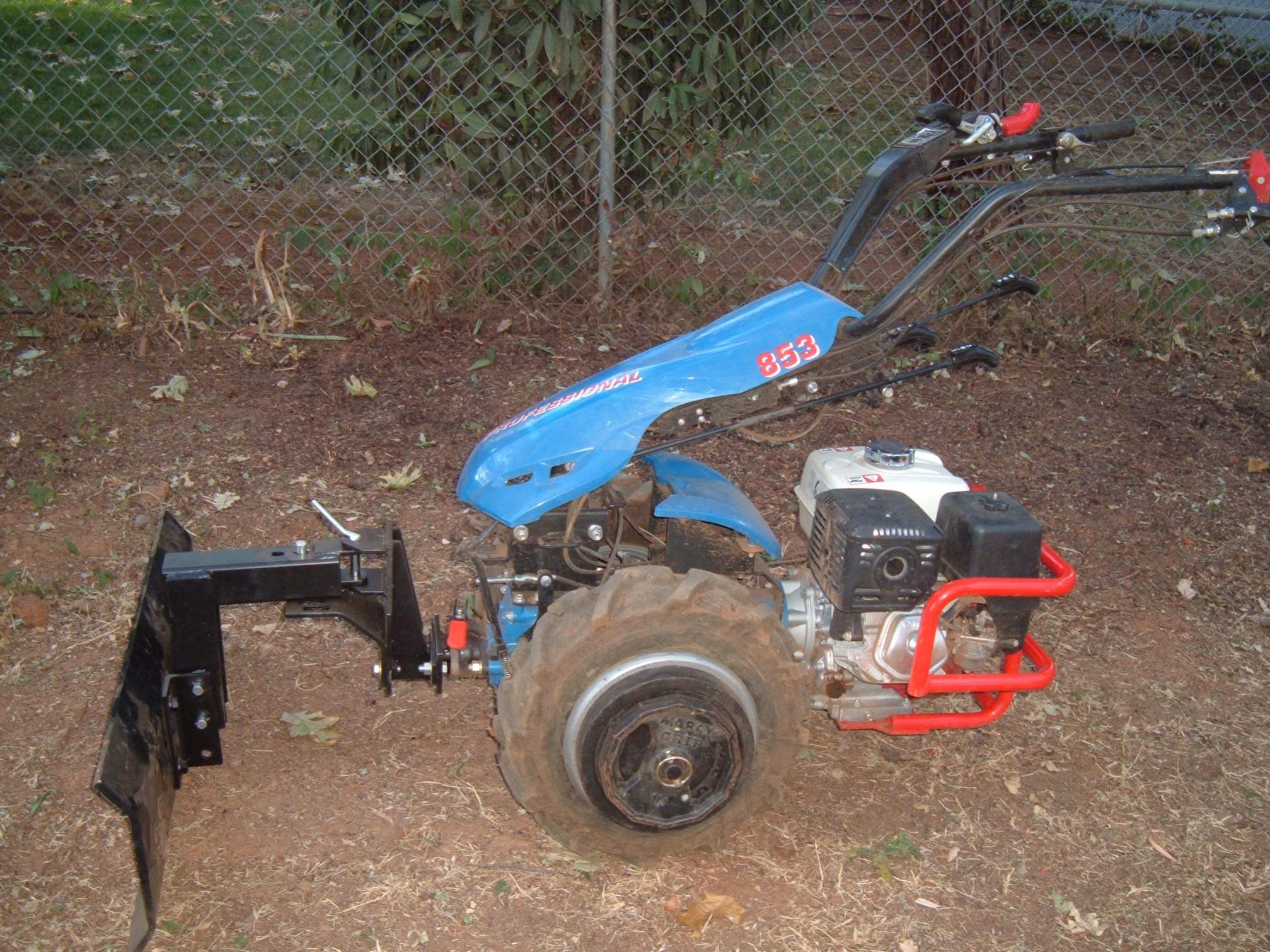

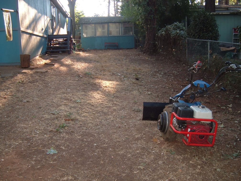

Did some grading work and promised a picture or two! Here you are.
It was difficult work, to say the least. I could only fit 60lbs of weight on the barbell hangers from Earth Tools that I purchased (9" I think). I ended up having to do some tilling to loosen the high side soil, but in the end I did accomplish satisfactory results. The 36" scraper/dozer works much better in the "pull" position.
Cheers!!
Here's a shot of the 853 in all her glory, with the blade in dozer position.

Nice job and thanks for the pics. I think the dozer blade doesn't get the love it deserves.

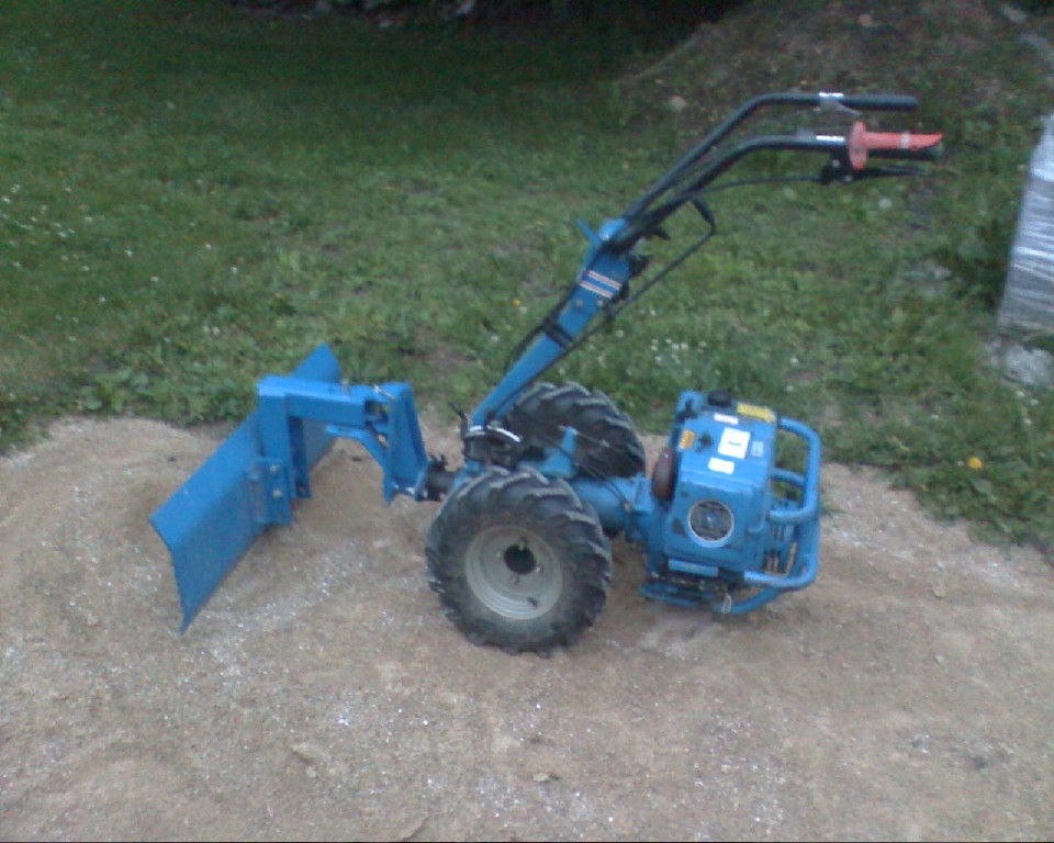

I used to have a dozer blade and found it to be a nice little unit for light pushing duties. Since I'm in a "bit" cooler runnings, most of it's work was pushing snow. The video shows me pushing with an 850 before I mounted a diesel and w/o weights or chains. You'll also see I modified a 60 inch snow blade to mount to the front of it. Considering the lack of weight and chains, I think it did a fair job for the depth of snow.

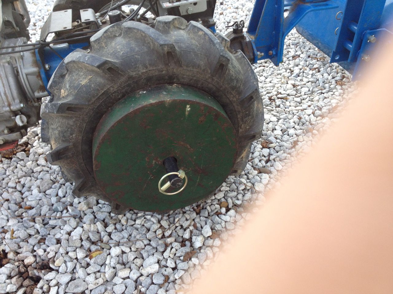

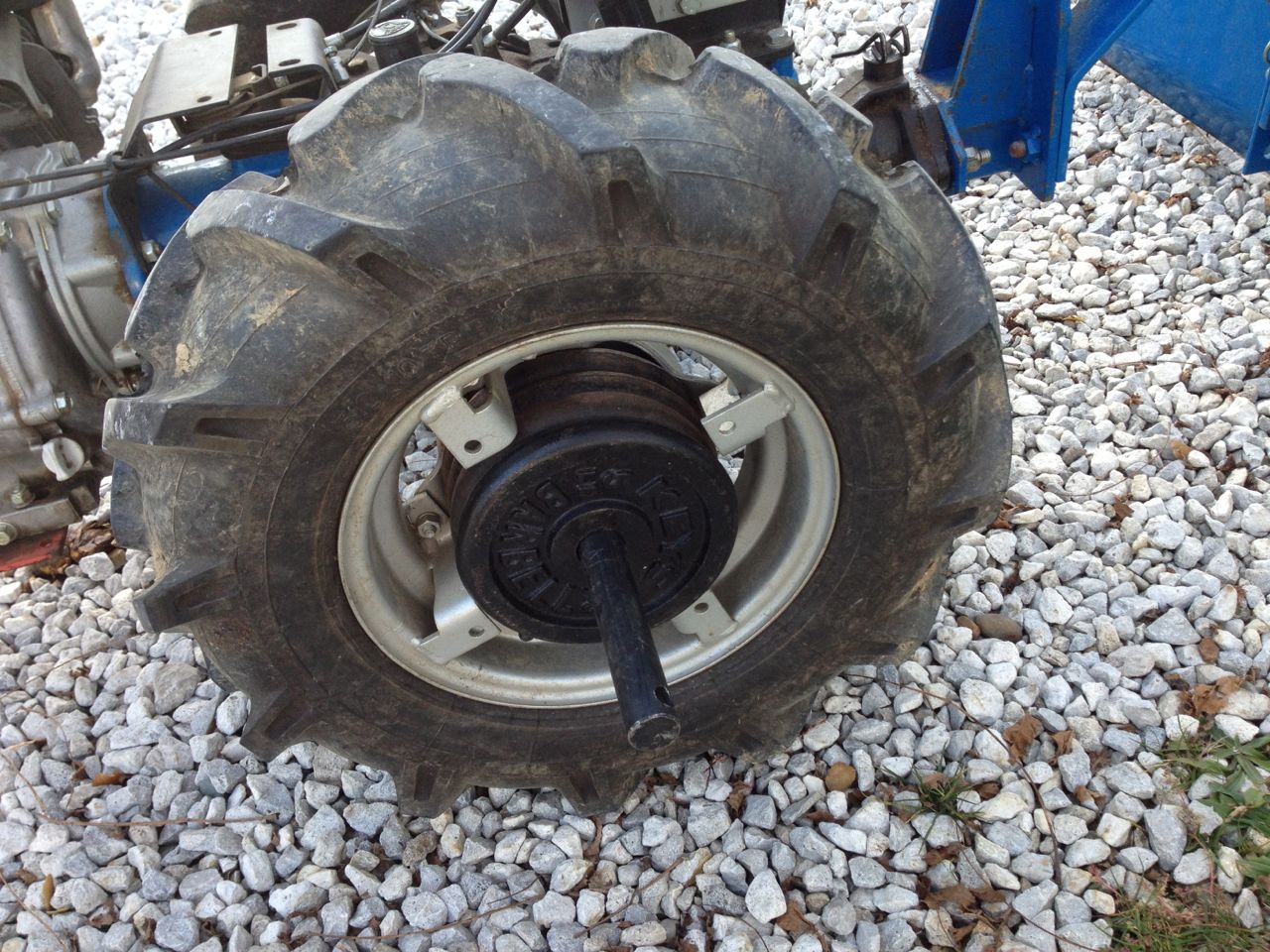

With the weight brackets - did you start with smaller weights on the inside? I have 9 inch brackets and start out with a couple 2.5 lbs, a couple 5 lbs, and a 10 lb before I get to the bigger weights. I also got VERY lucky and found 2 50 pound 1 inch weights. If I got them all on, I can easily achieve over 100 lbs a side. When finding weights, you want the smallest, skinniest weights. The ones with the hand-holds (like your last one in the pic) just take up extra space.
Here's a pic of it getting used to level out gravel fines for a paver patio -

Good job PGC!
Sure beats doing it by hand huh?
I tried, but even my 2.5lb weights were too large in diameter to fit "inside"the rims....but they are those ones with the little hand holds also. I just used what I had from my weight bench, but I can see your point...the silver ones are skinnier.
Heck yes RD - much easier than doing it by hand. Made some good money from that job too!! :D

I went looking for weights at Wal-mart and the local sporting goods stores. Besides the fact that the weight cost around a buck a pound, which is more than I want to pay for wheel weights, they were all of the hand-holds type. Which as mentioned makes them thicker than they need to be.
I finally found something that suited me well from a guy on Craigslist. He had tons of weights. And he had some perfect ones for my application, some 77-pounders, that were used for some kind of fitness machine. In the pics I posted you can see I fit 4 5-pounders inside the wheel and the 77-pounder outside of that, for a total of almost 100 pounds per wheel. Since I still have some room left on the hanger, I think I will just add some pvc pipe there to keep the weights from sliding around.

Nice rig man. Gotta love em. I'll be looking for some of those smaller weights to fit inside the rims like that. Thanks for the pics.
My tips would be to most certainly bring your tiller box because if you need to actually re-shape any surface (as opposed to move loose material) the blade just doesn't cut into the earth with much force. You can scrape maybe 1/4" - 1/2" at a time from hard ground (here we have red lava soil that is super hard). Also, using it in the pull position was much more affective than dozing. You'll probably do better than I did with that much weight on the tires, but be ready to do some hard work. Also, larger tires, if possible, will improve ground clearance and help keep debris out of your engine.
