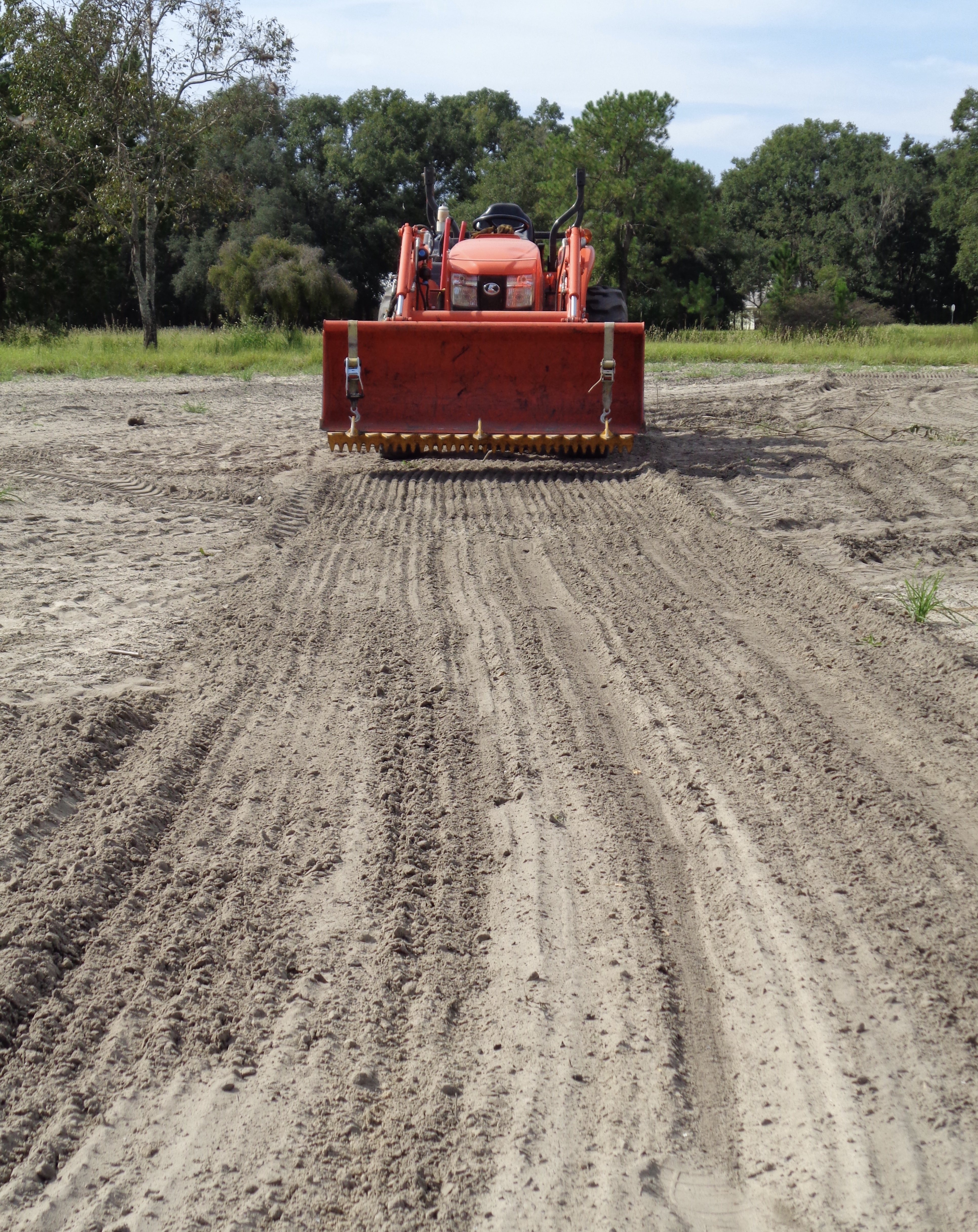

Hi All,
I'm looking at buying a tractor for my 5 acres filled with live oaks soon. i plan to do quite a bit of grading, for a short period of time such as: 45x35 pad for steel building, grading out a gravel driveway too the building, and just general leveling of other areas around my property. I plan to get a box scraper with my purchase.
I am looking at a Kubota B2650, as that seems to be the best bang for my buck for my brush hogging, grapple for brush moving/log lifting, light backhoe jobs/stump removal. (27K+ by build price new)
However, id RATHER buy a one machine (making payments anyway) so i dont have to go rent bobcats/excavators/pay to have it done, ect. Is that B2650 going to have enough weight in the tractor for grading or am i going to be better served by going with a l3900 (2590 to 2778)/grand L 3650 (3483 to 3880). Of course the lift weight will be better with bigger machines, but i don't think that is something that I will really be limited by with the 2650 (1664 to 2238 lbs)
Thanks for any advice anyone might have.
   / Grading - How important is weight of the tractor? #2
Your dirt and moisture in your dirt when you want to grade will significantly affect how rapidly you can accomplish each grading task.
If soil is not dry and hard a B2650 will do fine.

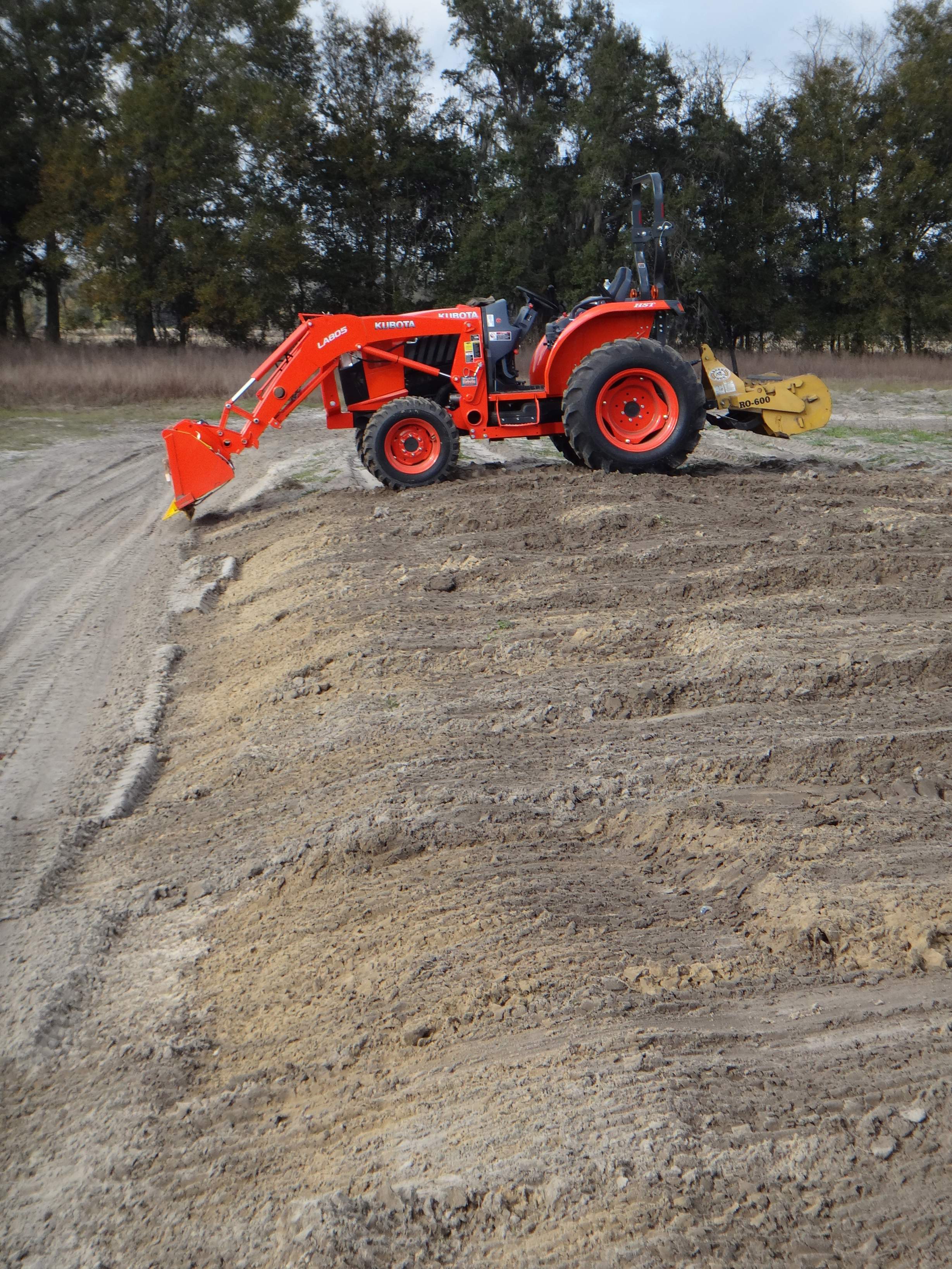

You will probably want a 60" wide Box Blade as heavy per foot of width as the budget allows. Weight is key cutting and moving soil with a Box Blade. A heavy Box Blade makes excellent counterbalance to heavy FEL lifts.

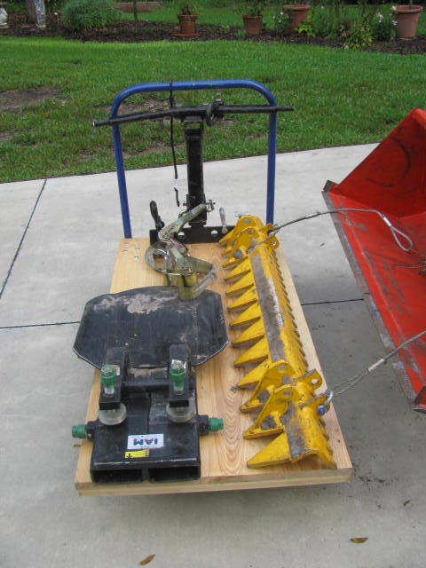

When I grade with my L3560 I almost always have a Ratchet Rake bucket attachment strapped to the FEL bucket when my Rollover Box Blade is mounted on the Three Point Hitch.
Forget digging out Live Oak stumps with a B2650 Backhoe. Hire stump removal out to an excavator or bulldozer.

Thanks for the response. From a time perspective i can do it when its optimal, this isn't a pressing issue.
I have 40+ stumps (most are small) on my 5, and cut down 2/3 trees that fall so far each year I've been here (5 years). I really just want to dig them out as i tire of hitting them with the brush hog. I don't have the $$ to hire it out :(
Do you think the l3650 with the 9ft hoe would fare better.
   / Grading - How important is weight of the tractor? #4
YES. But an L3560 is lot more money for five acres.
An L3560 will not fit in a garage with a standard 84" header, even with the ROPS folded.
Backhoe is a $8,000 option.
What use do you forecast for the Backhoe after your forty stumps are removed?

The importance of tractor weight - in my case MAJOR. I have a mile long driveway. It's a combination of gravel, sand, silt & volcanic ash. It "sets up" in the summer - just like concrete. For 27 years I tried to grade my driveway in the summer. I had a Ford 1700 4WD. It just would not do the job and the very short time when the driveway moisture level was correct - just too short.
I finally gave up. Bought a brand new 2009 Kubota M6040. I've "bulked it up" - with attachments it now weighs - 10,100 pounds. Land Pride grapple @ 820# - 1500# of RimGuard in the rear tires - Rhino 950 rear blade @ 1050#.
With the FitRite hydraulic top link - blading the driveway any time in the summer is now easily accomplished.
Plus now I can easily tackle the larger projects on the property.
