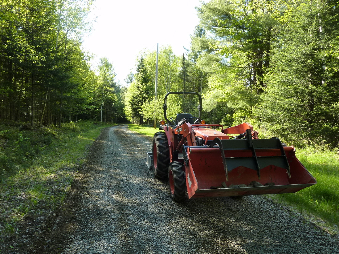

I agree with jenkinsph. I would say anywhere you can use your blade you can use a land plane. But, if you have a lot of baseball size rock the land plane (or blade) will rip it up. Generally you don't want to rip up the structural road base. It should be covered with a road surface material. If it is just a rock here and there you will have to pick it out and throw it aside or in the bucket.
This is a dirt road I have mixed stone into you can see the size rocks I pick out in the bucket.

That is some beautiful property you have there! Thanks for the info. I do indeed have some softball-sized rocks on the road (put in before we bought the place). I think I'll add in some road base rock and then work that and leave the larger rock underneath as a base. Sounds like I may not have much choice. :laughing: Thanks for your help!
