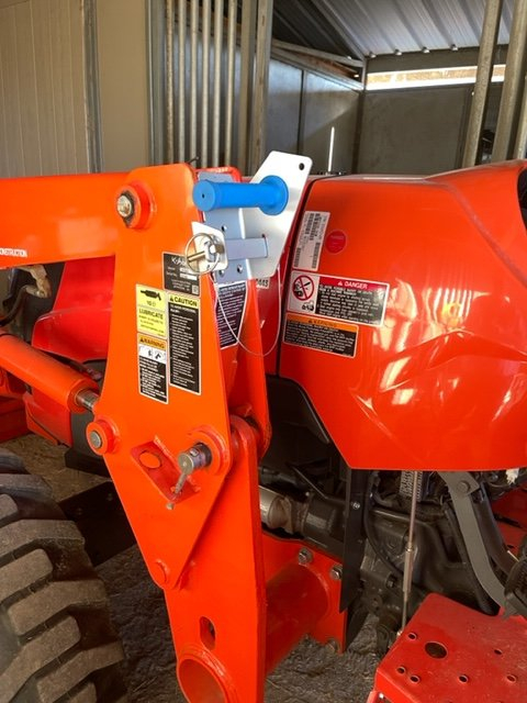

I previously had added a chainsaw holder that sorta doubles a grab handle when getting on/off the tractor

I got a cabinet handle, drilled and tapped a support plate on the back side of the FEL (facing the seat) and mounted it there.
I do have grab handles on the fenders which are good while you're in the seat, but needed one near the step for access & egress.
