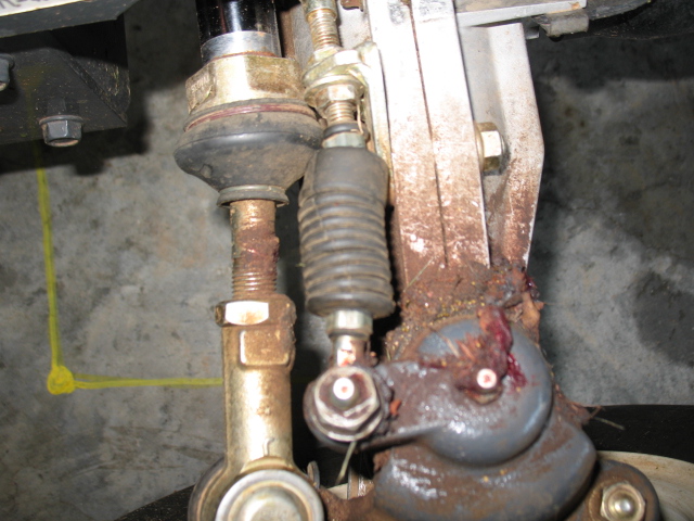

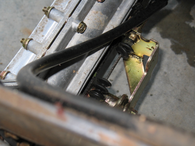

Got a question for GR2100 owners or Kubota mechanics. Have you ever replaced one of the cables (K1253-41754) that operates the Glide Steer mechanism? This is the second time I have had one break since I purchased my GR2100 new 7/2005. I had the dealer replace it the first time, now I am thinking of performing the replacement myself. From looking it over after I removed the mower deck it looks like something I could tackle. However, the question of adjusting it properly looms overhead. Any assistance would be appreciated.

There was a change in the mounting brackets at some point.Do you know if yours has the new ones? Might check on that before you replace the cable.
Take a pic or make a mental note where the two adjusting nuts are tightened down on the old cable(both ends),before you remove it.
   / GR2100 Glide Steer cable replacement
Locknut, I have a feeling I do not have the revised mounting brackets since this was the second cable failure. I will ask the dealer about the change in mounting brackets in the morning. Here are a couple of pictures I took this afternoon. Maybe someone can tell if these are the old or new.
