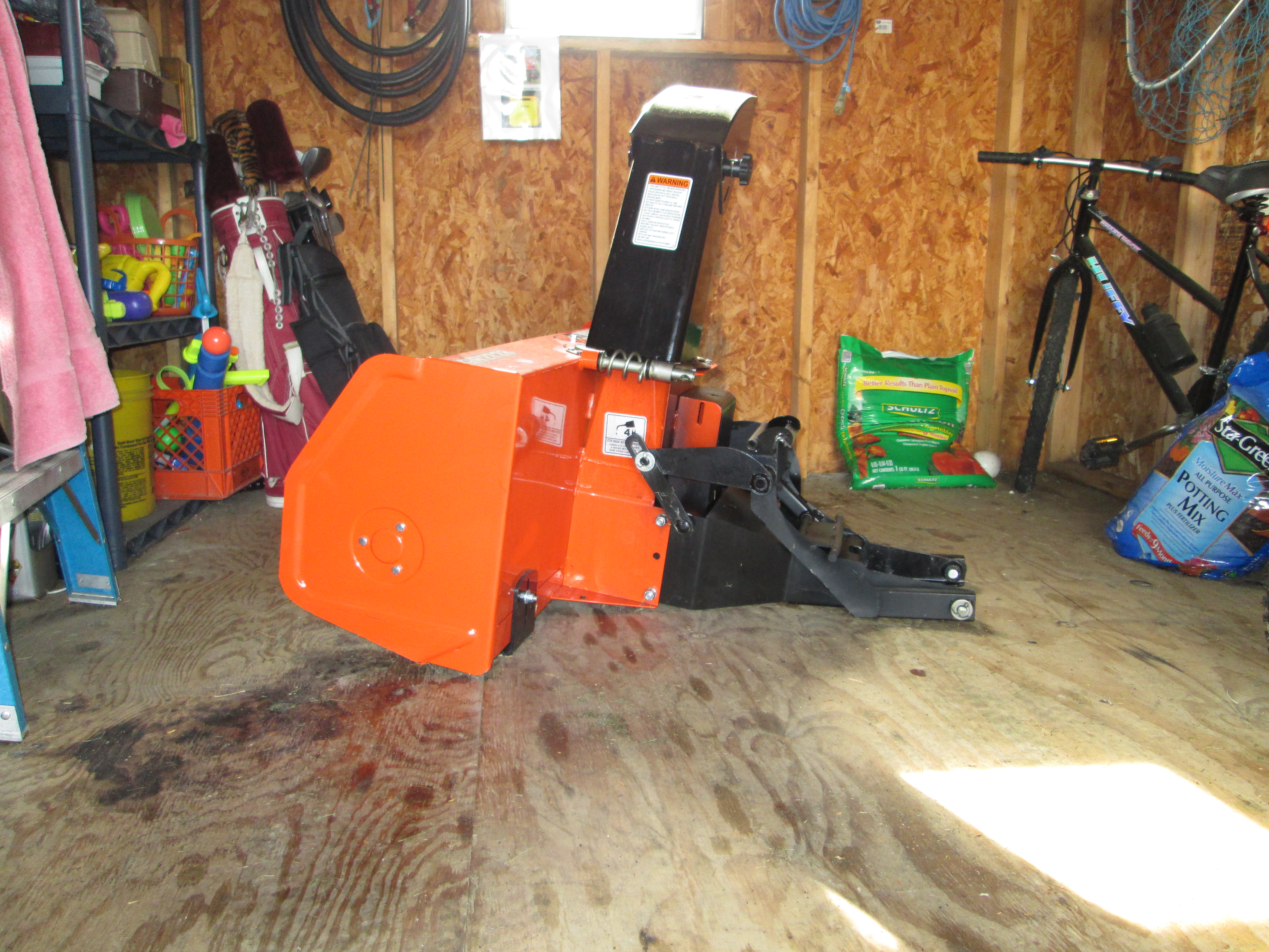

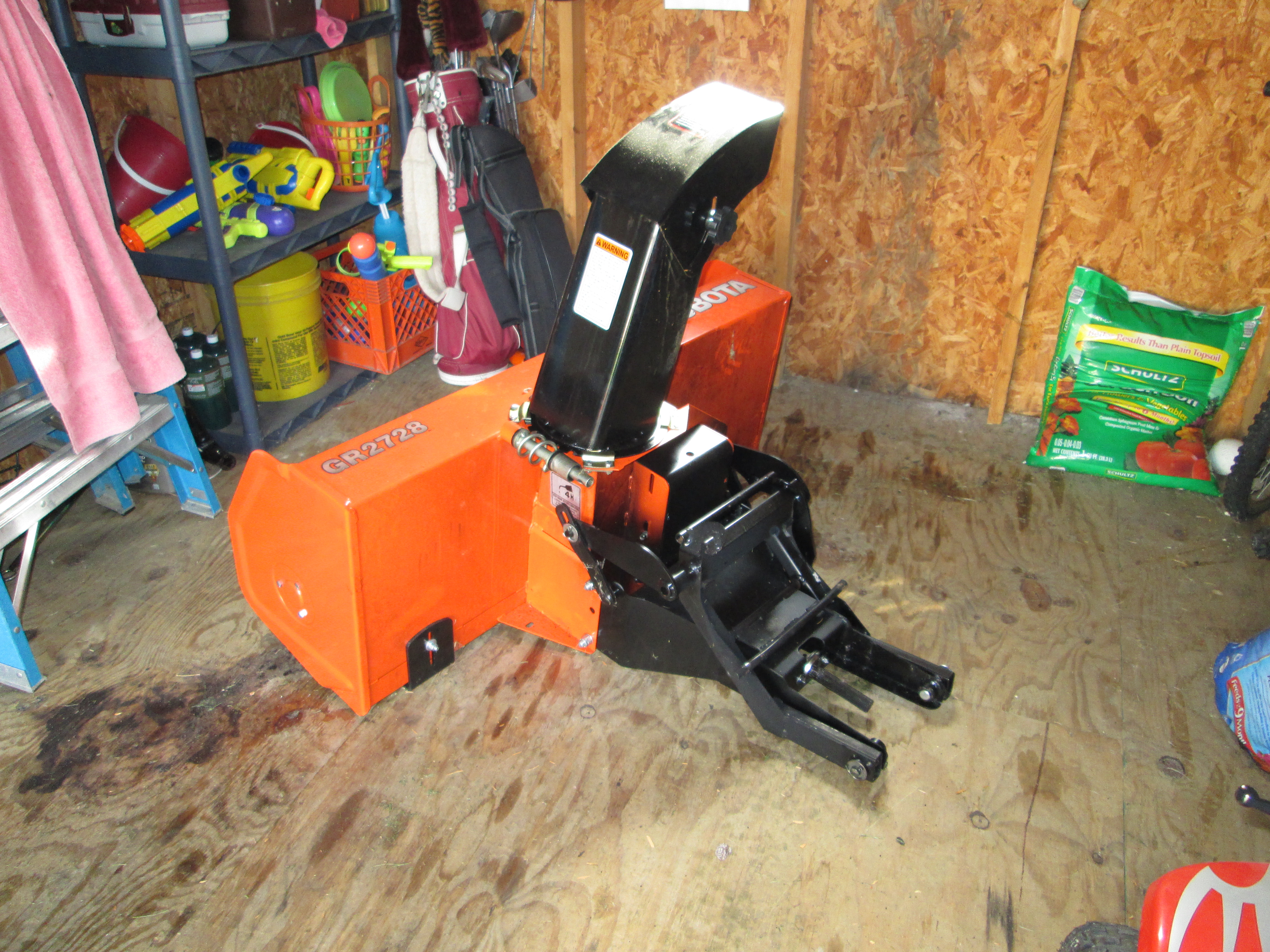

Here is what it looks like off mower, excluding drive shaft to rear axle. Philip.

GR2846 A B or C would work with the GR2707 subframe! Don't forget the exhaust deflector if buying one!
