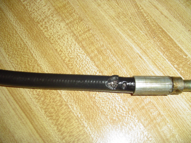

This may not be a a problem on the diesel,but a design flaw on the gas model.The protective sheath was not positioned down far enough on the hose to protect it from rubbing on the engine block when the front axle raises on the right hand side.Little bit of a bear to remove the line,but I think I can get it back on ok.
