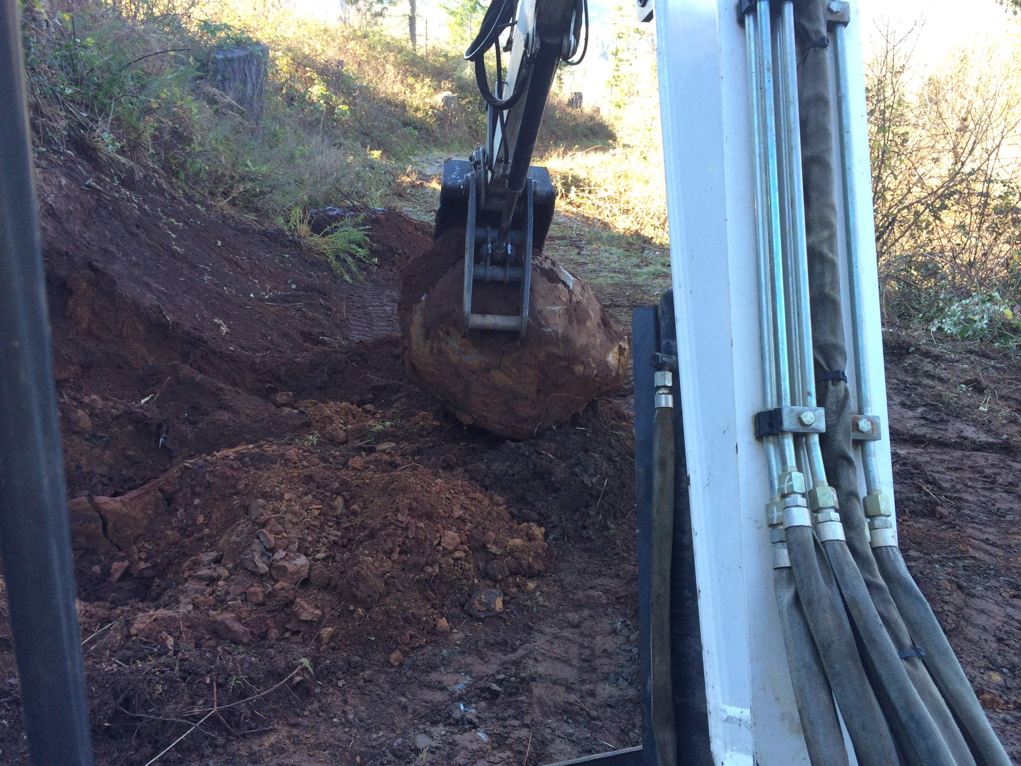

I've been looking at excavators to buy and have rented a couple to test. The Bobcat 337 was about as small as I'd want to go. It is 48hp with a GPM of 47. Found a Komatsu 75uu2 which is what I am looking for (16-22000 lbs with steel tracks) and it is 68 hp but only has 44 GPM.
My question is would the Komatsu have stronger hydraulics with the higher hp even though the GPM is lower, the Bobcat struggled picking up some of the rocks I need to move with a 47GPM. I would think that the higher GPM the better hydraulics regardless of HP.
I've heard that Bobcat has some of the best lifting capabilities of mini's, even though I'm looking for a 20K lb machine

Interesting, So it would be reasonable to believe that the Komatsu would be stronger as it is a higher class machine and more HP so it should have a pump that produces more pressure. It would be the same swing speed, arm and bucket speed etc.
Thanks for the quick reply, for the condition and price, it's not going to be around for long.
Bobcat - 48 hp @ 2500rpm 47 GPM
Komatsu - 68 hp @ 2300rpm 44 GPM

Hi guys the Bobcat is 49HP@20GPM@3750PSI with a pressure compensated/load sense/torque limited piston pump ,they also have a 20GPM@3000PSI auxiliary system off the main pump. 4 inch boom cylinder/3.5 inch arm cylinder
the Komatsu is running 68HP one pump 44GPM @3840PSI is a variable piston for the boom/arm/bucket and the second is a fixed 15 GPM @3000psi displacement pump for the swing and blade
