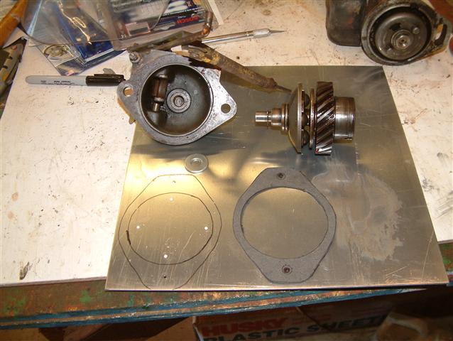

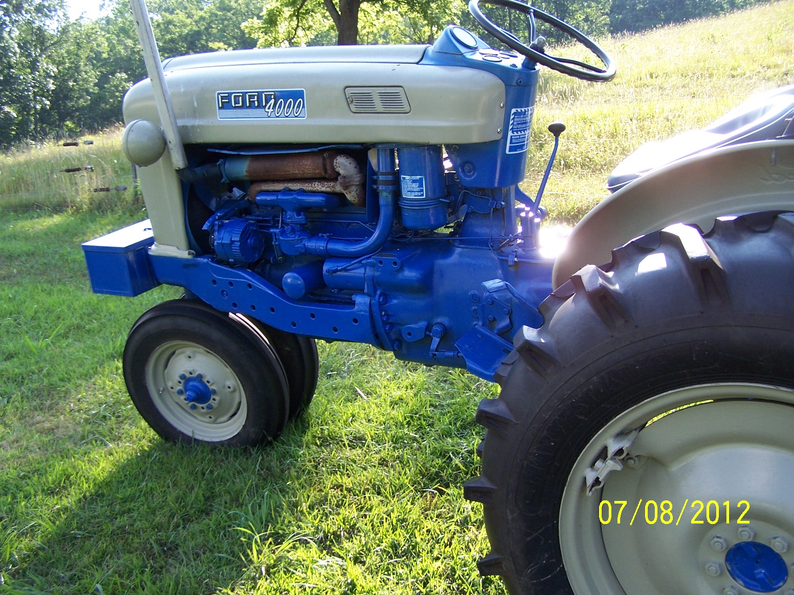

i have a nice ford 4000 trisycle front, 4 cylinder gas. the governers don't seem to work right. where on the internet can i find out whats inside one and howhard is it to rebuild?

heres a pic of it.

Hey, that's one nicely restored Ford.

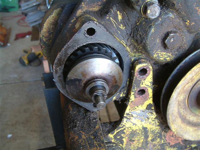

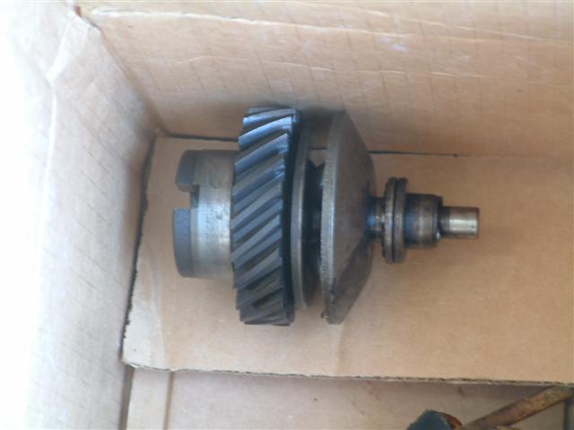

As far as your question on the governor, I don't know anything about the one on your tractor, but here're a couple of photos of the governor on my 1951 Minneapolis Moline BF tractor.
There's not much to it. It's driven off the timing gear on the cam shaft. There are 4 steel balls (weights) that move radially outward as the engine speed increases. This causes a linear motion along the shaft of the governor that's resisted by the spring on the linkage to the carburetor throttle.
I think this style governor is used on the Ford 8N.

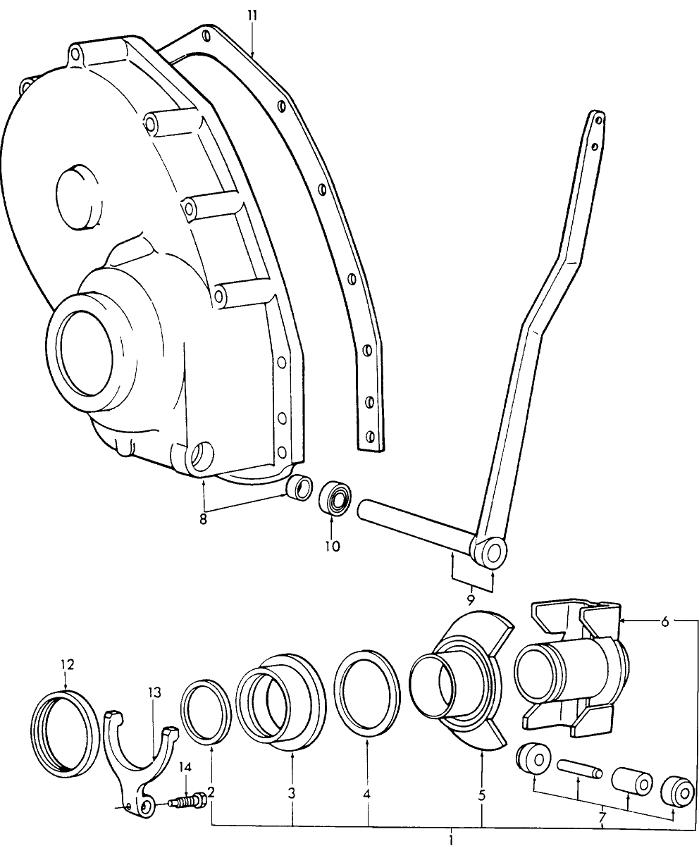

yer service manual and parts manual has an explosed diagram of hte governor.
alternately, the new holland online parts site does as well.

found what i was looking for at the new holland parts site. looks like a simple design, but hard to get to. think i'll try to adjust it a lil bit a see what happens.
