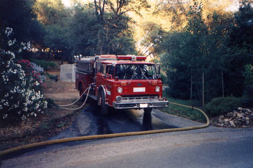

Yes. See attached photo.
A good extinguisher is good to have. A friend was field mowing three years ago, and started a fire. He noticed a strange smell, looked back, and was able to use the loader to scoop some stuff on it. It only too a minute for it to happen.
RobertN in Shingle Springs Calif

PS...
It's never to early to think about this either. Yesterday, we had a 5 acre wildland fire. It was slow moving, but had potential to grow.
We still have wet conditions; two engines sunk to thier frames in the field trying to do a pump and roll operation.
Fortunately, our engine(posted above, on another fire) is a little more nimble /w3tcompact/icons/smile.gif
