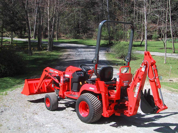

Took delivery on my BX22 on Saturday. Haven't had a chance to start using it but as someone new to the tractor world, I'm studying the books very carefully before embarking on any adventures.
She's a fine looking machine and very orange - my favorite color.
I must say the manuals leave a little to be desired, especially the sections on attachment and removal of the FEL and backhoe. I really think Kubota should include a training video as an addition to the documentation. Nonetheless, I'm taking it slowly - don't want to cause any damage to the tractor or the operator.
Picture is attached.

Here's a picture to help overcome your purchasing inertia!
