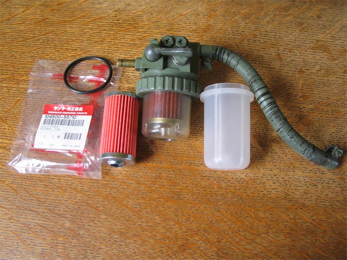

When I bought my YM240 it had a lawnmower fuel filter where the proper filter assembly should have been.
I went to a VN 'Rebuilt' import house and bought the proper used filter assembly, taken off one of their warranty return tractors parked out back. Then I discovered this included a bowl and element that Yanmar had never used - a Frankensteinmar! No wonder that tractor soon became a warranty return.
In this photo the filter assembly, and the brand-new bowl and element, are what I got and what should be on your YM186D. This was used on most Yanmars in that era. (Ignore the shorty old bowl and element).
img_3186rfuelfilter2-jpg.61786
Yanmar's bleed instructions are to open each bleeder screw in turn until pure fuel comes out, then close it and move on to the next:
1) Filter inlet, the screw on the top left in this photo.
2) Filter outlet, top right.
3) Inlet at injector pump. (If you have to, that's near inaccessible on my YM186).
There's no shutoff or filter at the fuel tank. The handle shown here is what you close to change the filter element.
