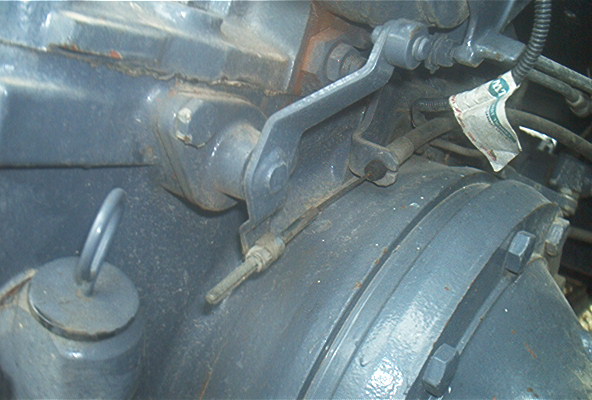

I would like to thank you guys for be a wonderful resource in my tractor dealings. I have been using a 2 bottom plow a lot recently and its running great. My fuel gauge seems stuck and Full but that's nothing. One thing you guys might have some insight about is when I lift the plow everything is fine but it takes forever to lower. Any ideas? Either way, so far so good with 7 hours on it!

Congrats on the new tractor! My TN 65 was so slow when I first got it that I had to send it back to the dealer the first day because it stuck all the way up! /forums/images/graemlins/tongue.gif The way to fix it is to adjust the cable for the Lift- O- Matic. I just tightened mine up until it the lift dropped like I wanted it to. TNs have a mixed reputation among box scraper users due to the slow lift action but after tweeking the adjustment I find it works fine.

As bgott says, try taking up on the L-O-M cable first; a 10mm deep socket will do. The cable shouldn't be able to turn in the lever. Also, three piont drop rate is separately adjustable at the hitch valve.

<font color="blue">Also, three piont drop rate is separately adjustable at the hitch valve. </font>
I have a TN 75 with 52 hrs. The drop rate is my only complaint so far. Where is the hitch valve and how do I adjust the drop rate from there?
