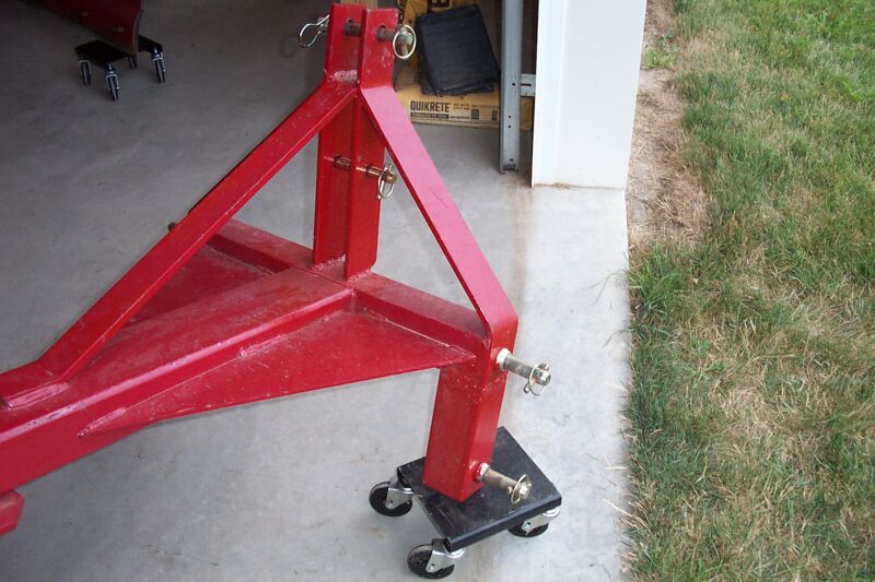

<font color="red">Here's a question though....when I raise my 3PH to the full up position, the blade is only about 3 inches off the ground when on flat & level pavement. Is this common, or do my link bars need to be adjusted somehow?</font> /forums/images/graemlins/confused.gif

"Here's a question though....when I raise my 3PH to the full up position, the blade is only about 3 inches off the ground when on flat & level pavement. Is this common, or do my link bars need to be adjusted somehow?"
You can shorten your top link some. That will pivot the lower edge of the blade about the lower links. It's also going to depend how tall the mold board is.
I don't know if height is something one can adjust on a KK blade (mine doesn't, but it's not a KK blade either). Does your manual address this at all? There have been posts on TBN discussing moving the lower link attach pins on implements (thus raising the lift height of the blade), but I cannot recall if blades were specifically discussed.

Dave, I added some lower attachment points to my blade for a smaller tractor I used to own. It allowed me to get the lift I needed but prevented me from turning the blade in the reverse direction. I welded on some angle iron extensions with some holes drilled in them and painted it the same color as the rest of the unit. See attachment.

Oh ya, also added some steel and drilled a hole for the new top link attachment point.

Sounds like you need to adjust your top link length. I got a lot more clearance than that on my 990 in transport... probably a good foot.

I also have a JD 855 and recently bought a Woods 6' rear blade. It has side to side tilt, and with 15 degrees of tilt, the corner is almost dragging. I too would like to be able to raise the blade higher. If I adjust the top link, it just changes the angle that the blade bites the ground. Let me know if you find a solution. It seems that the lower links on the 3PH need to be shortened!

Actually, I shortened the top link about 1 1/2" and it raised the blade as I expected. Where is the actual blade relevant to the lower 3PH ball joints? I don't know the configuration of the Woods blades, but on the KK, the blade is about 2 feet behind the mounting points. When you shorten the top link, the whole assembly pivots upwards. I think that you are not likely to get much better with that much tilt. A 6' blade at 15 deg tilt will have one corner on the ground, and the other 18.6" high. That seems like a pretty good height to me.
