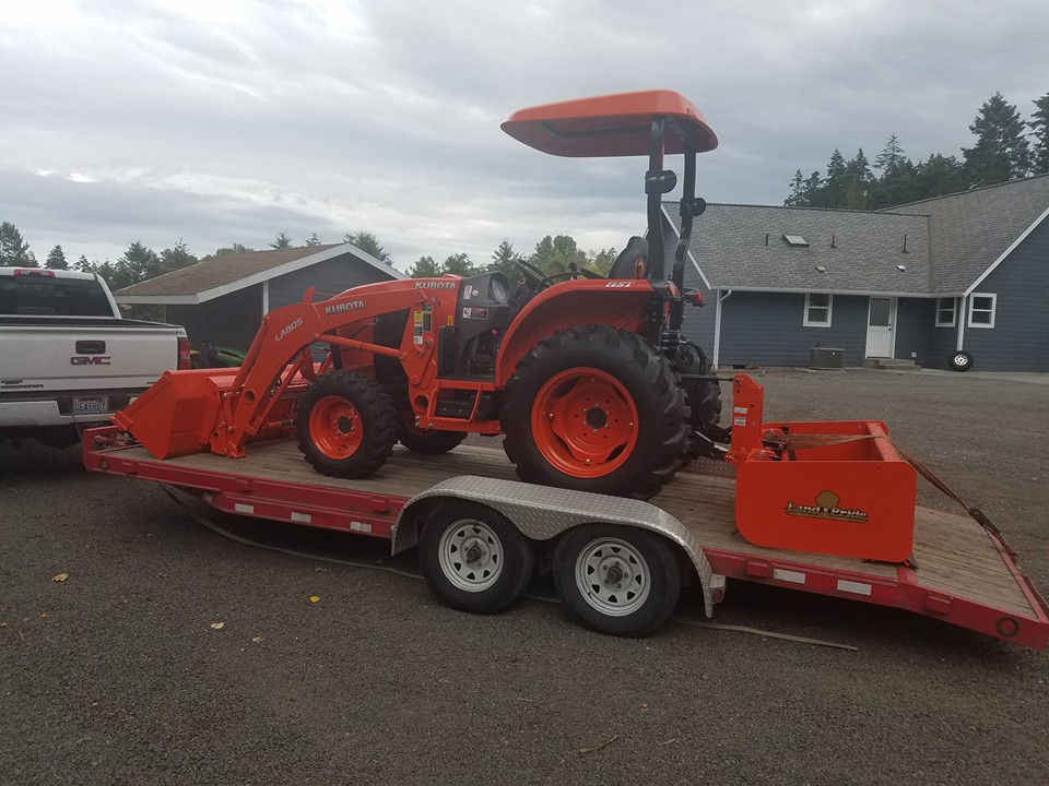

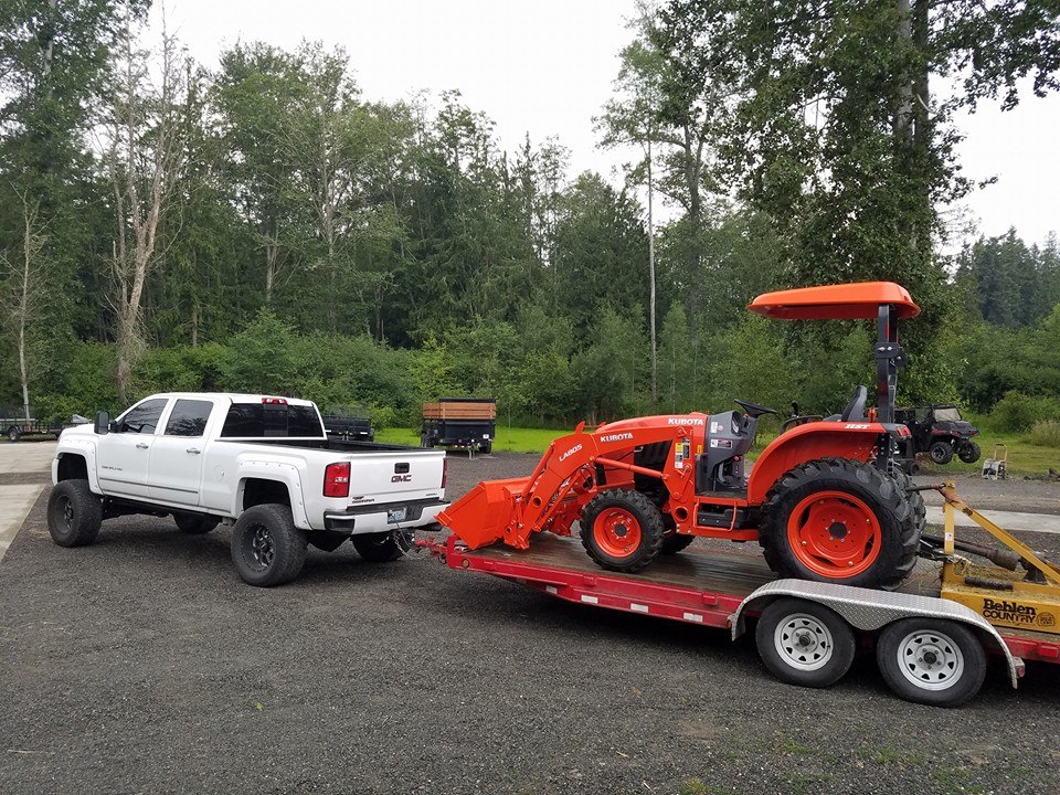

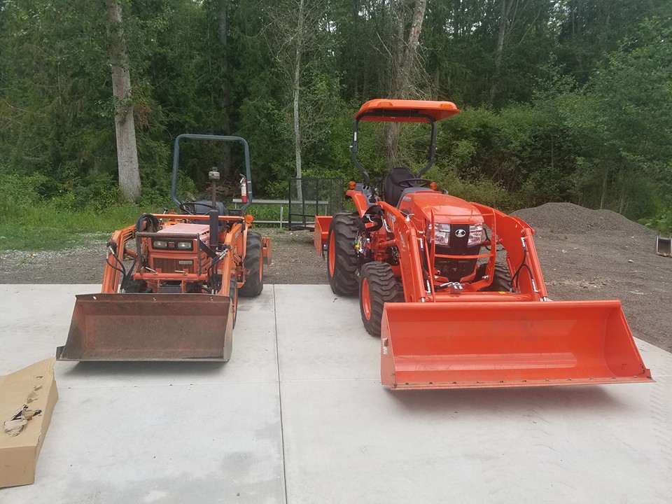

Well i got my New tractor today, L3650 and I'm super happy with it so far. Got about 3 hours on it today mowing and moving some dirt around my 10 acres
1st question, is the stall guard always on? i couldn't figure out how to get it off the dash
Here are the specs on the machine
L3560 ( Duh)
3 rear remotes. 2 double acting, 1 float detent
3rd function loader valve (just incase)
Sunshade
Top and Tilt
Land Pride HR2560 with Hydraulic rippers
LA805 4060 Loader package
HD Round back Bucket with cutting edge 72"
R4 tires
with tax about 33k out the door
Did some mowing today, it was great. Tons of power comported to my 1990 B9200HST that I'm selling now
Had to wear a helmet and jacket as the birds were trying to kill me when i was mowing the pasture, carried a PVC club to swat at them as well. Super annoying, but got the job done. Had birds actually hit the helmet 2 times mowing the pasture
here are some pics, Enjoy
Also my new Load trail TL-14 low pro trailer

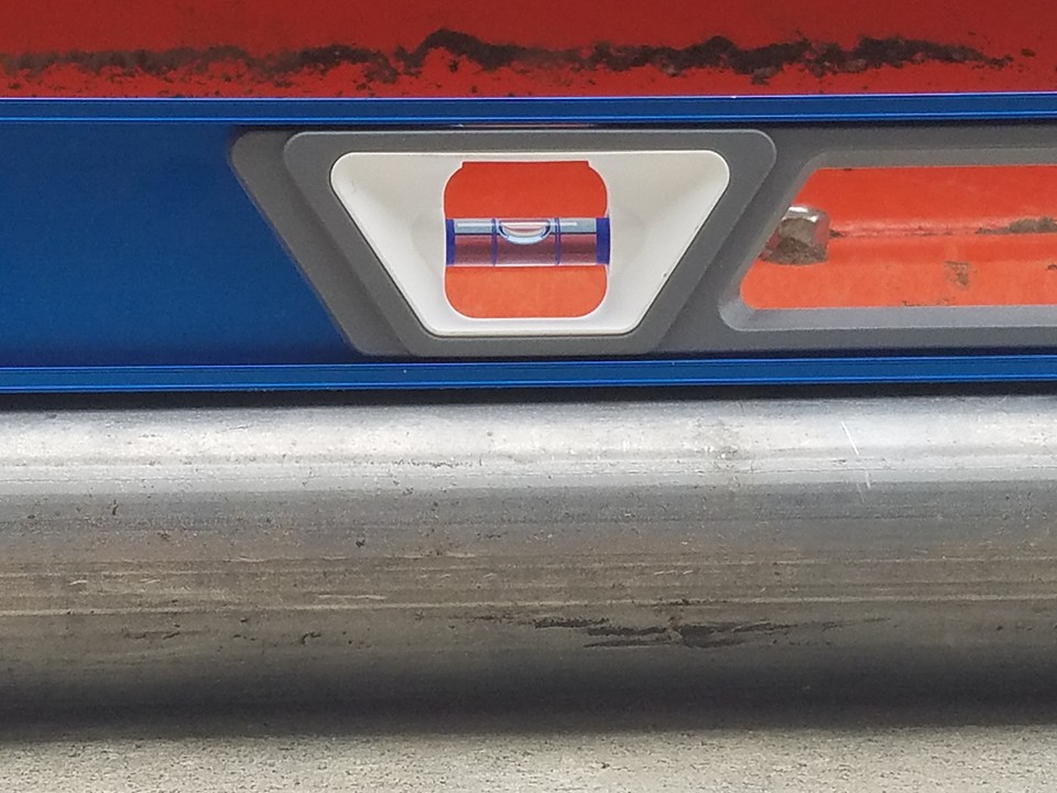

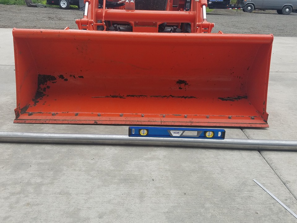

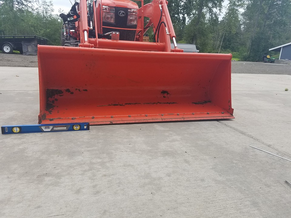

Front loader isn't level? am i being to picky or should this sit level. It will sit level if you drop the bucket all the way but on the way down its about 1 1/4" off. The right side touchs the ground way before the left side
Things I've checked.
Tires pressure are even, fronts both at 40 rears both at 20psi
Ground it level used a 2 ft level over a 7 ft stick
tractor it self its the same height off the ground.
Its in the loader somewhere. Are the rams adjustable? theres about 3\8" difference in the ram shaft thats exposed, from the left to right side ram?
Here are some pics for you, maybe I'm just OCD but it should be much more level then this for a new tractor
   / Got my new L3560 today from the dealer after waiting a month! #10
Yes, the bucket should be level.
Start a "punch list" of defects for the dealer to correct during the fifty hour service. Most new tractors have minor issues during the first 100 engine hours. Often the wheel nuts loosen during the first fifty hours.
